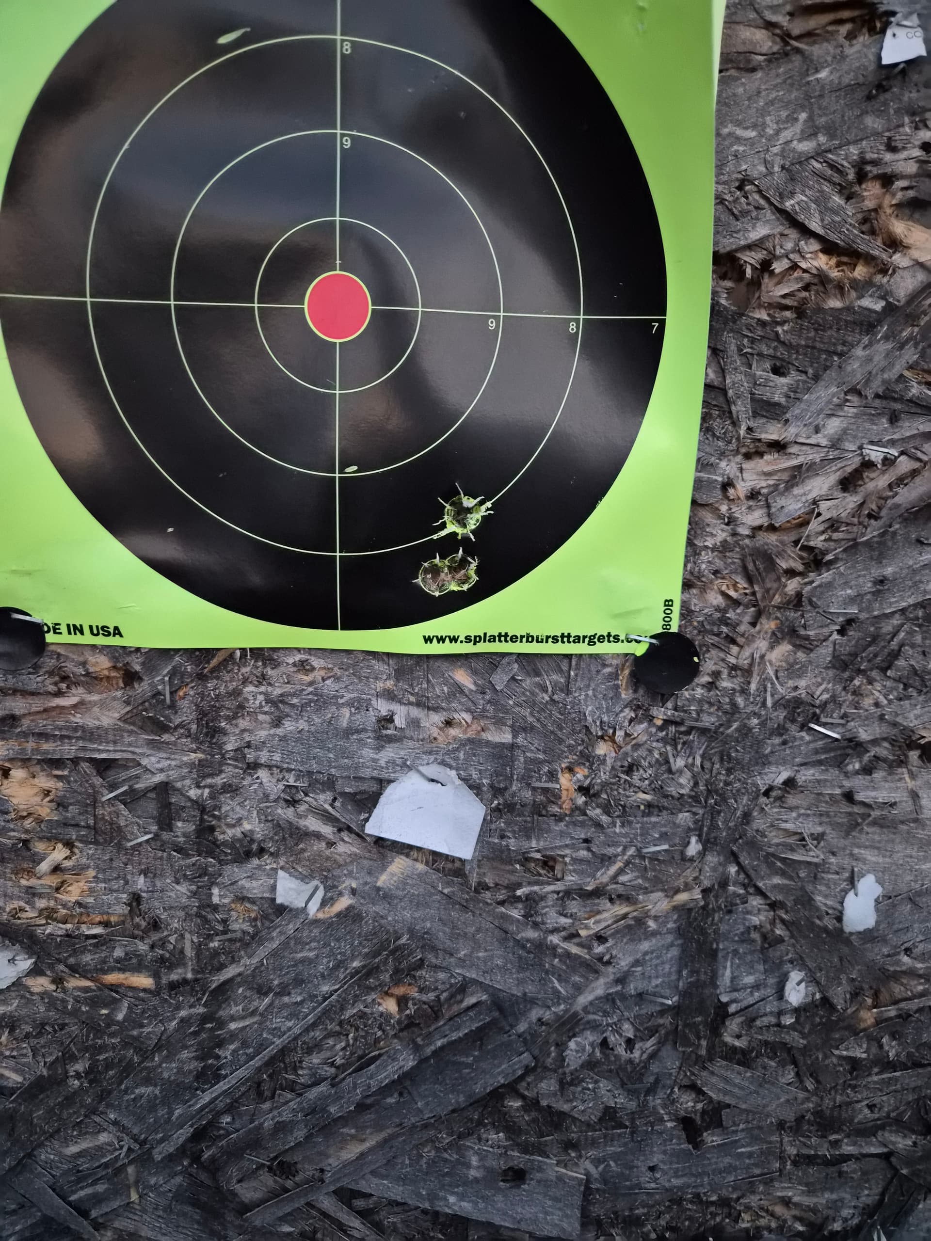

At the range this evening I was just trying to make sure I had a good feel for my rifle with the deer season approaching. I shot a shot at 100 yards and was on level with bullseye but about .75” or so to the right. Because I’ve shot this gun a fair bit this summer I just dialed it 0.2 mil to the left. I shot again and the next shot was about an inch lower and about 1/2 an inch further to the right (I had just adjusted it to go left). Obviously not enough shooting to really draw any conclusions and i figured I would just count it as a clean bore first shot.
I used an app to calculate the elevation adjustment for 200 yards and shot it 3 times without any further adjustments. The app said to adjust 0.6 mill for 200, but my three shots were 3.5” low and still about 1.5” to the right. Since I was running out of daylight, I thought I would adjust the scope according to those shots and give it one more. For 3.5” I dialed 0.5 mils and for the 1.5” I dialed 0.2 mils (remember, this is at 200 yards). I took the last shot and it was 3” high and still 1.5” to the right. I have to say that’s pretty frustrating…the 3 shots I took without any scope adjustments at 200 yards were maybe an inch apart. Seems like the cross hairs are not moving. Advice? In the picture you can see the 3 shots at 200 yards.
I guess my biggest question, having not used the dials on scopes all that much in the past, does it sound like a scope issue? It’s almost like the second time I adjusted the elevation it finally moved…and moved the whole 1.1 mil I dialed total. It also seems like the horizontal adjustment isn’t moving.

Woah… this is crazy. If what you’re saying is correct, then the scope was dialed but didn’t adjust.
I have only had this happen to me once. And what scope was it? An Athlon 6-24! Same scope as you. I generally consider Athlon stuff to be quite good but that’s a problem.
I would shoot with it dialed for 400 yards and hit, then dial for 600 and it would still be shooting for 400. We’d mess with the turret a bit going up and down and it’d snap back into place and work.
So it sounds like a scope issue, but will they honor the warranty? My guess is it won’t repeat this issue if I send it to them (at least that’s how it is when I take my car in for repair…it never does the same thing for the mechanic!).
I only saw it happen once with mine. We saw it once and then it never showed the issue again.
