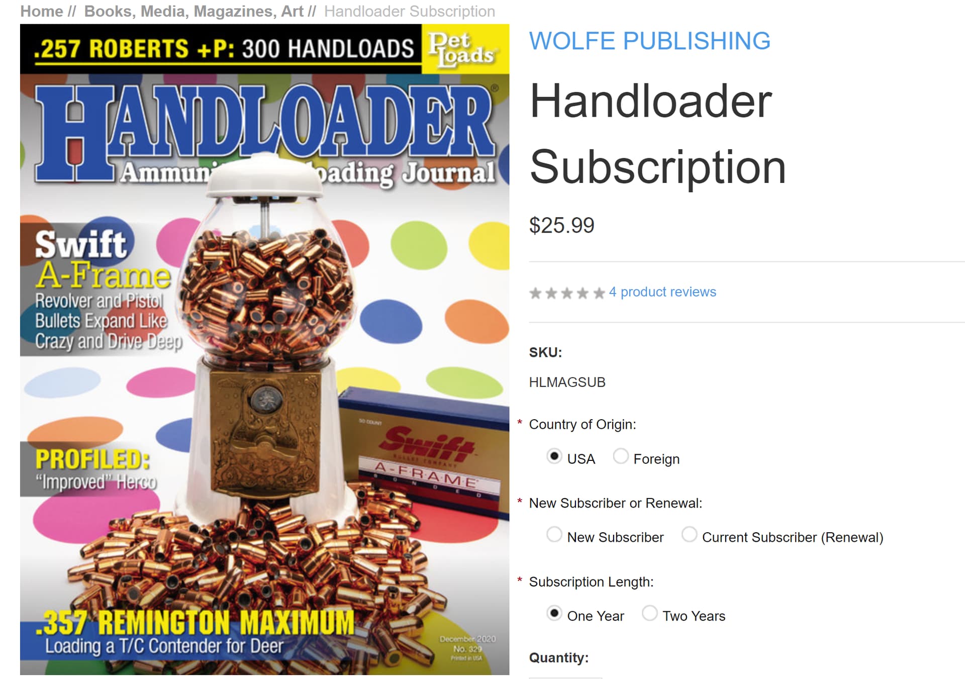

I use the data from the Handloader Magazine. Hornady data makes sense also as they are flooding the market with new cartridges with data updates. The Nosler data you can just pull up on the internet I reference a lot to crosswalk data against other sources.

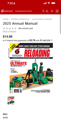

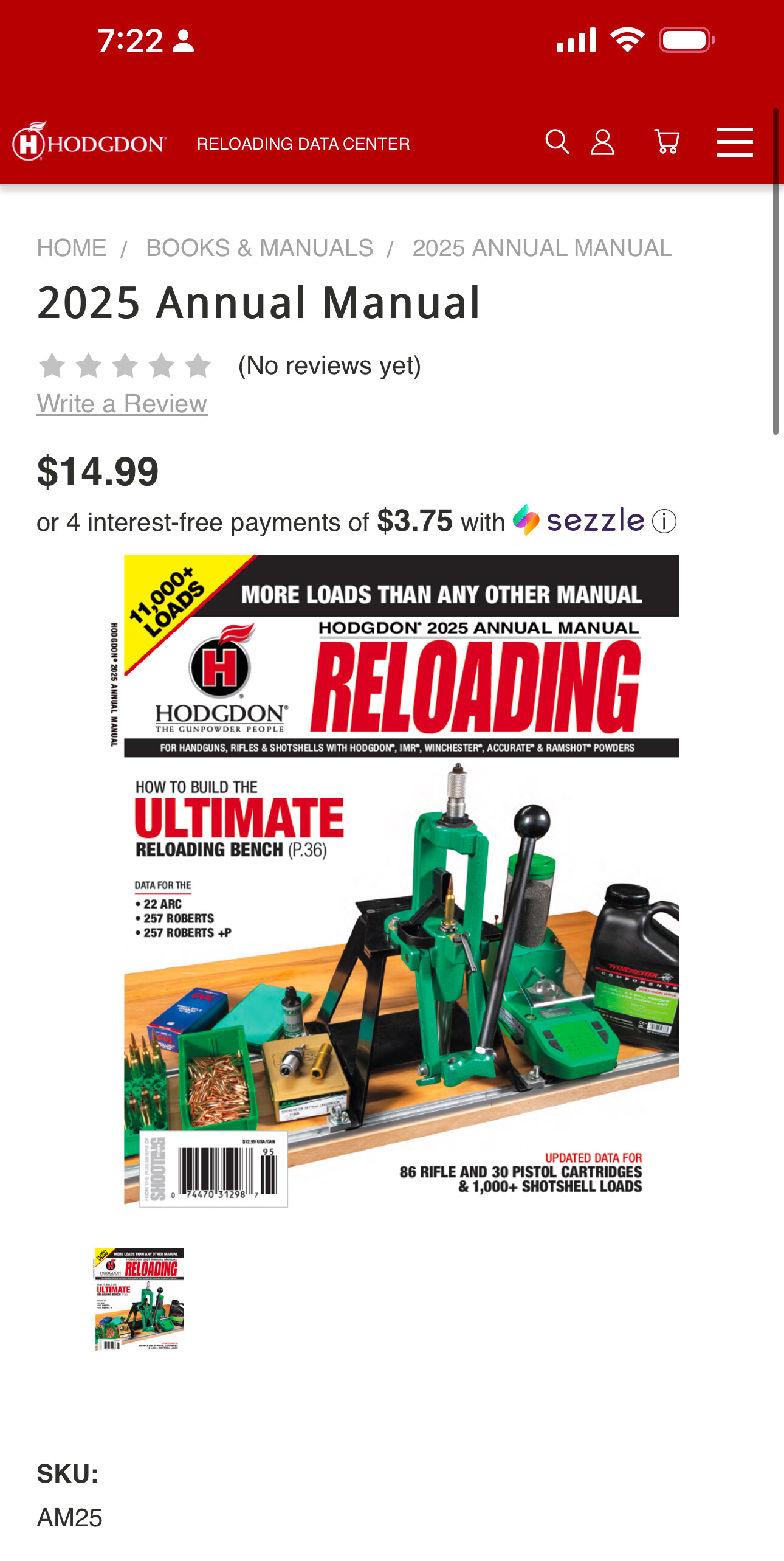

I assume this is the magazine? Is it a combination of load data and articles?
That is it. They have articles and load data in the back. The books folks are mentioning are more comprehensive, but just reading some of the articles has helped me over the years. I don’t buy one very often, generally what I do is when I see one on the shelf, I grab it, check the tables for the calibers I shoot, and look to see if any data has changed; if not, then back on the shelf it goes.

This is what I was referring to.
Yep, have the Hodgdon one also, like it as well as a reference.

One thing I like about the Hodgdon in this and it is marketing by them but it has a brief about each of their powders - all 79 of them. Kind of nice starting point if you are trying to find a powder for your cartridge. And there is a burn rate chart as well.
