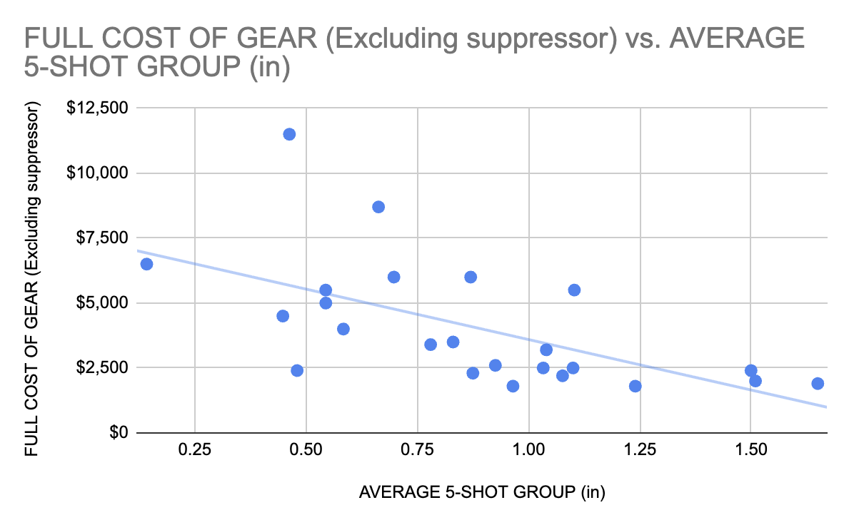

Thought I’d share this graph of the 25 competitors we’ve had shoot the Backfire Accuracy Challenge. There is a slight correlation forming between price of the system and accuracy of the precision rifle. At the same time, plenty of outliers.
Great Data.. So who’s sub $2500 and sub .5 MOA inquiring minds would like to know :man_facepalming::face_with_tongue:
Be interesting to see how rifles that cost $1k or less would show up on that graph.

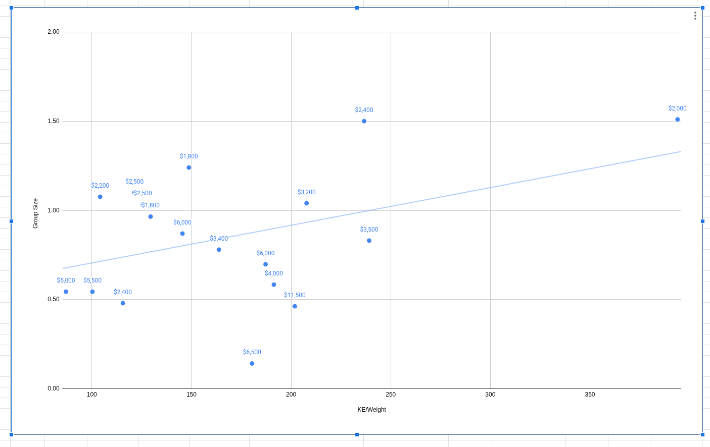

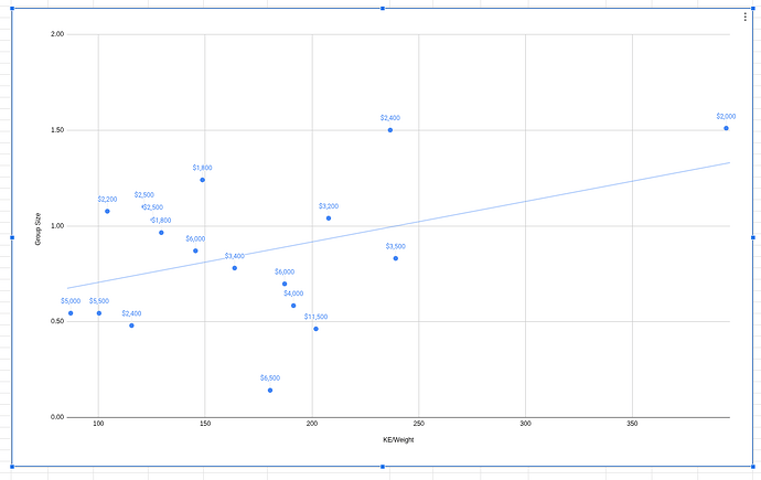

Should also normalize it for weight and kinetic energy to see if spending more money beats the average
@backfire It would be great if somehow you could publish a link to this data to your “members only” website, especially if it was interactive and you could click or hover over a dot to get the details about everything in the build, and the experience of the shooter, ammo choice (factory vs. reloaded) etc.

I’ll add a graph of it.

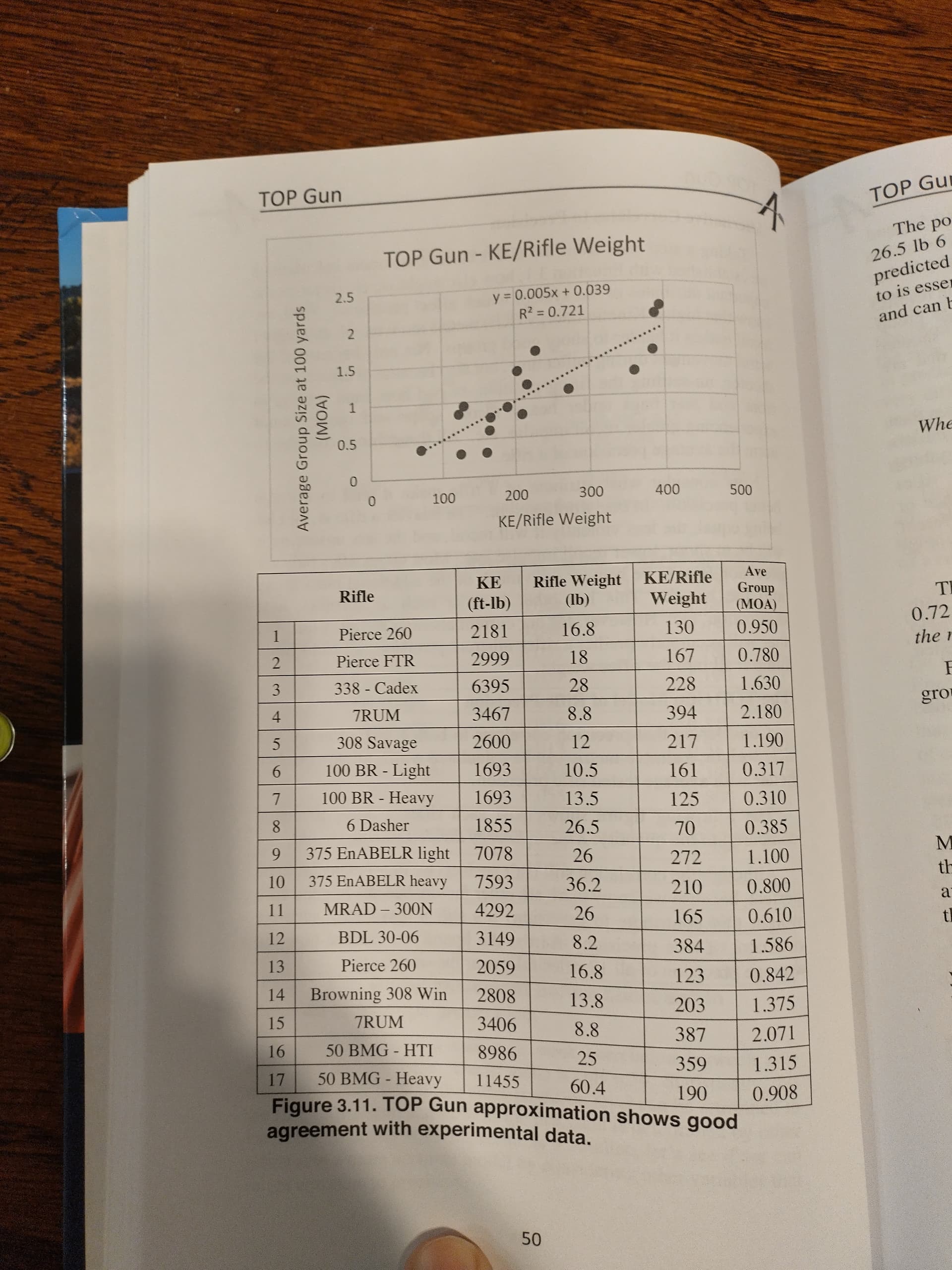

Yep, shoulda had people shoot a 5x5 but the trend line applies, and getting marginally better gear to beat the trend also seems to work to an extent. Litz’s data is a bit cleaner because they used the same group of shooters for all the rifles probably.
