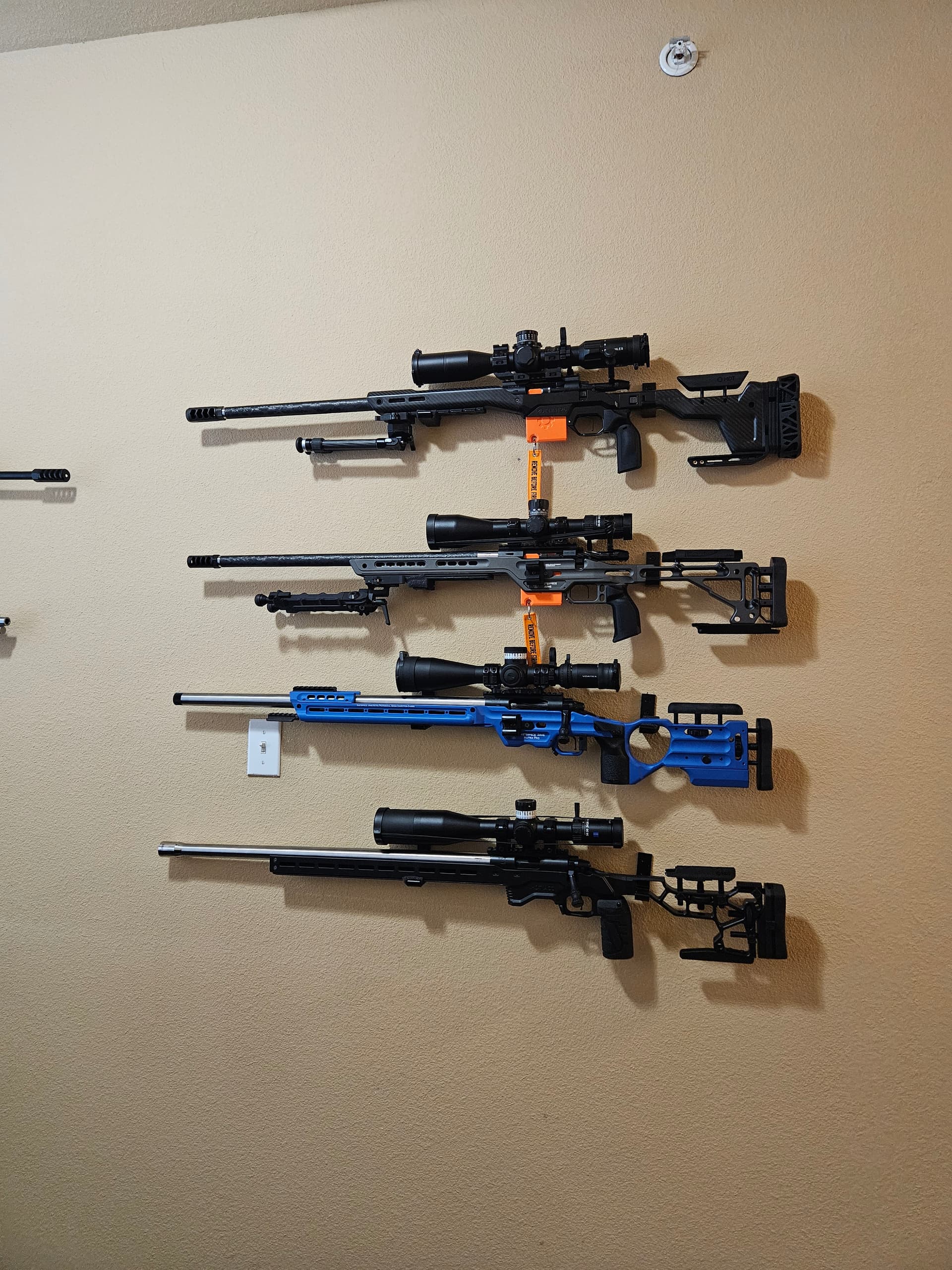

I really got into customs my wall of lefty love:

Looks great. Can you give us a rundown of what you’ve built?

Sure, the top to the bottom
1: hunting and NRL comp rig, zermatt TI titanium 3 action 20 moa rail. 3 barrels, 6.5 creed bartien steel mu24, 6.5 prc & 300 wsm proof research carbon, all 24”. Triger tech diamond trigger, MDT HNT26 chassis and KRG whiskey 3 pro chassis, area 419 1 piece rings and kahles 3x28 scope. Running a MDT break or meateater silencer. Gun can go from 10 lbs with scope and bipod for hunting to 14 lbs for NRL hunter competition
2: built for wife (also lefty) falkor 7even action 20 moa rail, proof 6.5 carbon barrel, trigger tec special trigger, mpa ba hybrid chassis MPA 1 piece rings and Zeiss LRP S3 6x36 mpa break gun is 13 lbs
3:prs rig, zermatt TL3 stainless action 20 moa rail, triger tec diamond trigger, proof research 6 mm creed steel 26” barrel l, ez tuner break or banish 30 silencer, mpa 1 piece rings, vortex razor gen3 6x36, mpa matrix pro chassis. Gun weigh 19lbs
4: 22 lr comp gun, rimx 22lr action 30moa rail, proof 22 26” barrel with ez tuner, mdt chassis, mpa 1 piece rings, Zeiss lrp s3 6x36 scope triger tec diamond trigger.
Running accutac bipods and a gunwerks double
