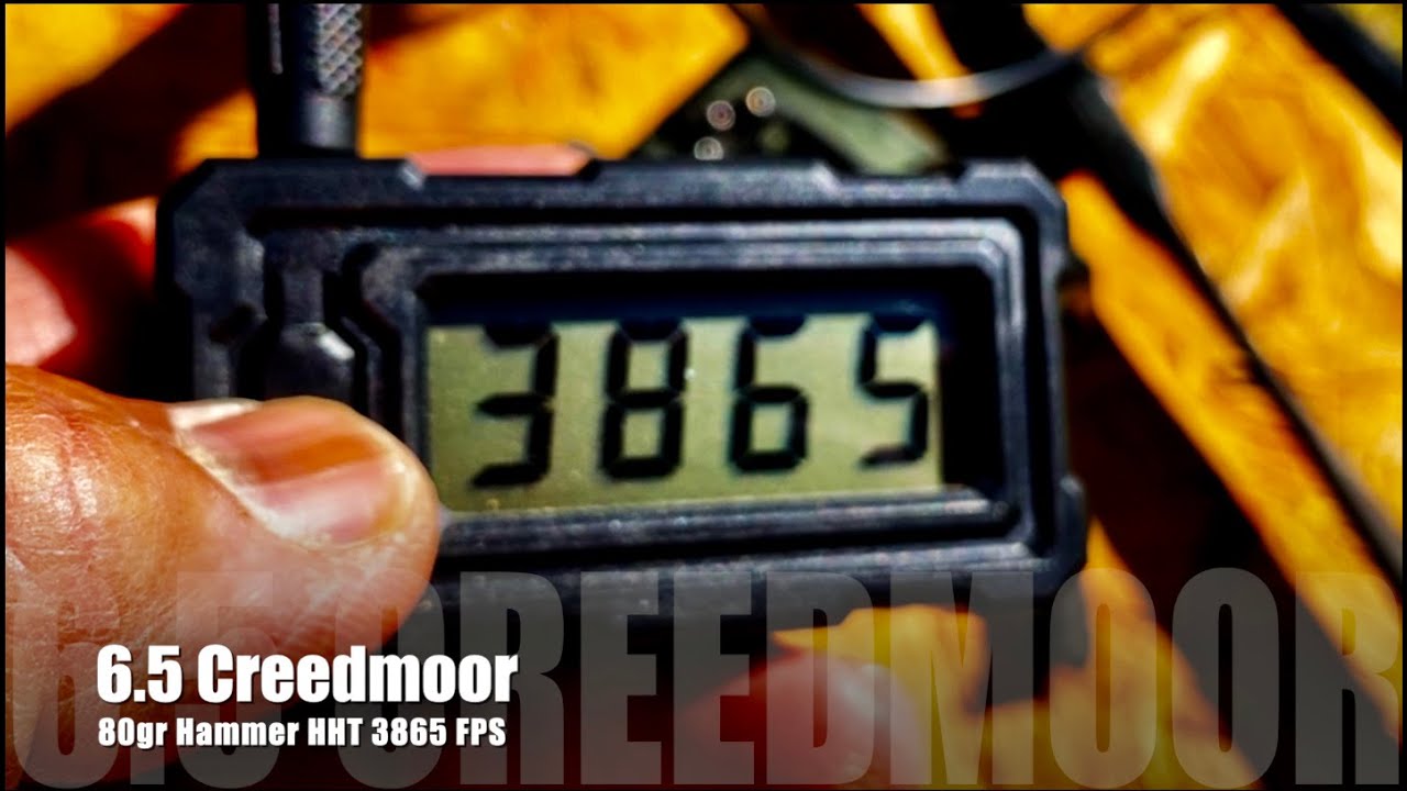

I have been researching and it looks like you can load up these babies to go almost 3900 FPS out of a 24" 6.5 CM. Please forgive my ignorance to reloading as I do not have much experience with it. To me it seems like this would be a great bullet/round to shoot out of a 6.5 CM for top performance. I would imagine even though it is only an 80gr bullet. It still would be going over 2000 FPS at over 600 yards. Seems like more than enough to take down a good size muley. Does anyone see a down side or negative to this plan for a 6.5 CM? Especially hunting Deer at longer ranges? 600-700 yards? It should not have any effect on the recoil of the rifle? Correct? Thoughts?
Woah. That’d be quite a wild load. According to the load data, a 90gr bullet is only going 3200 at max pressure. Given that the Hammer is a copper, even being 10gr lighter, I don’t think you could go any faster because copper bullets drive up more pressure.
So whoever is loading this bullet to 3900fps, I think they are going WAY WAY above safe pressure even if they don’t realize it.

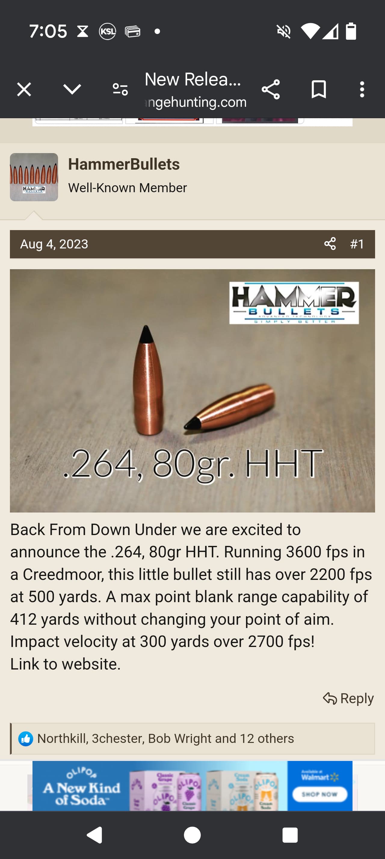

Not uncommon for Hammers, in my use they typically achieve very high velocities and pressure out further than most projectiles of similar weight.
