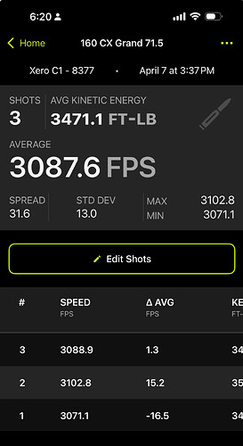

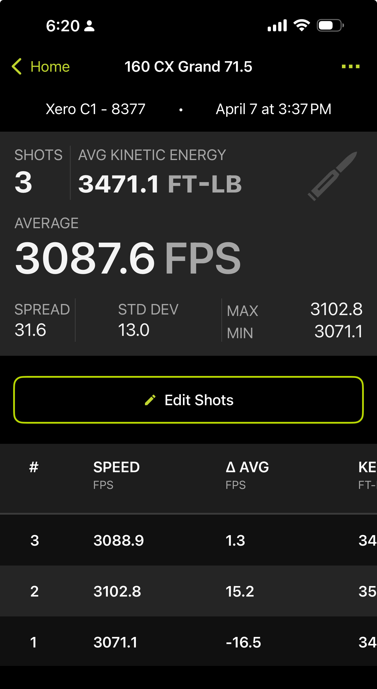

Ran some 160 CX with Grand. At max load pushing 3100 fps from my 22 in barrel. Only 3 shots at this charge but the lower charges were following along as well.

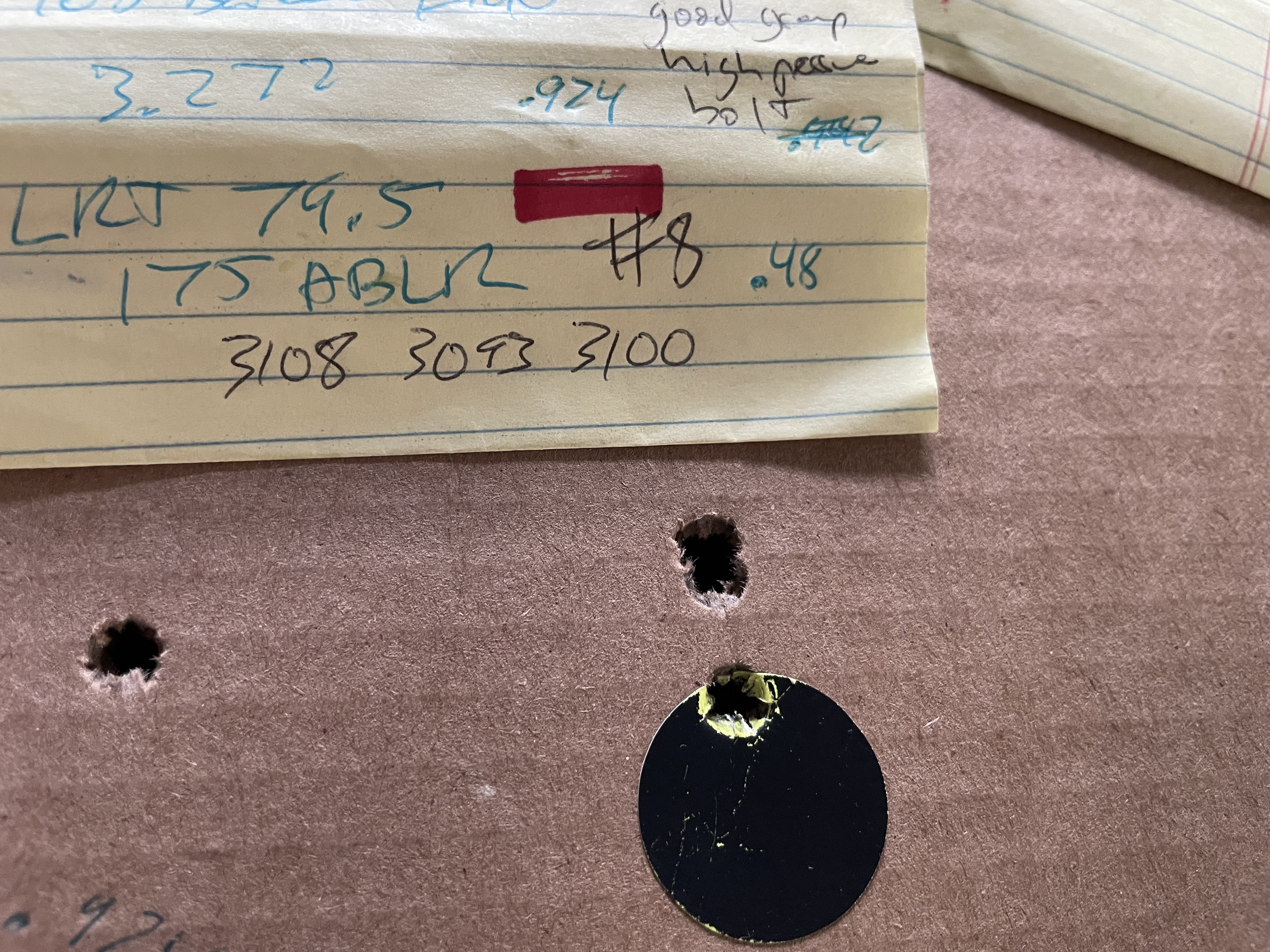

I’m new to Ramshot too with my new 7 PRC 24” Ruger AM GoWild. I tried out the LRT last weekend. Best group to date at .48.”I keep seeing the big YouTuber at Little Crow GW say that ball powder is no good. Got to go with extruded. Anyone have an opinion?
