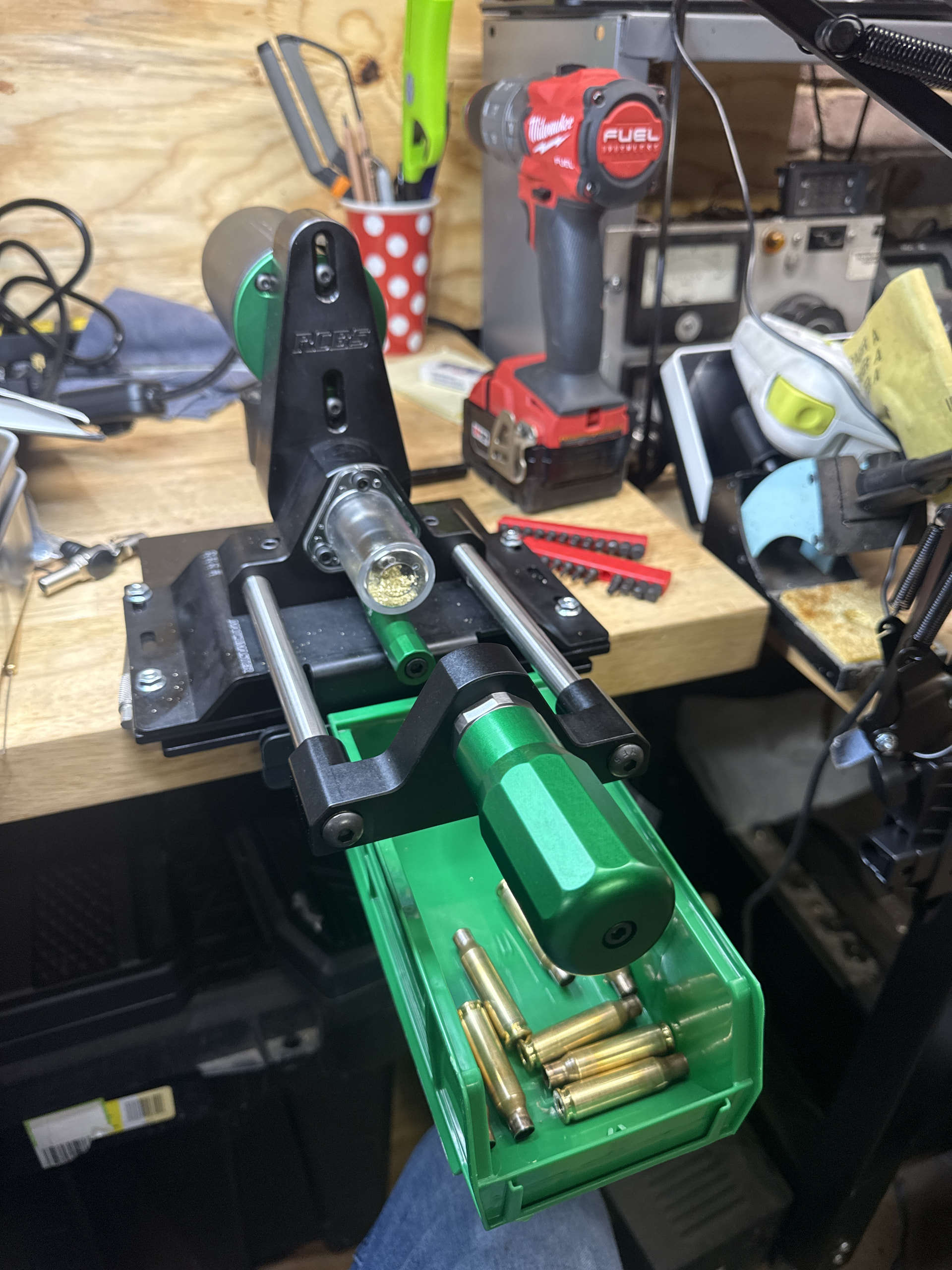

Gotta say this RCBS match master trimmer is unbelievable. It is spot on every single cut to half thousand really brilliant.
I need to step up my game. Hand turning is monotonous.
It was so easy to set up. No feel involved. every neck really exactly the same length within 1/2 thou. I did 200 pieces of brass in about 20 - 30 min with cleaning out the shroud from time to time. Makes fast work. Thats a guesstimate I didn’t time.
there 61 year old eyes needed the magnifier to adjust the cutting head and to resolve the caliper on It AND in the end I had a few pieces of brass from bump set up that are going t be used a s fouling brass. Used those to set up and fine tuned to my measurement buy just turnring the caliper slightly without looking… LOL but spot on to specs.
I fixed the one thing on mine they should’ve done from the factory. I put loctite on some allen screws and made them studs and screwed them in flush with plastic brass catcher then super glued 3 magnets on the back of plastic over the screw holes . That way when you need to dump brass trimmings or make adjustment you can pull brass catcher off instead of fooling around with the 3 little screws. Quick easy fix and a few bucks from the hardware store
love that idea yes suck to keep clearing It.. send that up the chain would be a great REV b fix. I think they dont do that as the blades are ultra dangerous when spinning keeps people from getting hurt but who’s to say.. Its a litigious world
