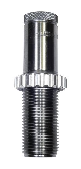

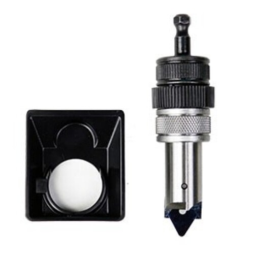

@backfire You recommend the FA case trim and prep center on the reloading list here - Best Reloading Kits for 2024: My results after 400 hours of testing – Backfire, after a bit of testing I found that the Lee solution is quite a bit faster and easier to work with as well as being a lot cheaper provided you already have a drill available. Having a dedicated die body makes it a lot more consistent than a plastic collet. The only downside is the brass dust it spreads across your press and loading area (the little shell holder attachment is hopeless).
