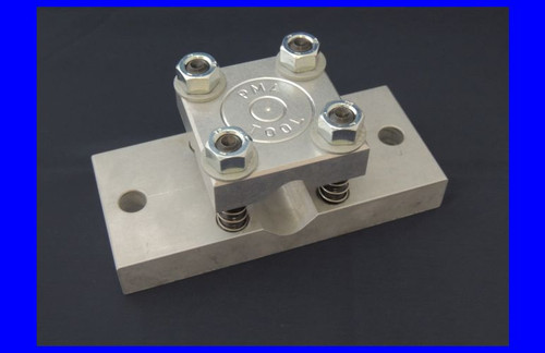

Jim, have you heard or seen any truth to the rumors of how difficult it is to take off the factory barrel on a Tikka? I’ve been looking at throwing a heavier contour barrel on mine but am not sure that I want to if it is going to be as difficult as everyone says it is (heating then cooling the action several times and then still having to exert 100ft-lbs into it for it to break loose).
I’ve taken two off. It’s difficult but not beyond what the man can accomplish in his garage.
These are the tools I used…
https://a.co/d/8QRd8uD
I used kroil and let it sit for a day or two. I reapplied the kroil every so often.
Then once I got the receiver wrench on I gave it a good whack with a two pound hammer and it loosened right up.
In fact, I think the last step is the most important. tikka must use some crazy adhesive on their receiver threads and it needs a good jolt to come loose.
The second one I took off I didn’t use kroil. I just whacked the receiver wrench handle with a two pound hammer and it came right off.
It may cause scuffing on the corner of the flats of the receiver but you could put some tape on it or something.
