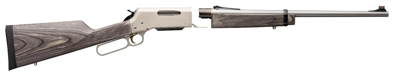

I like the idea of the browning BLR. It has some good cartridge options and if you’re going open sight why not go leveraction right?

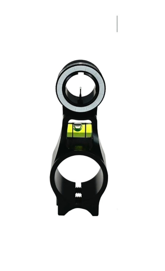

The search continues…but I’m a bit surprised Williams/Skinner/Lyman or some other company hasn’t come up with some universal front sight like the picture so you don’t have to mess with your barrel to install a front sight.
I did see another that would screw onto a threaded barrel, but they wanted over $1k for it.
Just crazy pricing when I can go buy a brand new rifle with iron sights for cheaper.
