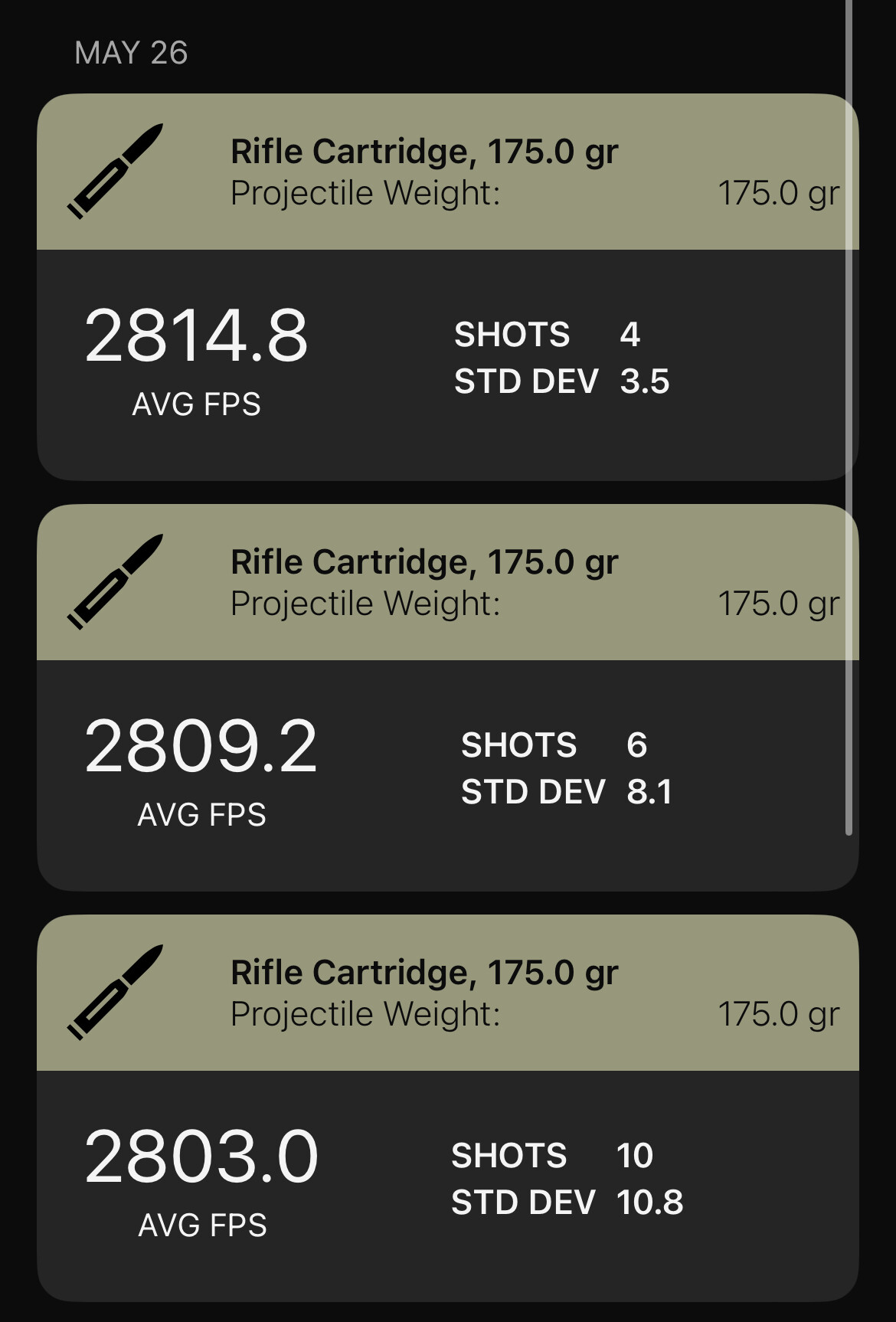

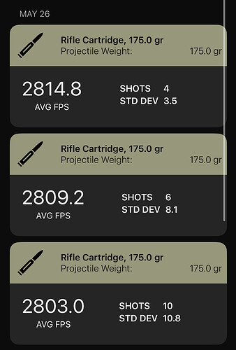

Just be aware that you won’t get that high of velocity. My first test loads of 7 PRC used 63.5 gr of the 4381SC and my best velocities were 2818 fps.

Fierce Mtn Reaper 20” barrel. Had zero shots by me when I started and now has 55 shots from me. Not sure how many shots from the manufacturer.
Federal No. 215 Large Magnum Rifle Primers
Hornady 175 gr ELD-X
Peterson Brass
Ambient temp was apx 86° when I started and 89° when I finished.
Highest velocities were the last string, which had the largest jump to the lands. The jump to lands seems crazy large to me in this rifle/caliber. My measurement of case to ojive with lands contact on my rifle is 2.8200. Case to ojive measurement of the factory Hornady ELDX Precision Hunter is 2.5940 and the ELD Match is 2.5565. I did 5 different loads with differing seating depths to span the range between the two factory loads.
Let me know if you want any more info.
