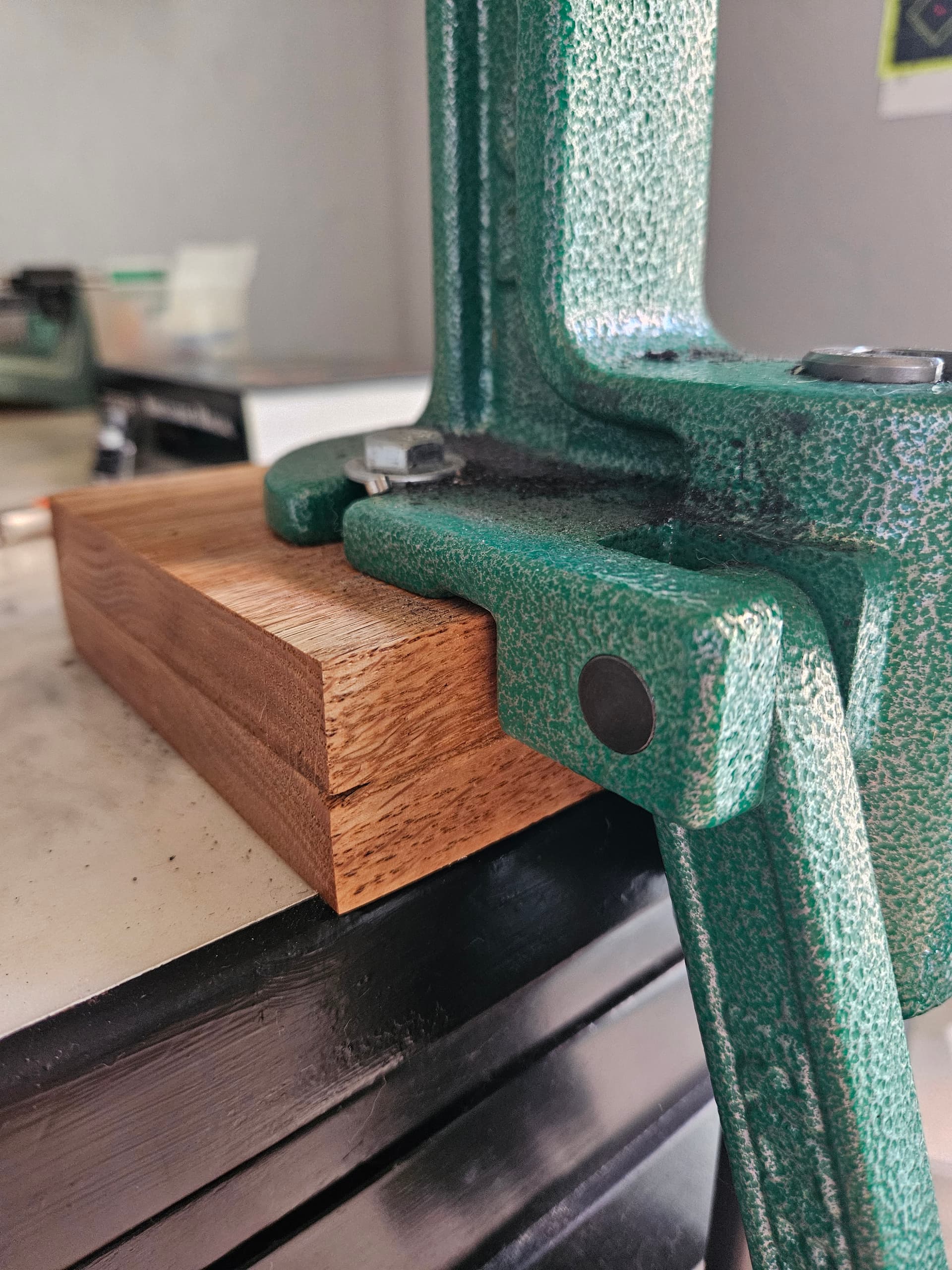

I didn’t really have a good spot when I got my press. I found an old office desk, pretty sturdy, that someone was giving away. It was in rough shape, but I refinished and put it into service as my loading bench. I discovered I needed a little more support for the press, so I did what Jim mentioned and layered some wood under it. Works great and is very stable.
