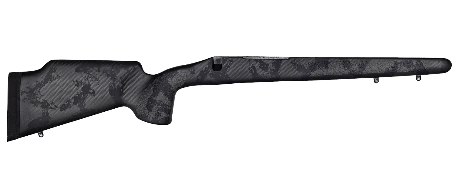

For what it is worth. The Tikka Altitude Carbon Fiber stock is on sale for 28% off.

Agreed with @TuSventyWins. But if you are looking for something to use this fall. I would highly recommend either the Pure Precision Tikka Altitude which is on a killer sale right now. Or the Iota EKO Tikka stock is Fantastic as well!
I did really like the Iota stock as well if you want something traditional. Also just got a Rokstok I’m testing out and liking a lot so far, but you generally have to watch for orders to open for them and would likely not be here in time for the hunting season.
