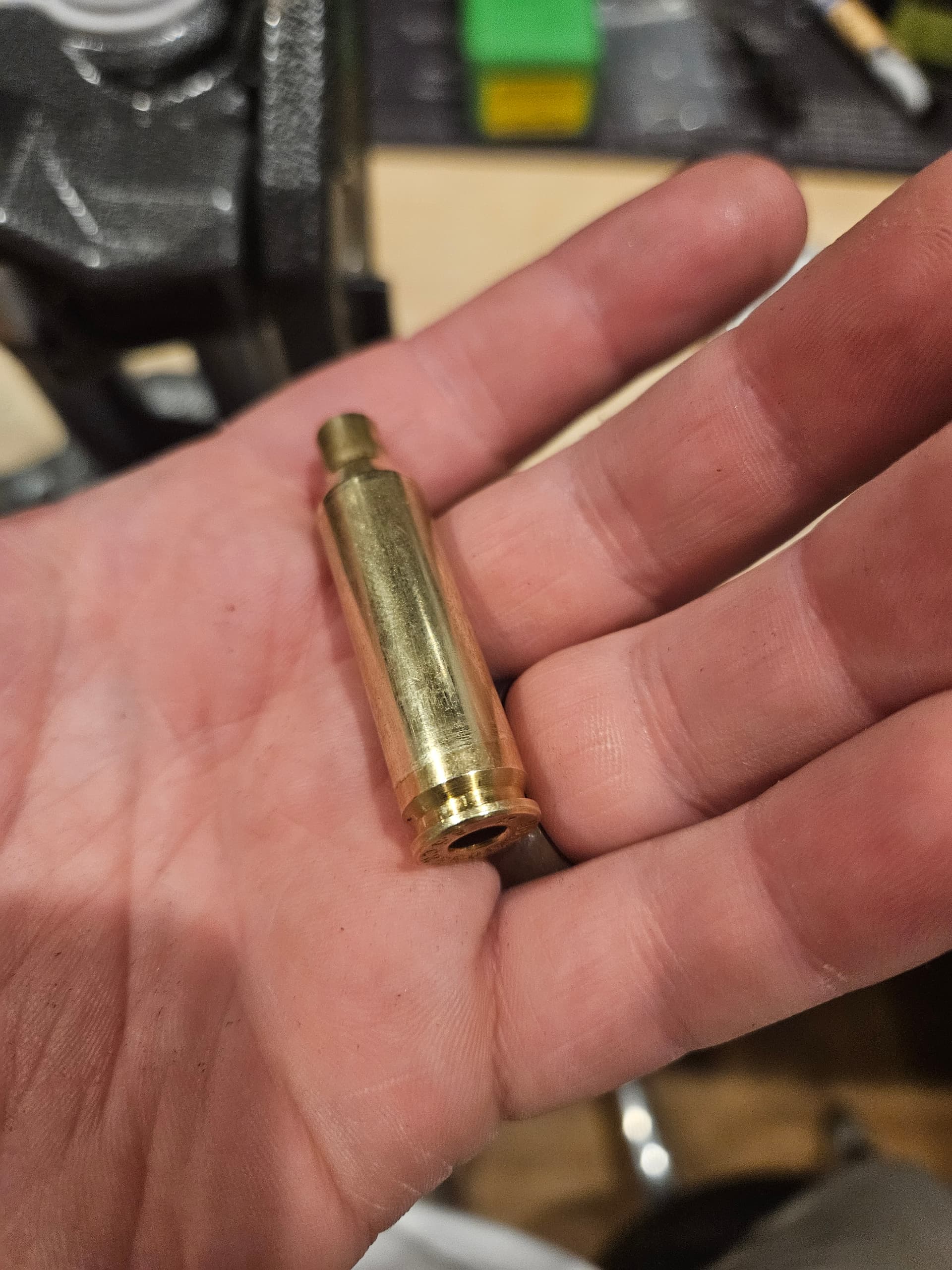

Hmm. I’m not quite sure what that would be. Maybe post a picture so we can check it out?
You can see where it’s dragging on the return stroke.

The marks on the case are not right, something is scratching the surface of the case. It should come out smooth.”

I reload 6.5cm with Redding dies as well. I also get that wear line towards the bottom of the case but I’ve never had one stick. One of my first thoughts was it could be a bad batch of brass or a factory defect. For clarification, what do you mean by sticking? Are the cases actually getting stuck in the die?
