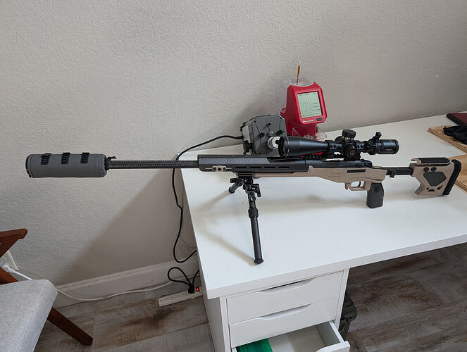

Thought it would be cool to get a thread going of our bing bangs in a Backlight.
This is my Bergara Crest Carbon 7PRC, 22" barrell weighing in at 10.5 lbs with a couple bullets on the chassis side. Timney 2 stage trigger, Athlon Ares BTR 4-20, Tricer RP bipod and a Backstrap covering a Bergara BTI30.

Flung 35 rounds down the 100 yard range in 7PRC in the Backlight. Here are my initial thoughts:
  1. Compared to the factory stock, it’s night and day and the original was a carbon fiber stock. So much less recoil and much less bounce off target. Compared to the chassis it was in (Ultradyne OG chassis) it is an upgrade but not as significant. The biggest gain is the weight, it’s a pound lighter. Also less bounce from the table, which kept me on target better. Still couldn’t spot impact but at 100 yards that would have been amazing.
  2. I could feel the screws against my face but they didn’t impact my shooting nor scrape against my face on recoil. I think the option to have them on the right side would be nice since I could care less about the stock’s magnet feature.
  3. The grip feels small (length not girth) compared to my previous and other chassis rifles. Didn’t impact my shooting but it caught my attention.
  4. Getting the chassis setup took a moment, but that is also in part because I forgot part of my normal shooting gear at home, so getting the feel right took longer than usual. For future reference, screws with a bit of a bevel would be great for the comb locking function so they start easier.
  5. The MDT mag goes in and out of the chassis so easily, and I could tell it made feeding so much better than what the magpul mags did in the ultradyne. I mean, just perfect.
Great job Jim and Backfire team. I pray this venture is highly successful for y’all.

Hey Ben! GREAT review! I’m gonna read that to the team on Monday.
Cool that you noticed less bounce of the rifle off the table—especially compared to your old chassis that was a POUND heavier and even still, bounced more.
A note about the toolless heads. I still haven’t had anyone say it bothered them but if it ever did, we could just get headless screws to have available for people. You’d loose the toolless adjustability but if you’re the only one who shoots it, it’s an option.
We’ve found that there is a LOT of user preference in grips. We heard too fat, too short, too long, too skinny, etc when we showed the SAME grip to lots of people :grin: Took us tons of iterations to come to this. Eventually we’d like to make two more grip shapes so people can get one to suit individual preferences, but so far this one has been the design that people most universally liked.
Anyway, fun to see these finally getting out in the wild. Thank you for posting!
