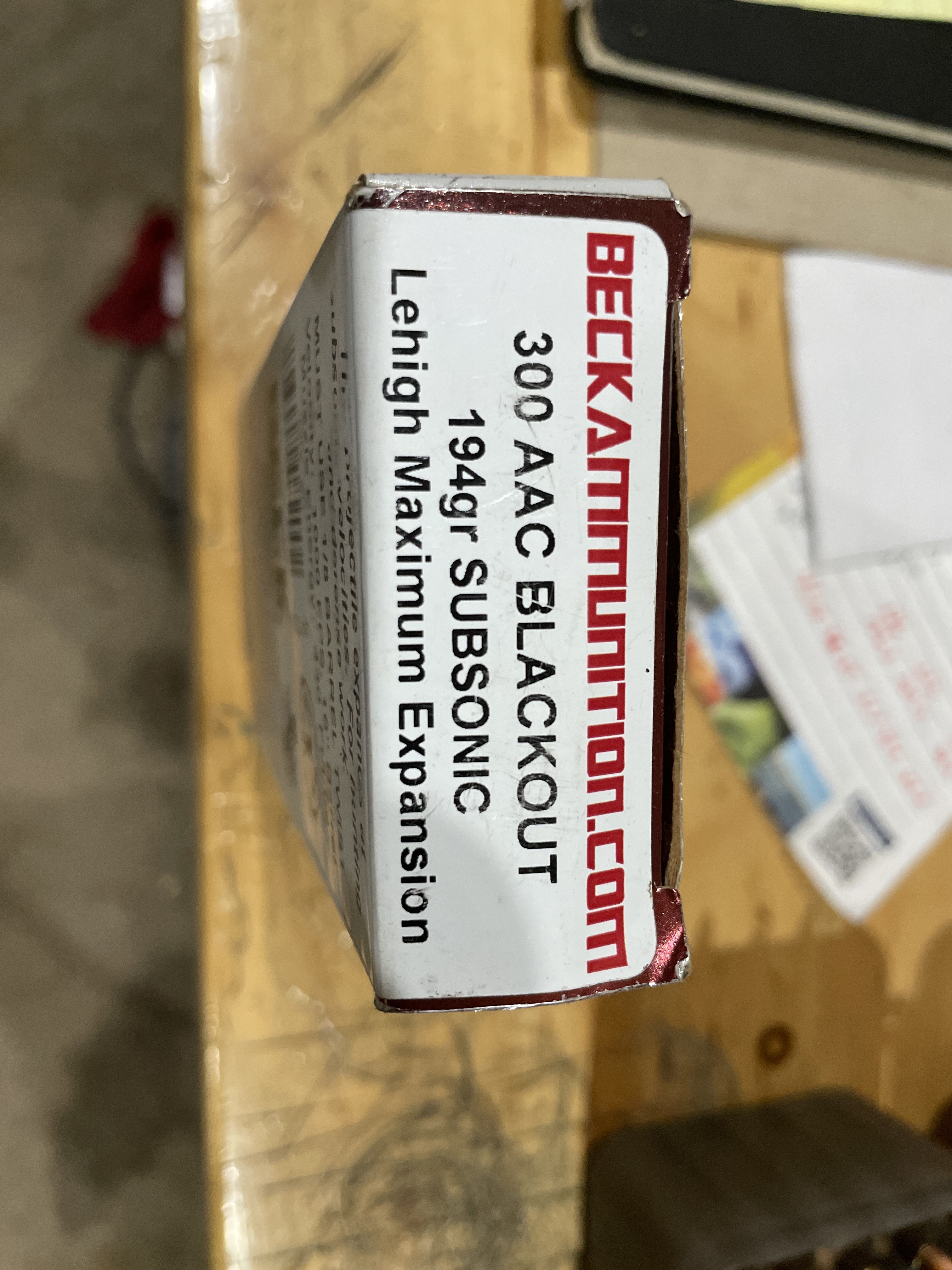

I started with ammo from “Beck” loaded with lehigh 194gr. they shoot very well out of all my b/o guns. Also had couple of boxes of hornady 208 gr did well. The least accurate has been anything with t-rex projectiles. They shoot 2” at best 100yd. Have good luck loading with 208 hornady.
