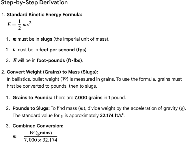

You answer regarding velocity, but how do we calculate energy (ft/lb)?
Yes, but never for Energy (ft/lb), how do we calculate that?
Thank you. I’ll try to figure out how to do it. I’ve never done anything like this before.
I can be a bit of a physics nerd, so for those who are interested:
For example, using my load for the 300 wsm with the 180 gr Barnes TTSX
KE = (180 gr x 2998 fps ^2)/450,436 = 3592 ft/lb
Of course, the online calculator is easier :laughing:
