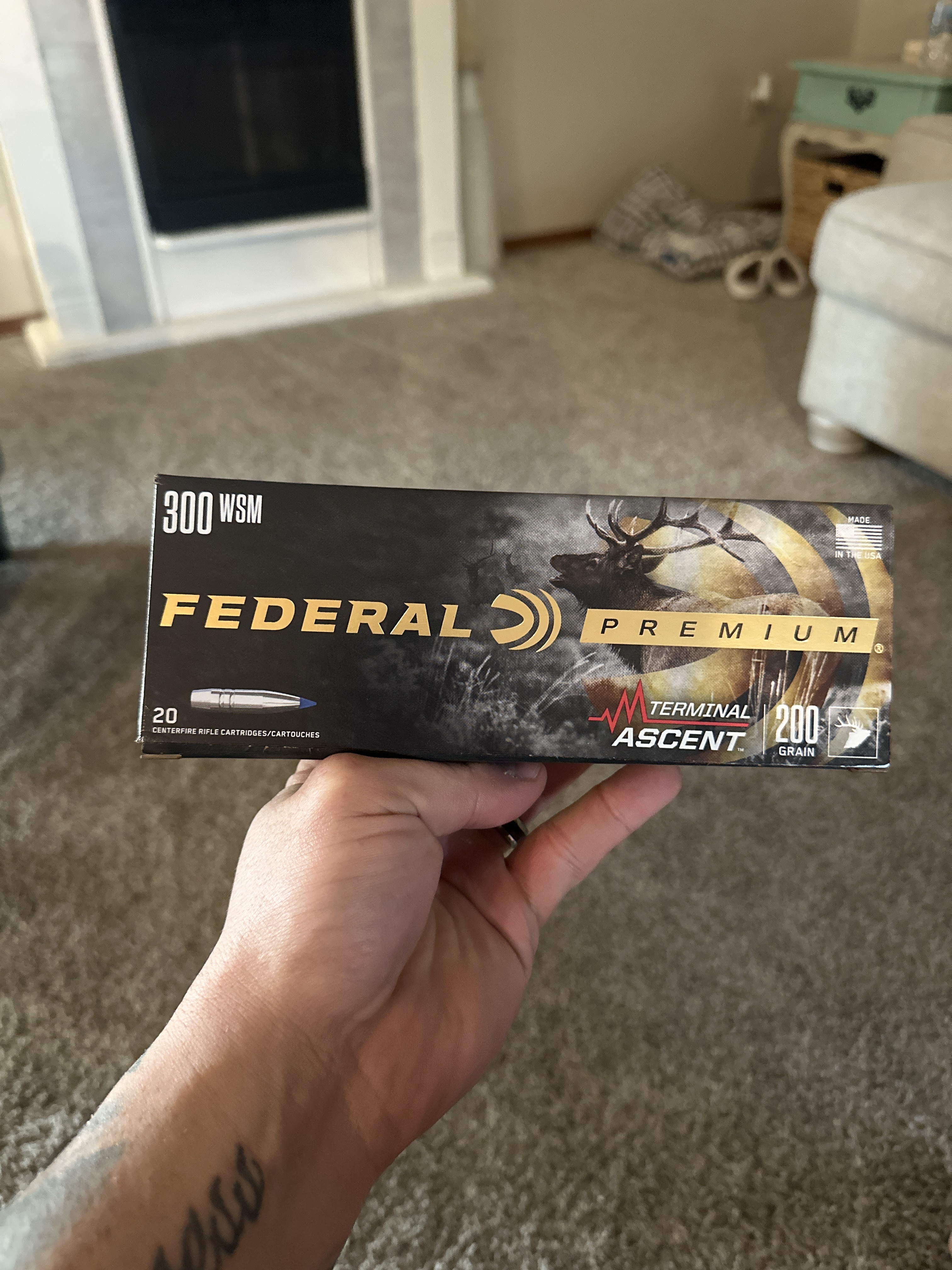

Ooh. That’s a tough a tough call. 300wsm is a fantastic cartridge. What load is it shooting now and how accurate is it? Wondering how similar it’s ballistics would be to a 7prc.
My 7 PRC shoots handloaded 168 LRX at 2830 at max book charge. Book calls for 2900-3000 at max.
300 WSM shoots factory 165TTSX at 3130 fps.
I’m shooting federal 200g
