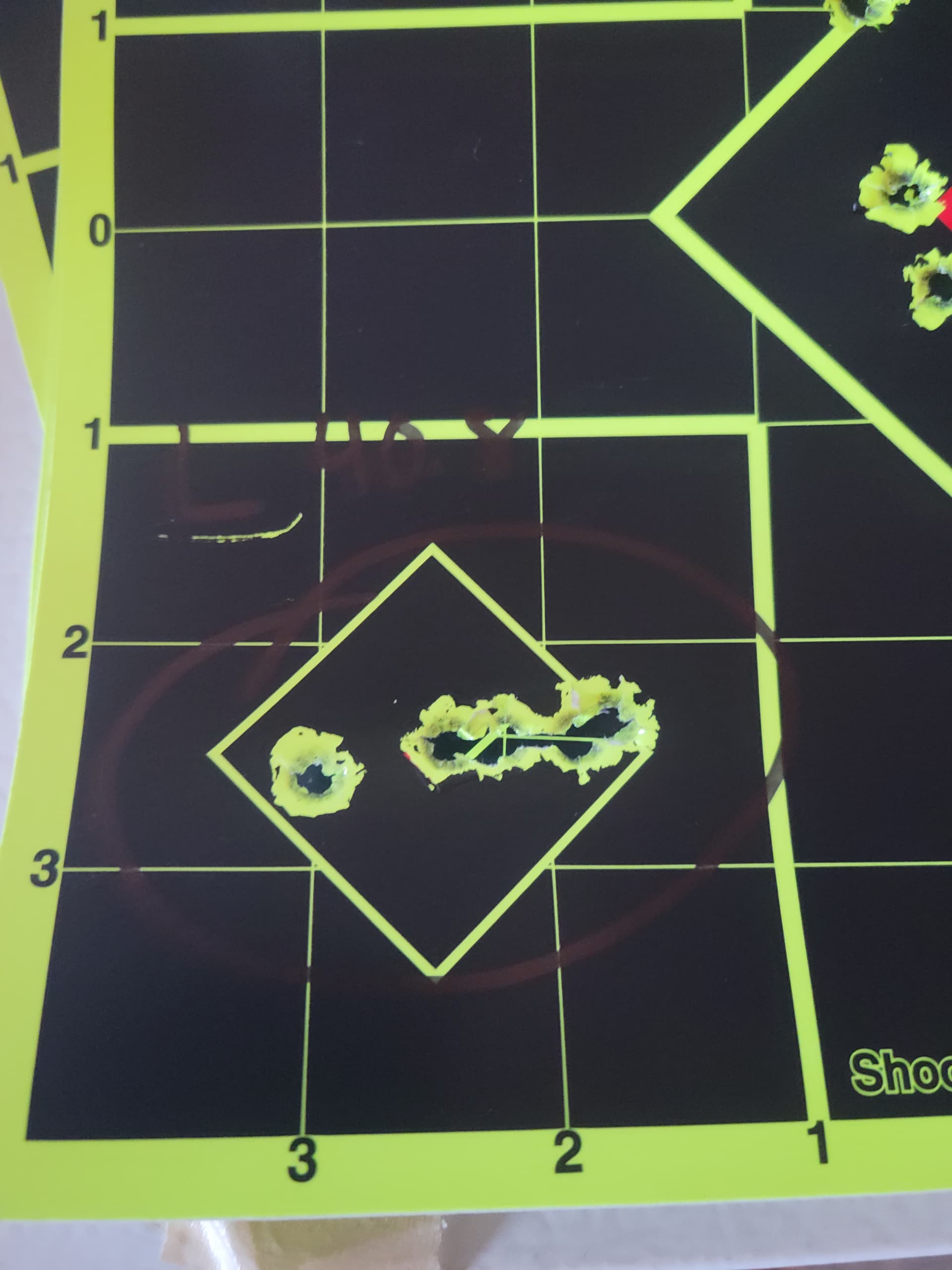

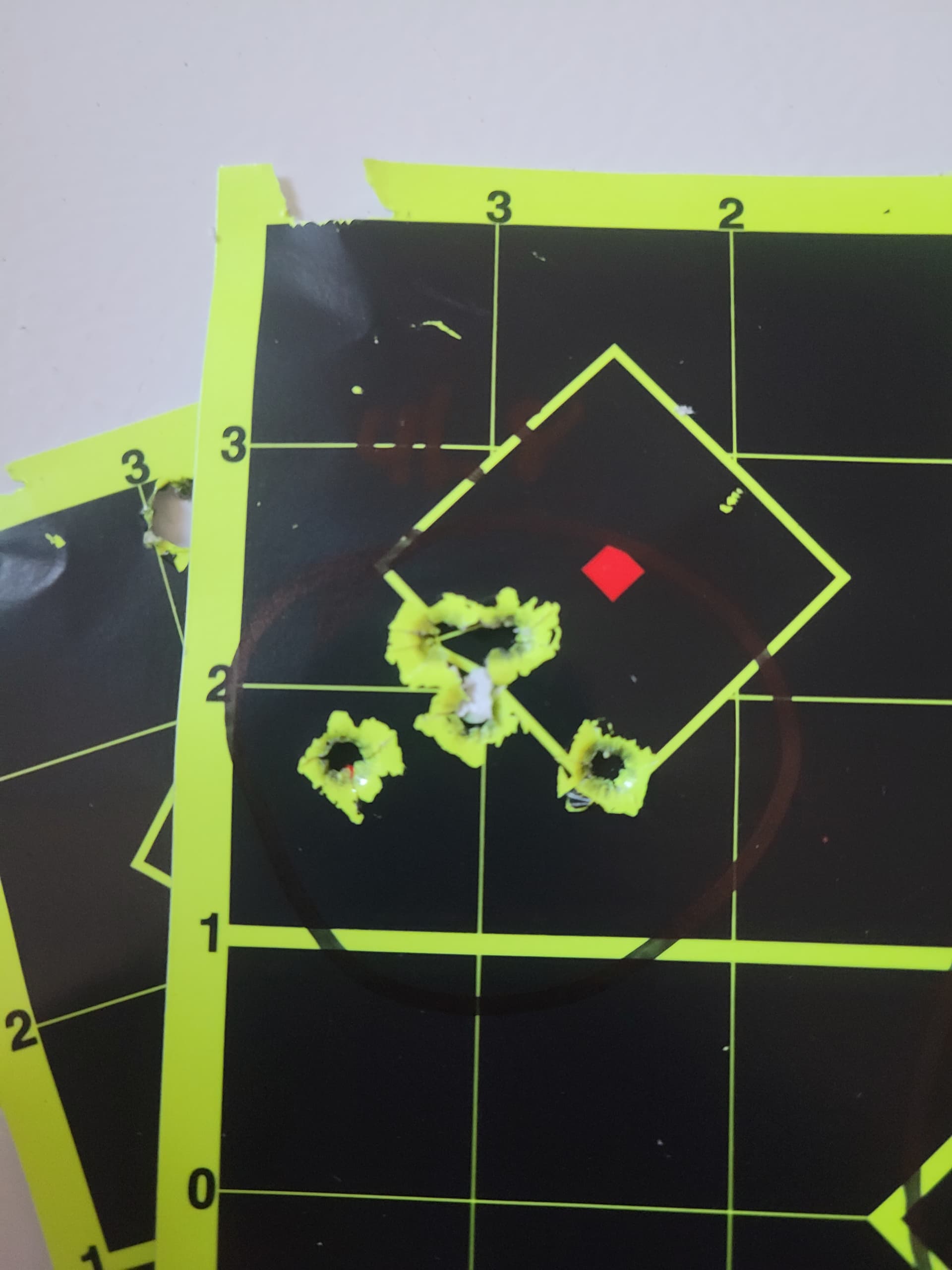

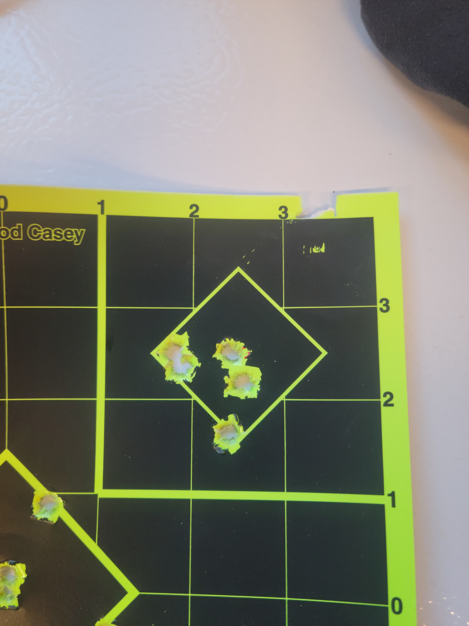

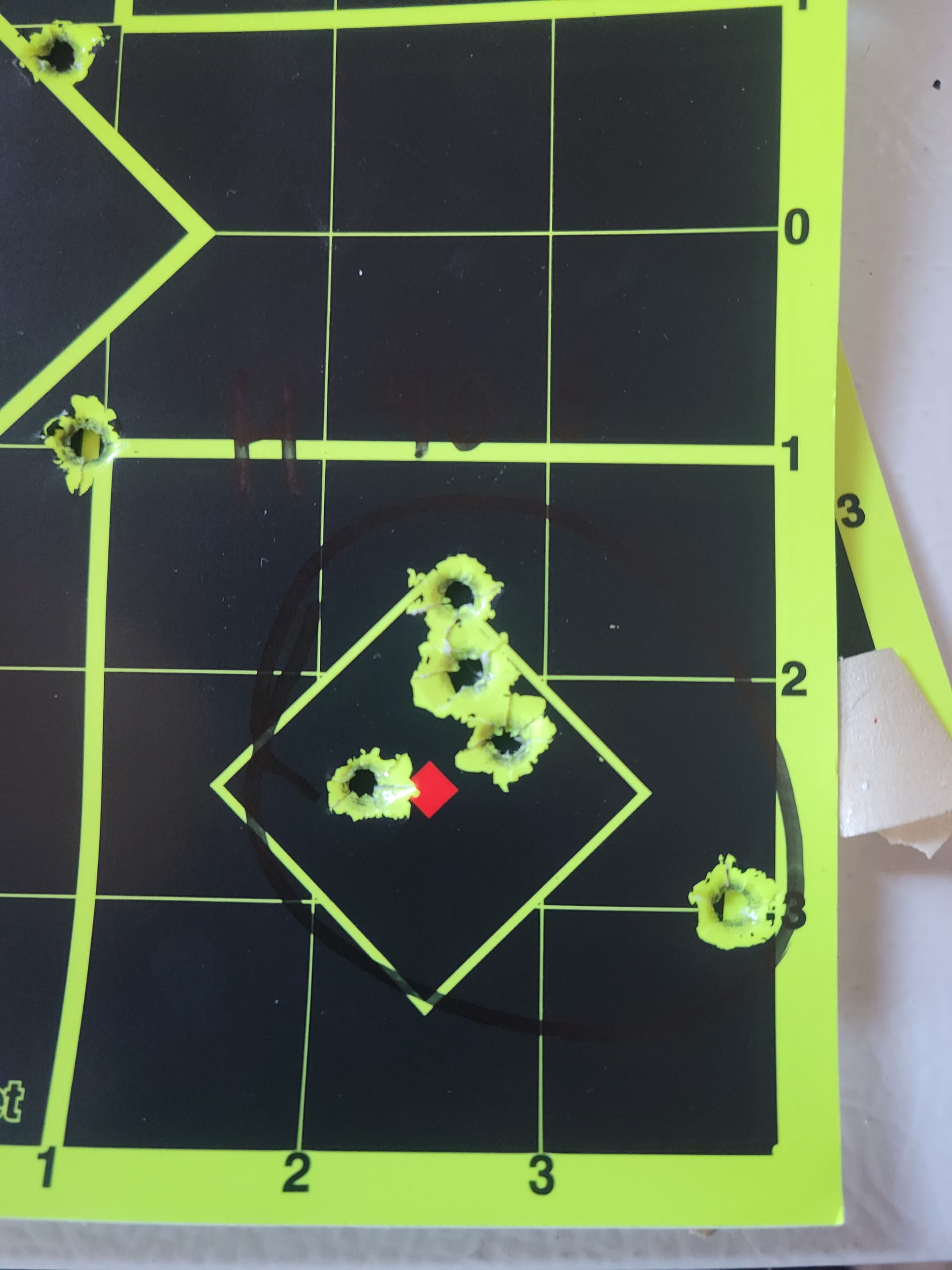

Finally got 4 loads with the 127g LRX that have been the best out of the probably 20-25 I’ve tested. Two separate range days down and another before my season starts to test these 4 again and see if they continue to group well. I’ve tested from 2.720-2.780 COAL and my rifle seems to like that Barnes recommended 2.750 range the best. I’m by no means the best shooter in the world but I’m definitely happy with these groups focused on hunting and not precision shooting. I had a few shots that were slightly off but it was most likely shooter error and the fact that it was 85 outside and I probably could have let the barrel cool longer. I have to order more supplies so it might be a few weeks before another update.
First Load is 40.5g H4350 in Hornady brass at 2.749-2.752 COAL
Second Load is 40.8g H4350 in Lapua brass at 2.755-2.758 COAL
Third Load is 41.0g H4350 in Lapua brass at 2.751-2.754 COAL
Last Load is 41.8g H4350 in Lapua brass at 2.750-2.752 COAL
Thanks for throwing these up here. I’ll do the same once I can test a similar ELD-X load to Jim’s.
