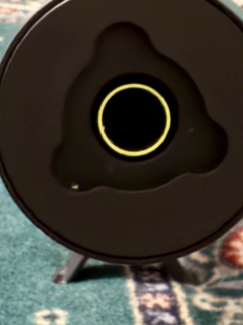

One thing to note did you check your bore on your suppressor to the barrel bore with a bore alignment rod before you went out and shot it.? After installing a suppressor on any of my rifles, I use bore alignment rods to check whether the suppressor is mounted on the bore correctly and has clearance for the bullet. Especially if it’s a long can. If something on your rifle is not correct or the alignment is off it gets exaggerated at the end of the suppressor. I use accuracy, solutions, alignment, rods. They can be found here https://accuracy-solutions.com/.
Dead air suppressors has a whole bunch of videos on how to check your alignment on your suppressor to the bore of your rifle. Sounds to me like you had a catastrophic baffle strike. Also, I use the Kemo Dead air mount for my supressor.

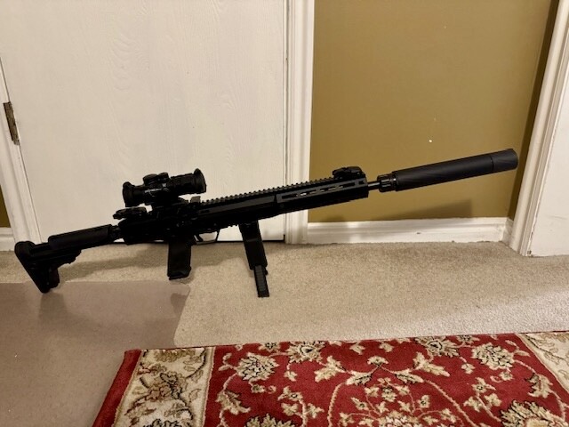

Here is a link to the YouTube video by dead air on how to check your bore alignment on your suppressor. https://youtu.be/QAxqmKT3L2k. In fact in the video, the rifle that he screwed three suppressors on all of the suppressors were a little bit to the right so even the rifle he had was not dea on center of the bore, the threads on the muzzle end there were enough to clear, but that’s what the rod told him. It’s a good video watch it. It’ll explain a lot. Even Gavin gear on ultimate reloader says that he checks all of his suppressors with bore alignment rods before he ever shoot them. Here is a picture of my banish 46 on my Ruger LC carbine 45 ACP. I have one of the accuracy solutions, carbon fiber bore alignment rods in the barrel and you can see that the bore of the suppressor is not exactly centered. It’s safe and that’s what the Bore rod shows and that’s all you need.
IMG_0191
