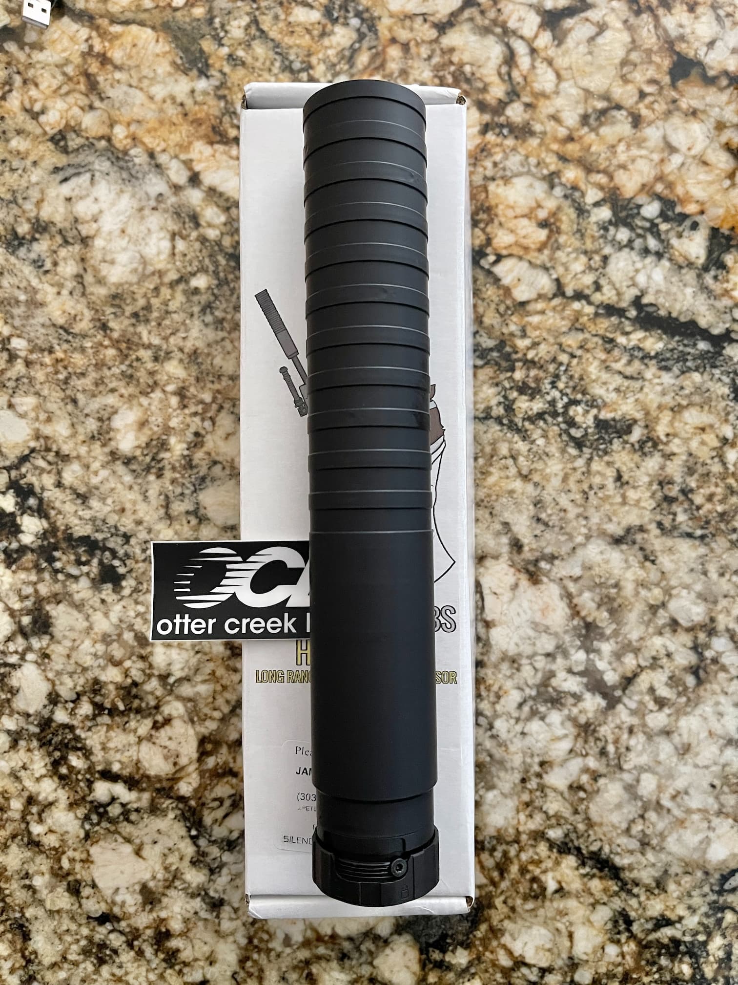

I have an Otter Creek Labs Hydrogen L 7.62, mainly for my 300BLK, but will also attach via common hub mount to my LFAR .308 or my SFAR 5.56.

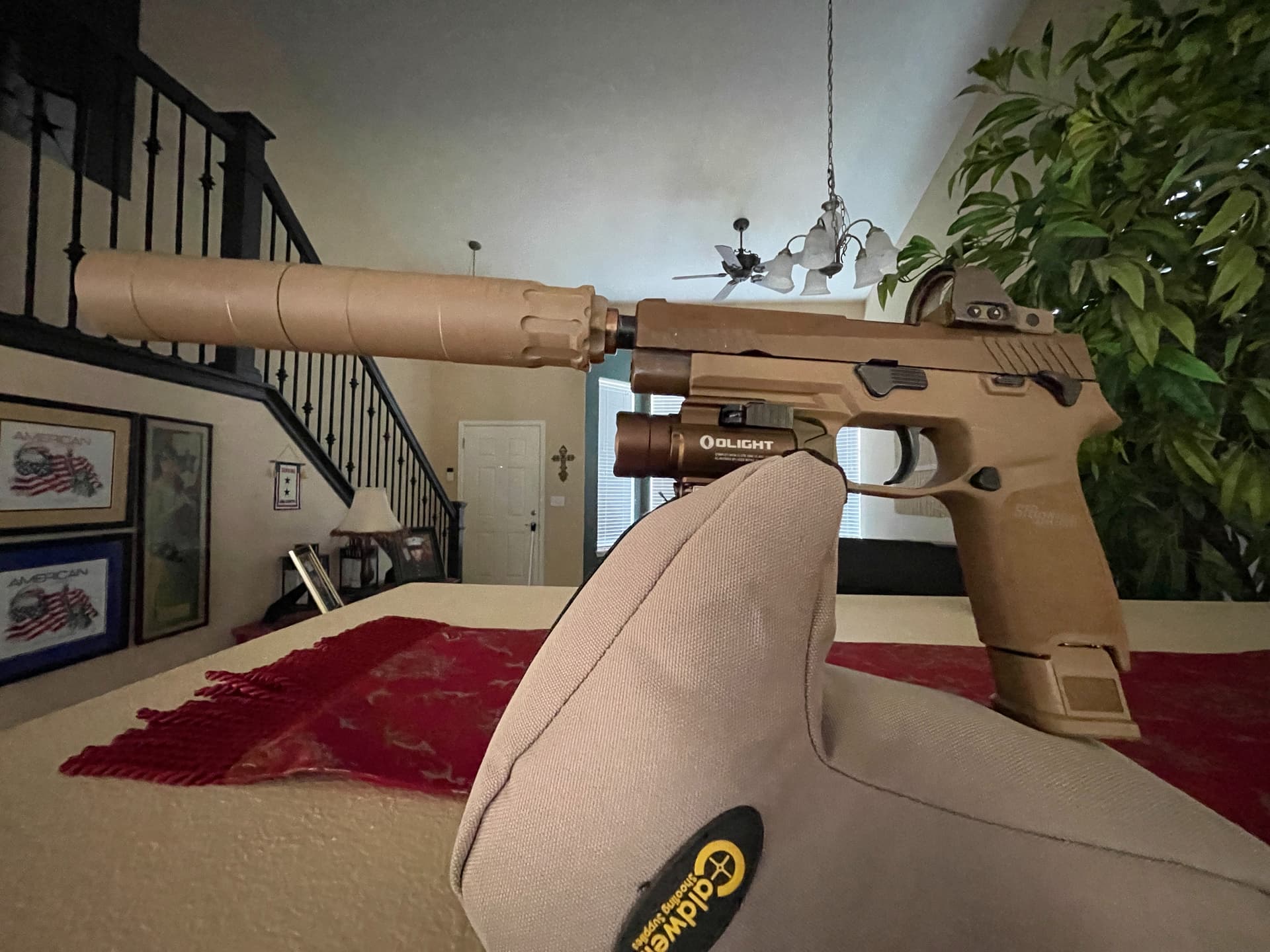

I also have a Rugged Obsidian 9 for my 9mm pistol(s). That is a direct-thread.
Both do an amazing job at sound suppression.

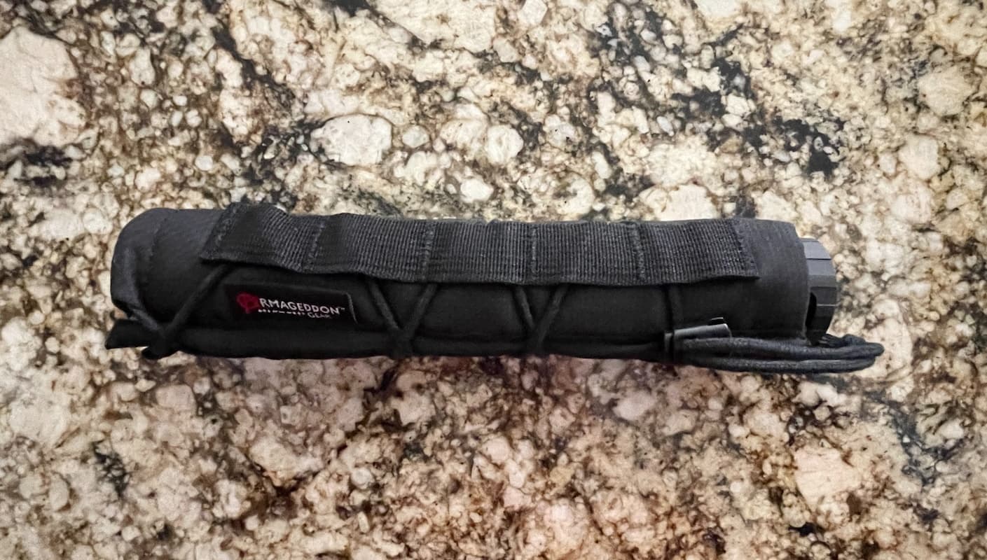

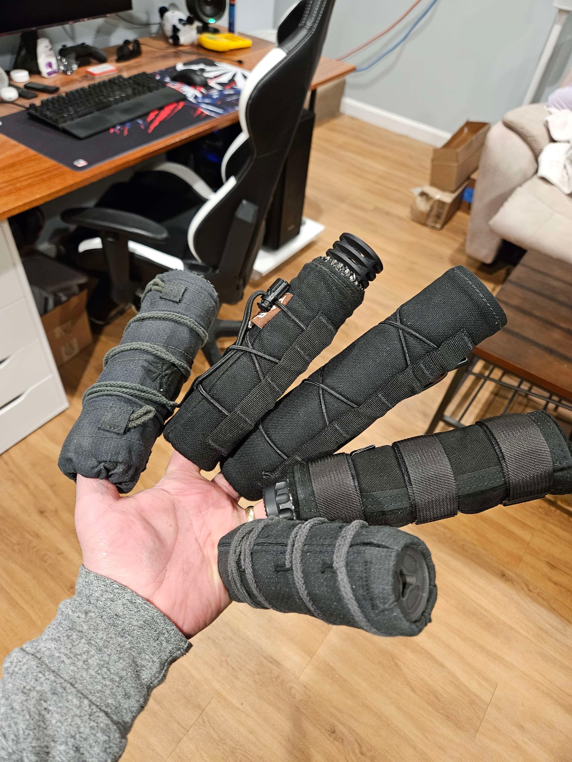

Nice photo which also demonstrates something we haven’t been talking about the need for a good suppressor cover. Perhaps not absolutely necessary in a hunting situation but when sighting in at the range, after a couple of shots your view through a regular rifle scope is destroyed by the heat signature
I usually don’t run one on my hunting rigs, but if i do i run the BPG ones - super light and low profile.
Tab Gear makes some great ones i’ve been experimenting with. the SAS3 w/ bungee might be the best setup/design for a cover period (pictured in the photo).
They also say that a cover helps with the sound reduction as well
