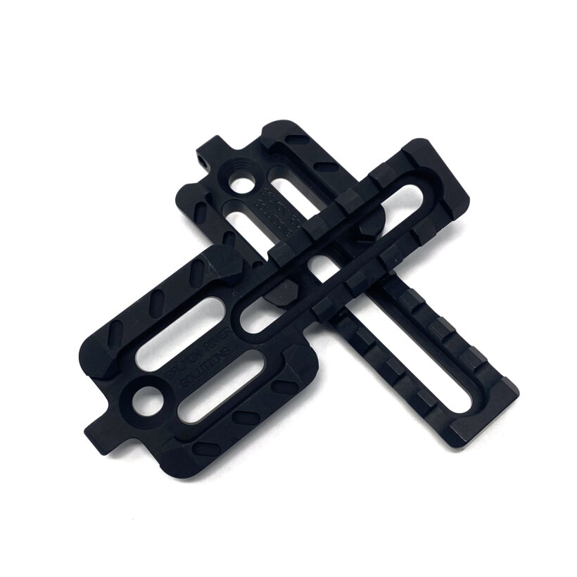

I put a Salmon River STS PIC+Arca where the stud was. Rails – Salmon River Solutions
I use same stud swivel on sling to connect to the new base. Pic for bipod and arca for tripod shooting.
Seems like good stuff. Comes with all hardware. Not affiliated with them other than as a customer

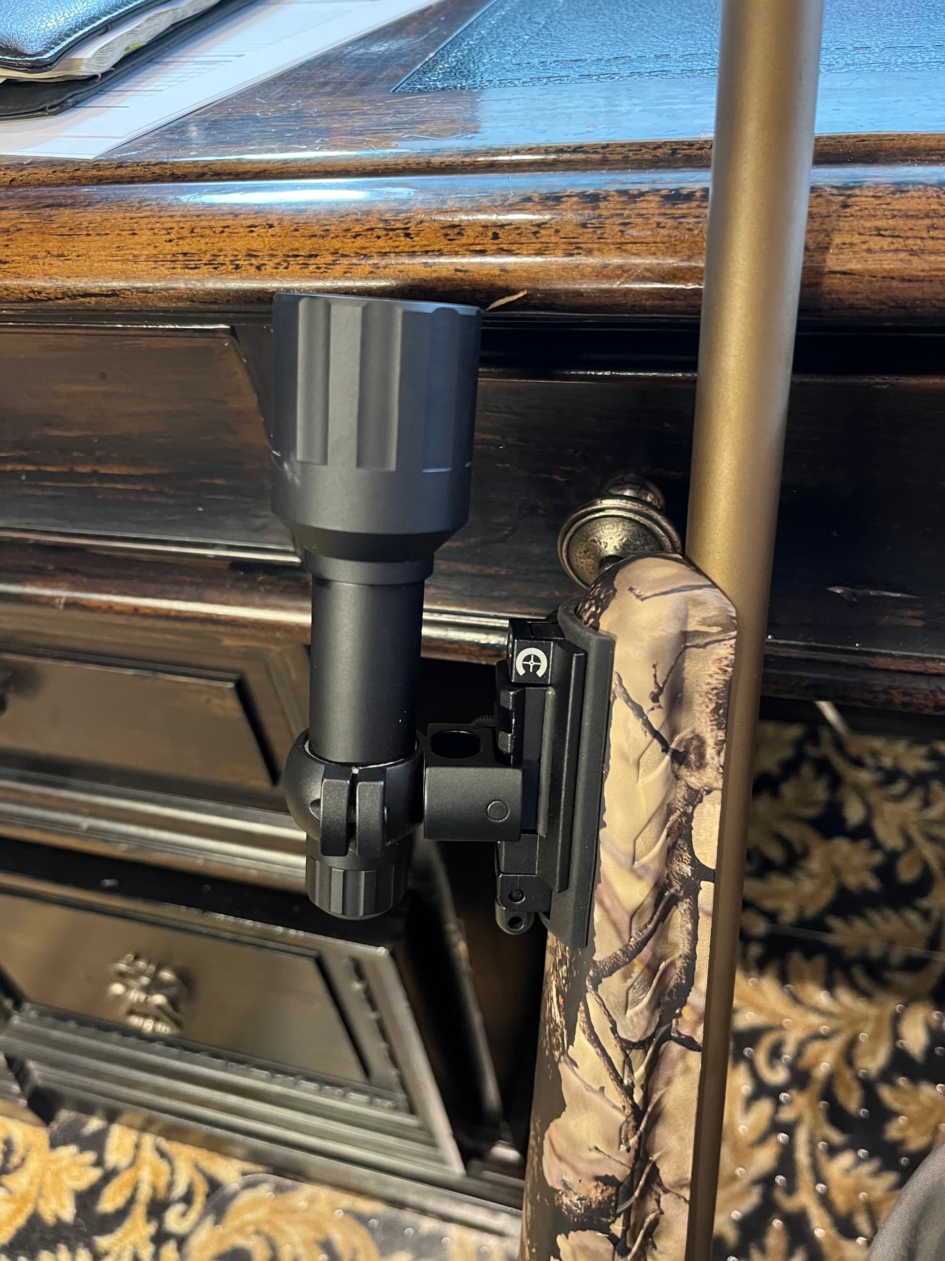

Caldwell makes what you are describing. This is a Ruger American Go Wild in 22WMR. It has a Sightmark Wraith 4k Mini NV. I needed a way to attach an IR Illuminator, so this worked perfectly. It also helped that the illuminator was under the barrel.
Yep that’s it! Would you say it attaches pretty securely? Or is there some side to side play in it?
Definitely rigid. No movement at all
