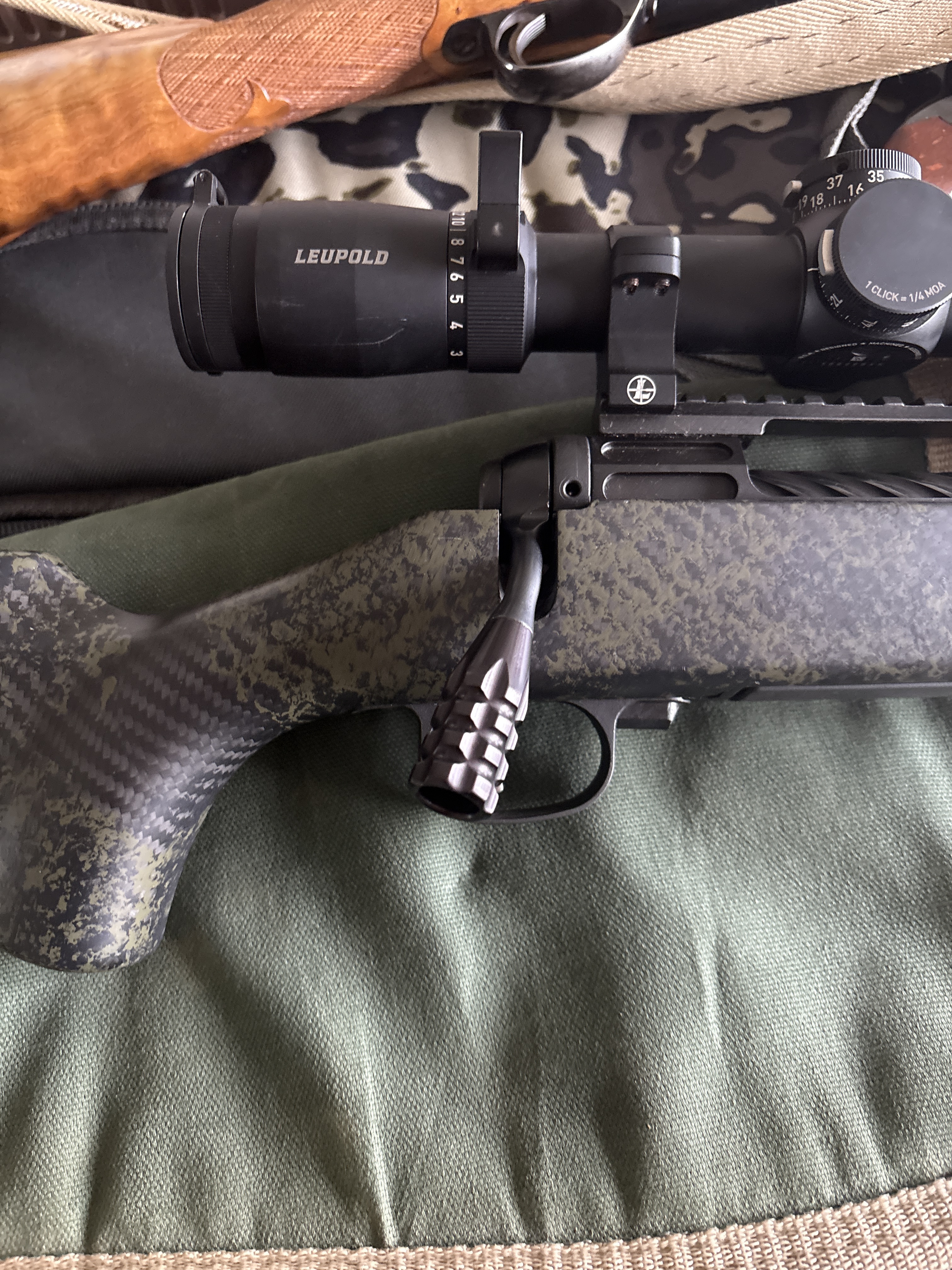

bigger than moa groups. I need to fix my rifle because I get flinchy due to bolt handle driving into my trigger finger knuckle.
Out of curiosity, which rifle is that? I’ve never had that happen with a rifle before until just recently with a fierce rival, and it is driving me bananas.
savage 110 ultralight. I bought a new bolt handle because the stock one was a hard bolt lift. I got one of the pineapple knobs which is the problem. Not nice on the knuckle.

That’s very similar to the one on my Fierce which is giving me grief. Did you replace it with one made by savage, or aftermarket? Curious if Fierce"s is proprietary or not.
Aftermarket - I forgot where I got it.
