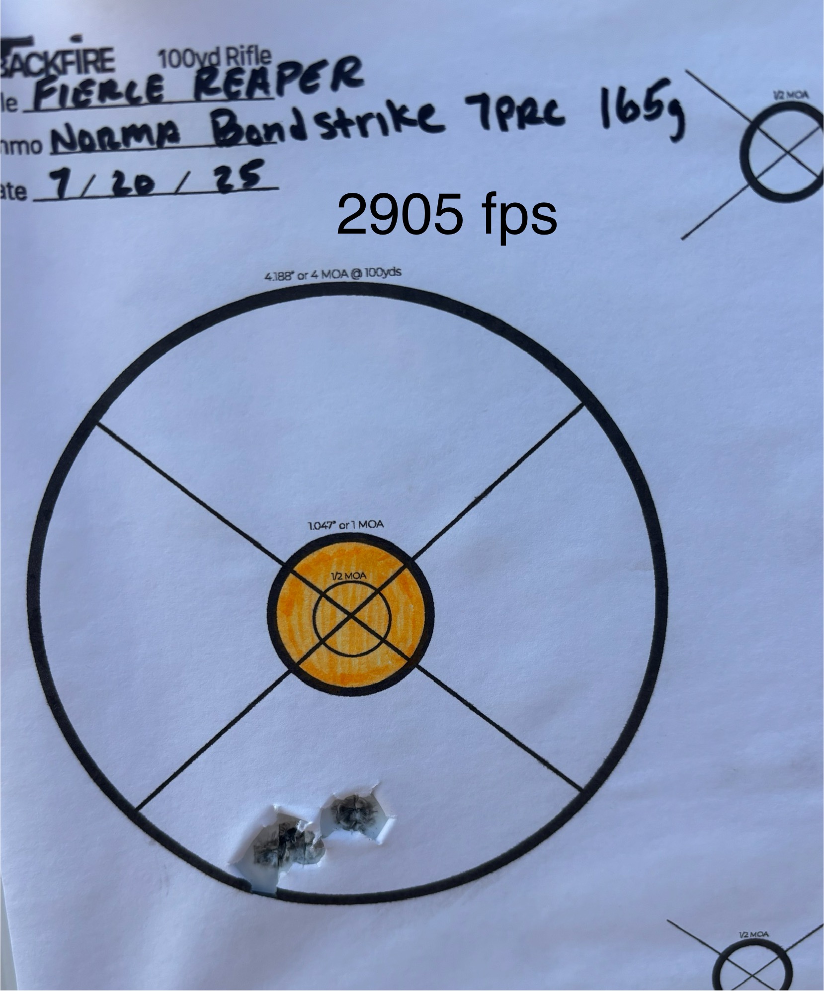

I love the 7prc. Shoots softer than my 300wm and mine groups awesome w almost everything I’ve tried, chose to go w factory Norma Bondstrikes. Fierce reaper 22” barrel. Scythe Ti suppressor. 5 shot group

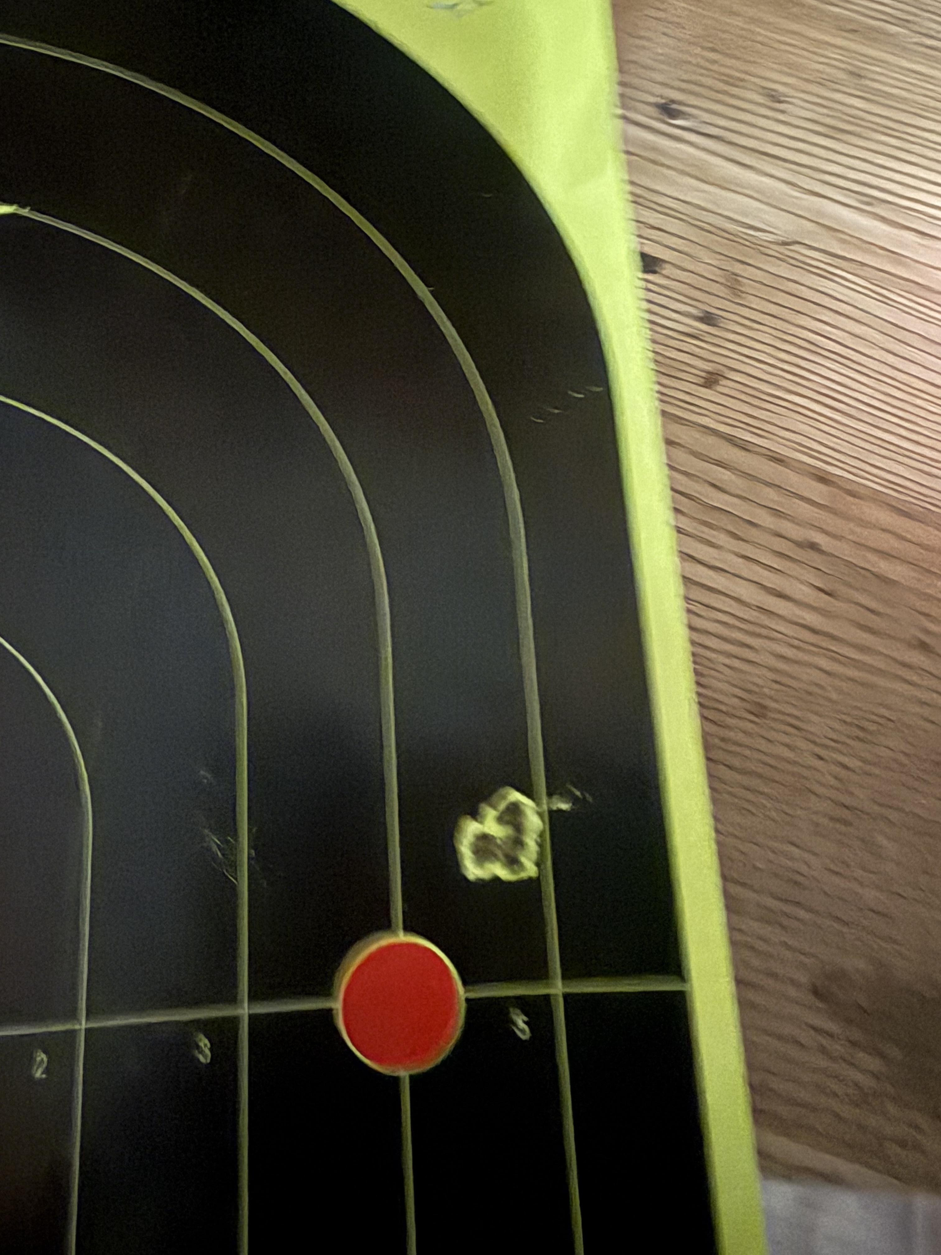

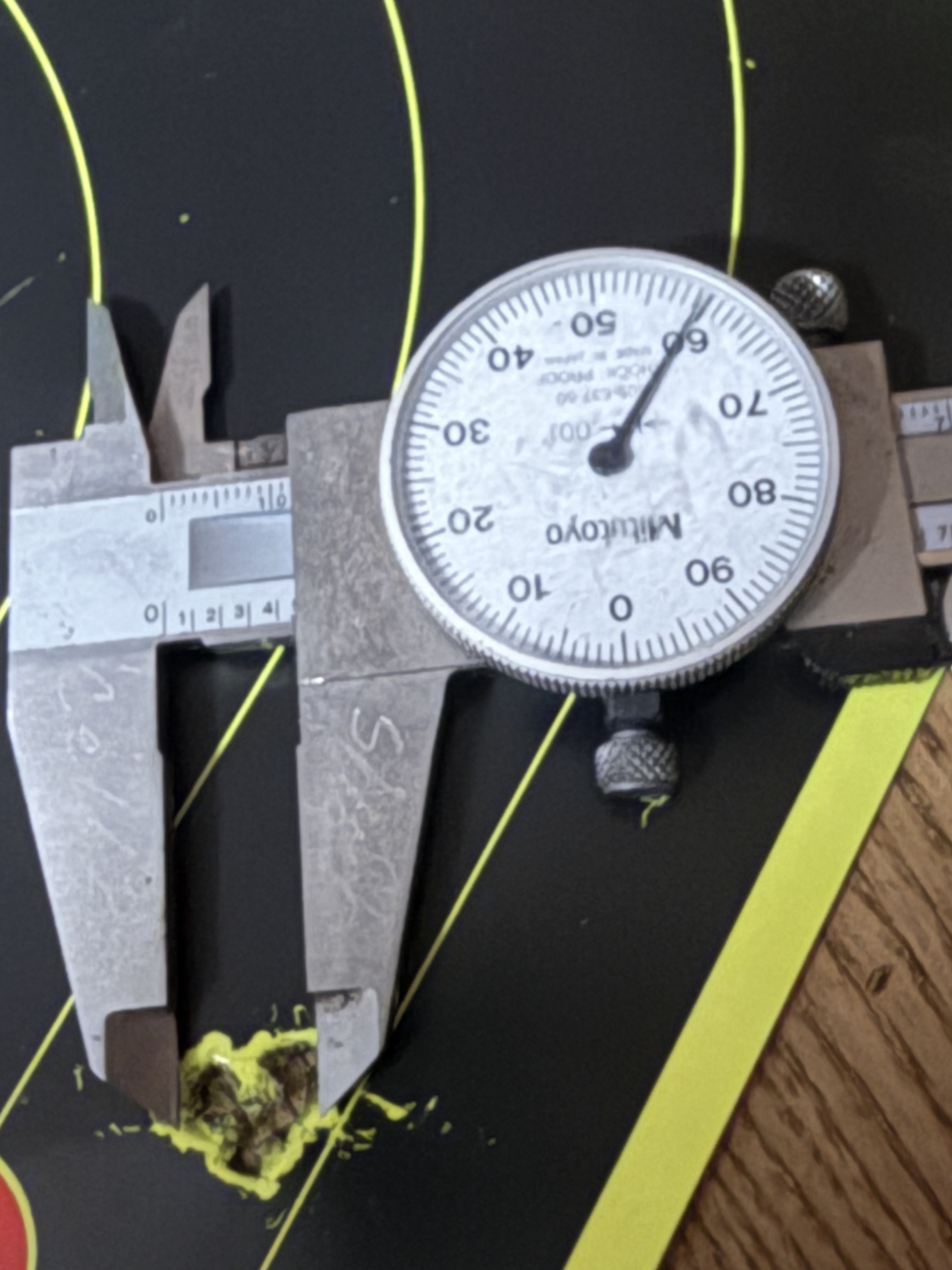

They can be very accurate but they have to be built on the right platform. This group was from a 7prc tikka that I just got done doing load development for the only difference was the guy swapped out the stock. Still a light weight rifle but with better stock lines.
Is that the same one you were dealing with which had the 1:9 barrel ?
Yeah once I swapped to a 162 grain eldx it shot great largest group was a .6 moa but I think I had a bad powder charge because my sd and es went up on that group but after averaging 6 3 shot groups it’s a .36 moa rifle so a little better that a 3/8 average.
How much did it weigh when you got this group? Impressive, btw!
That’s very impressive indeed ! Congrats to you and the rifle’s owner.
