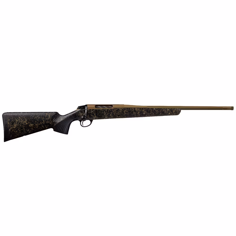

What about this Tikka T3x
? Bonus i think the barrel color would go perfect with the green and black chassis. its 24” barrel and threaded.

Only problem with this one is the threading isn’t your typical 1/2-28 or 5/8-24. I believe it does come with an adapter though. For some people this may not make a difference, but for me It would so I figured I’d mention it
