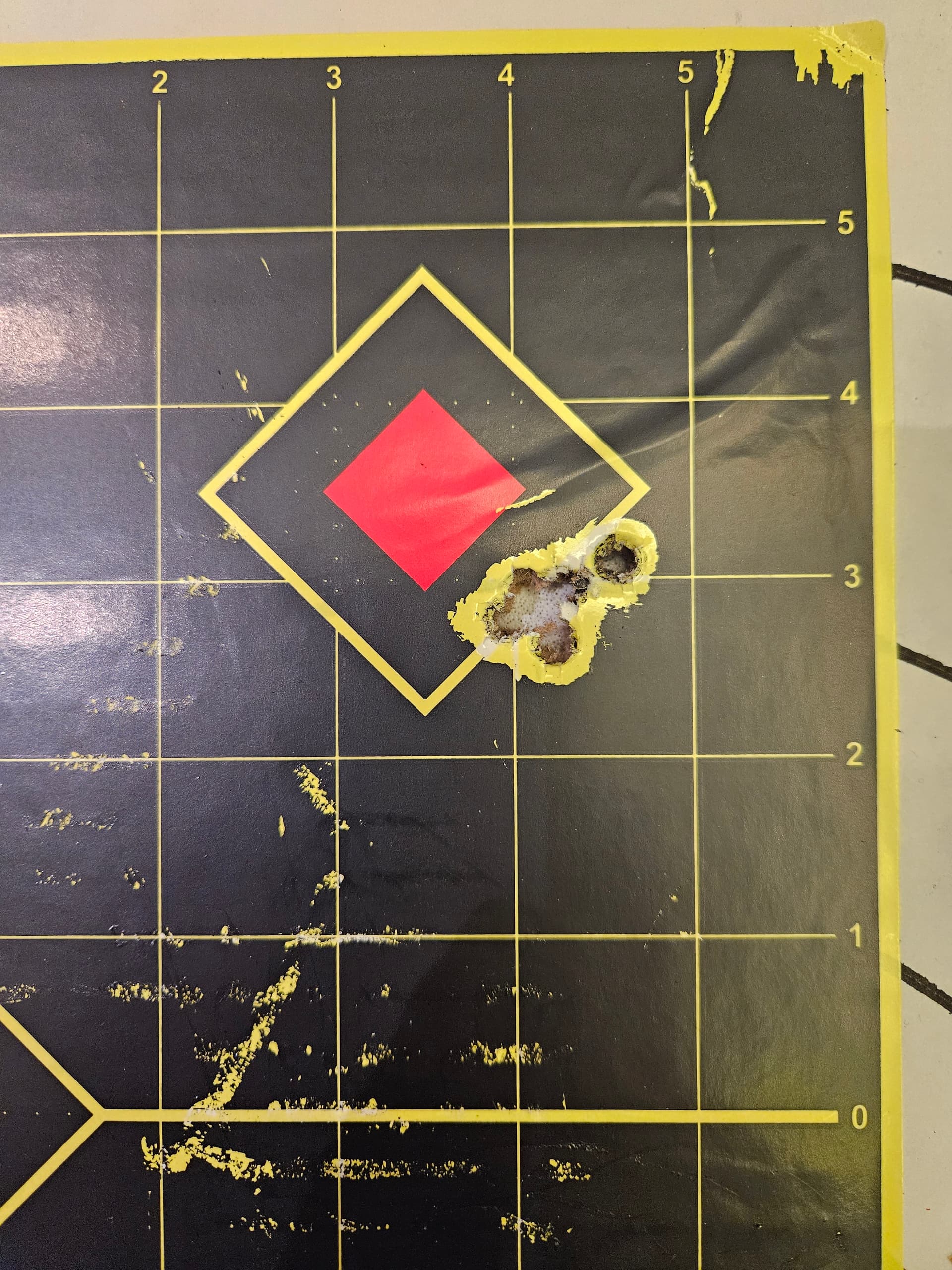

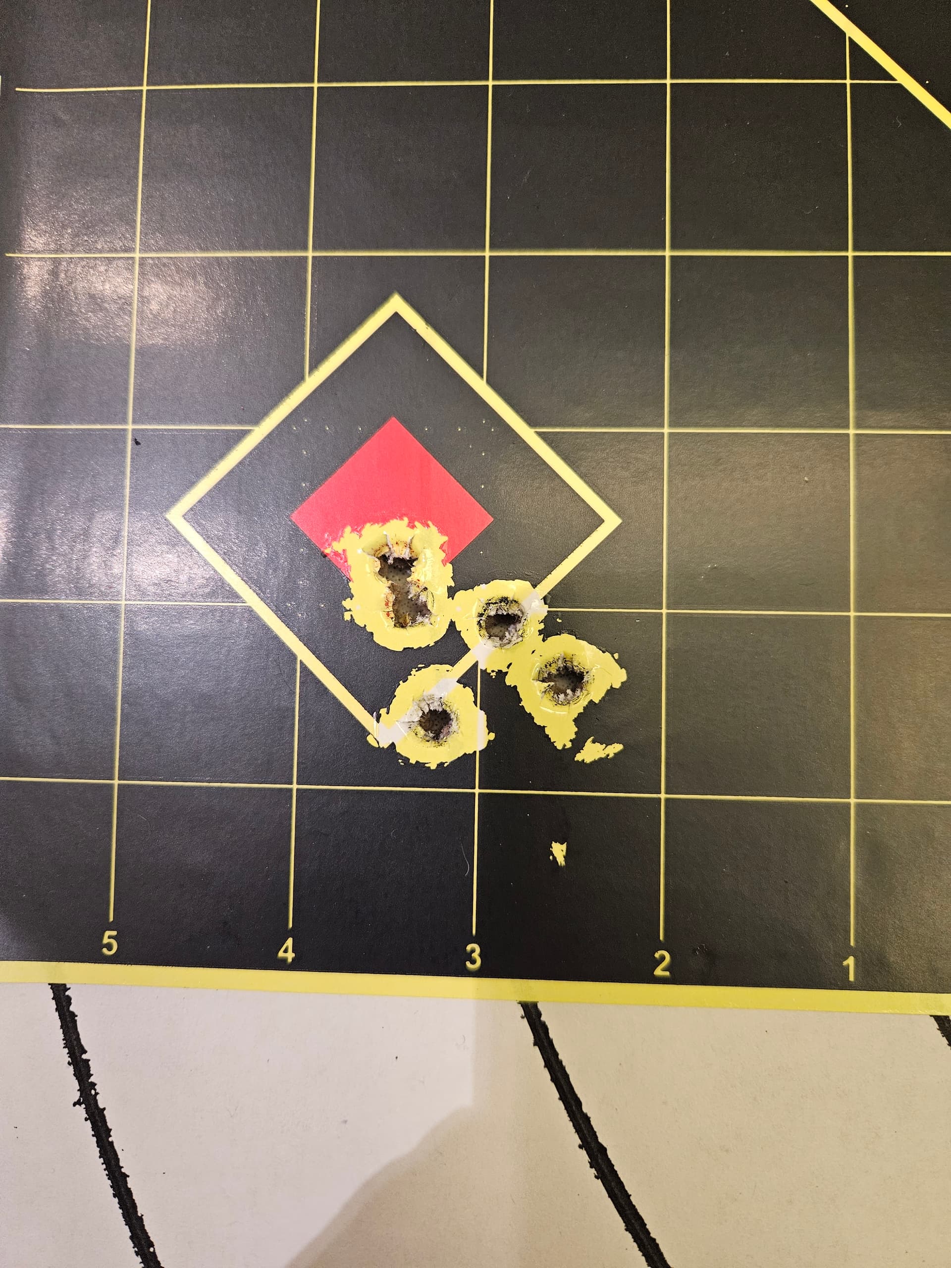

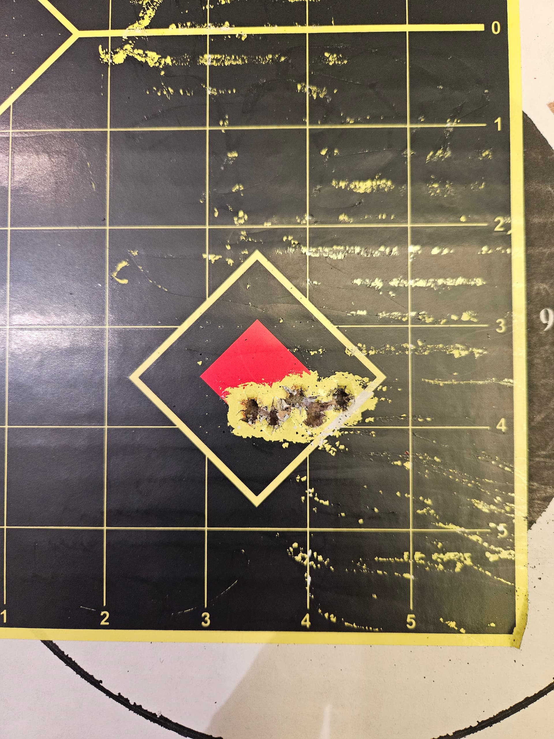

Initially I got good results with Ramshot Hunter and the 180 gr. Barnes TTSX. I played around with the charge weight, getting close to maxing out (Barnes load data) and seeing almost 3100 fps, but the accuracy suffered a little. I went back down a little and loaded up 18 rounds. I messed up two cases :frowning:
I shot one fouling round and then 3-five shot groups. The average velocity was 2998.8 with a 14.7 SD. The group sizes were:
Group 1: 0.691”
Group 2: 0.860”
Group 3: 1.077
I am pretty happy with those results. Now I just need to load more!

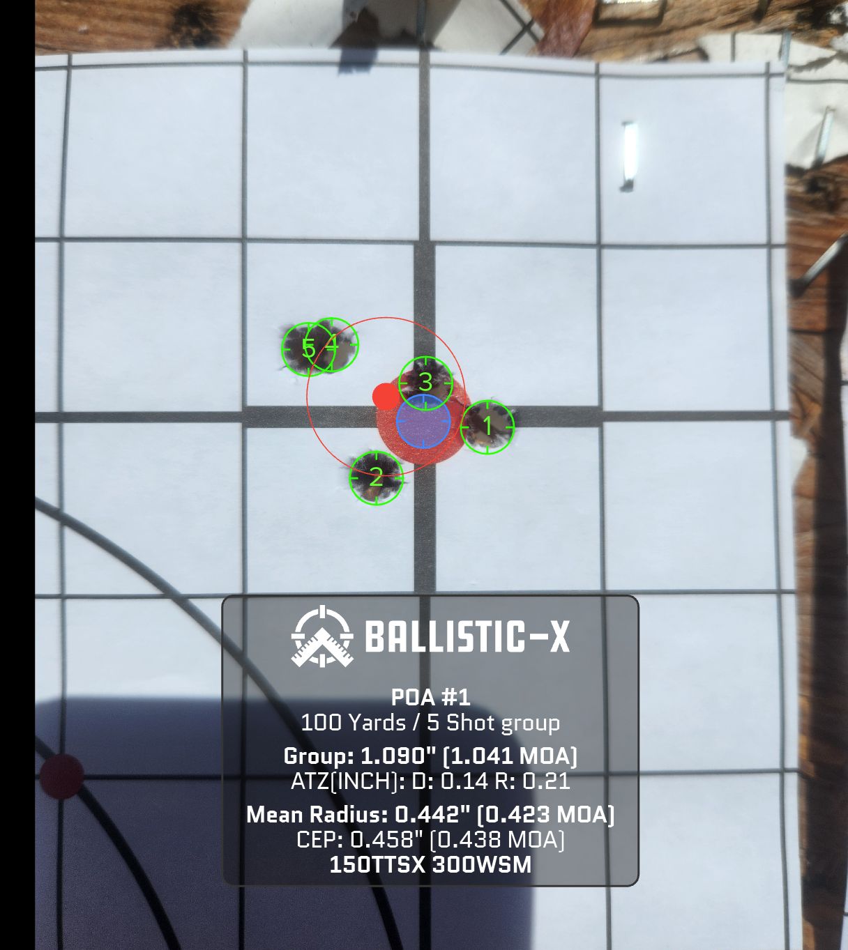

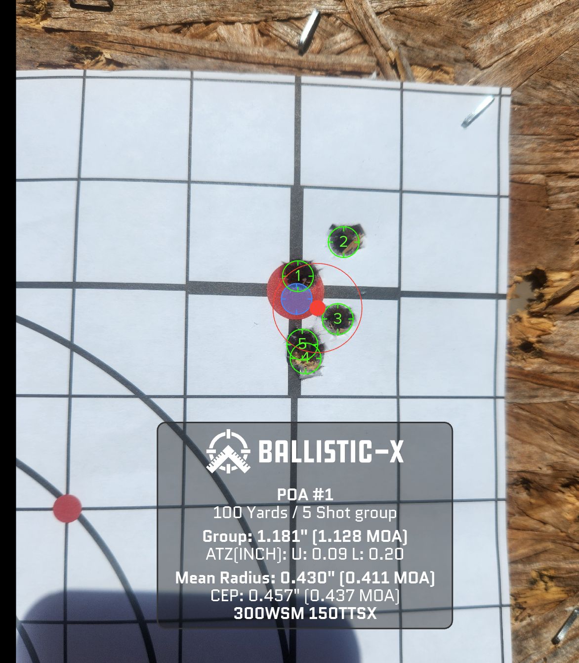

Not as good as yours, but if you ever feel the need for speed, then try the 150TTSX over H4350 @ 3195fps.
