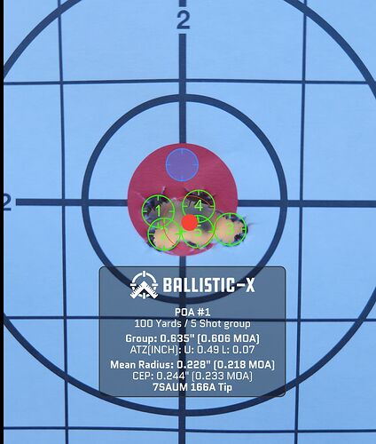

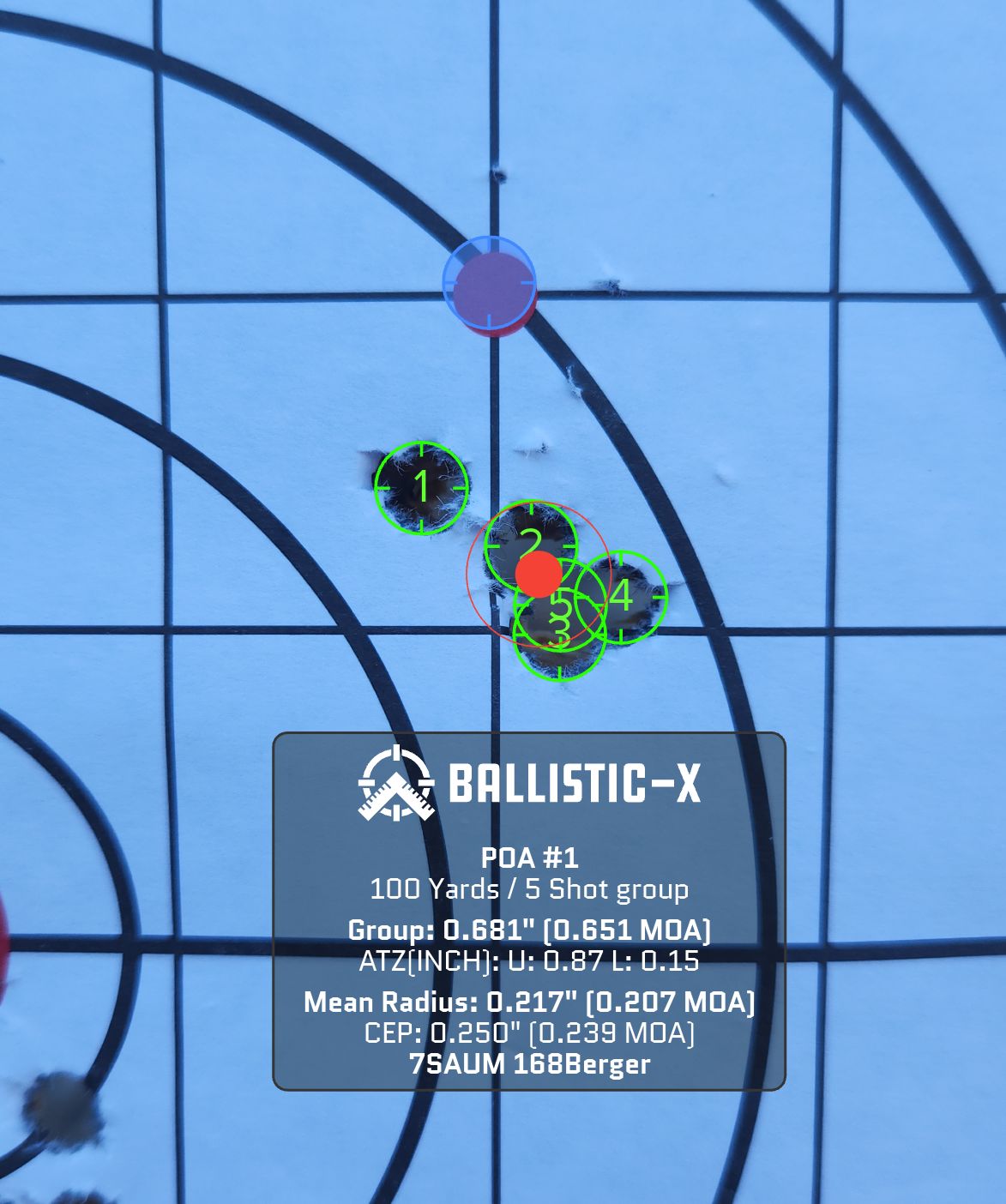

I put 20 rounds of cheap Remington ammo through it just to wear it in a little bit. I was very impressed with what I was seeing with those first 20 rounds. I then cleaned it and today took it out to try some more premium ammo.

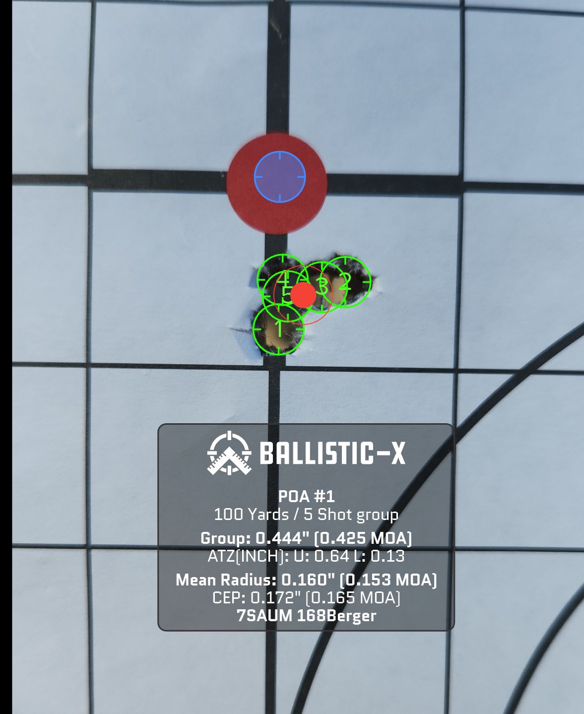

Berger 168 Classic Hunter loaded by Copper Creek.

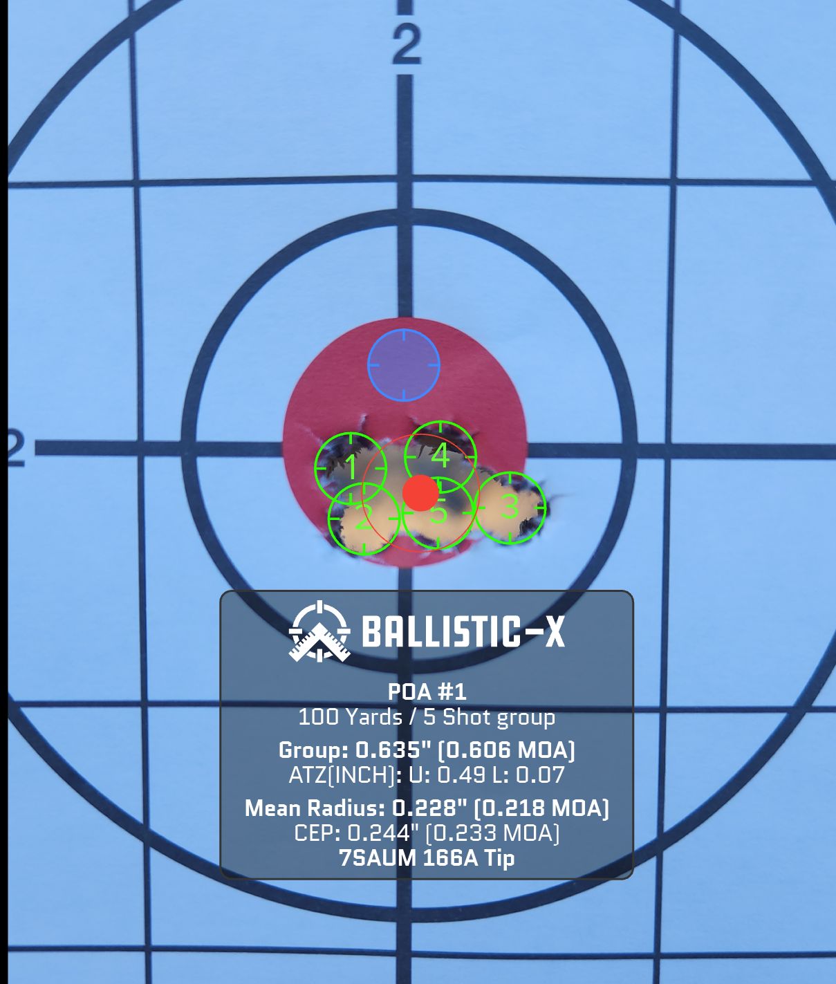

Then 166 A Tip, also loaded by Copper Creek
Pleased with the performance so far. What I wasn’t expecting though was that for the 168 this 22-in Barrel is giving me the exact same velocity that I get with that bullet shooting it out of a 26 inch 7 Rem Mag (2750).

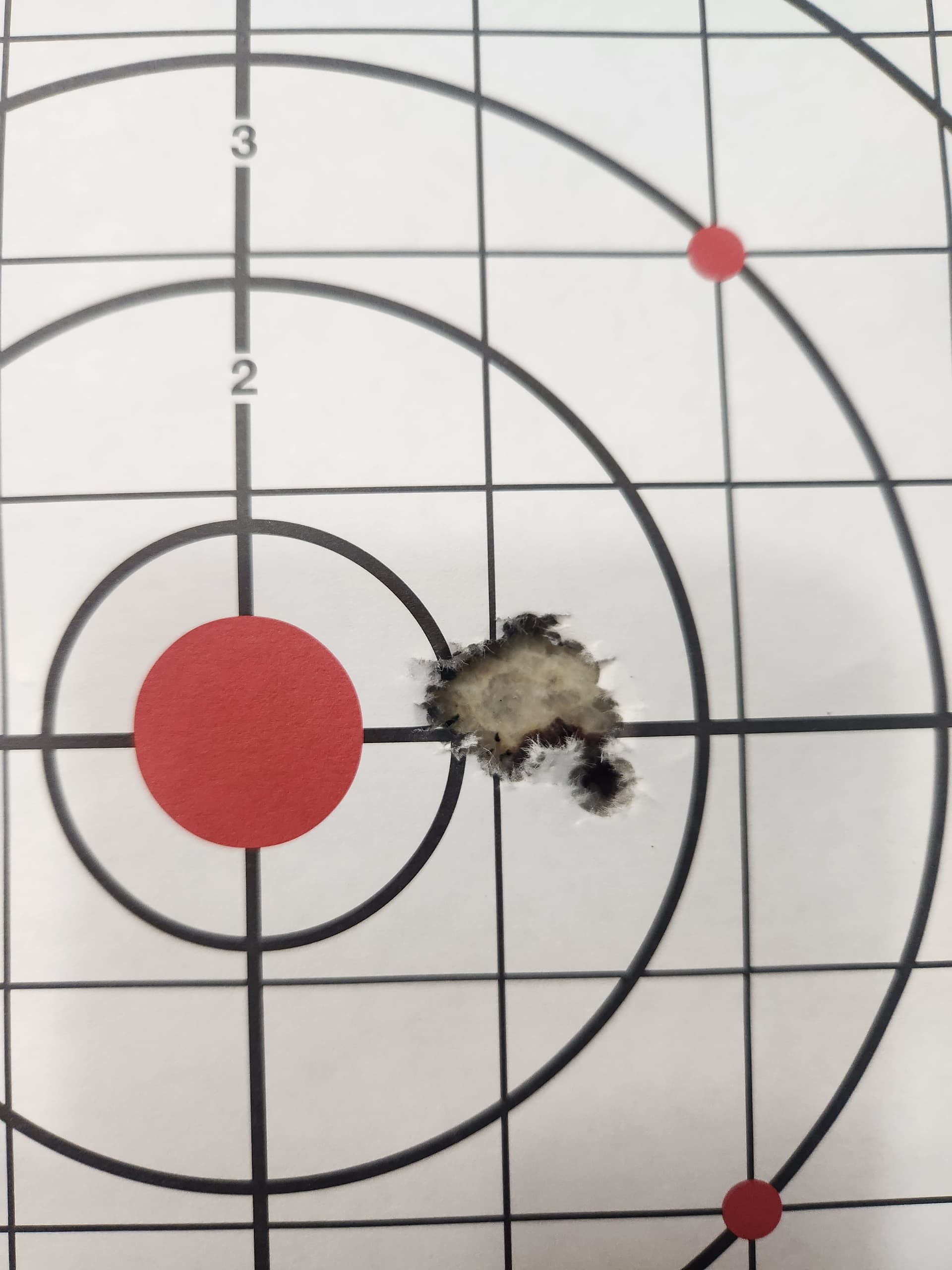

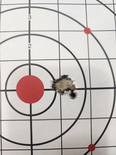

Took her out today with a handload 162ELDX over H4350.
First time I’ve ever tried a 10 shot group

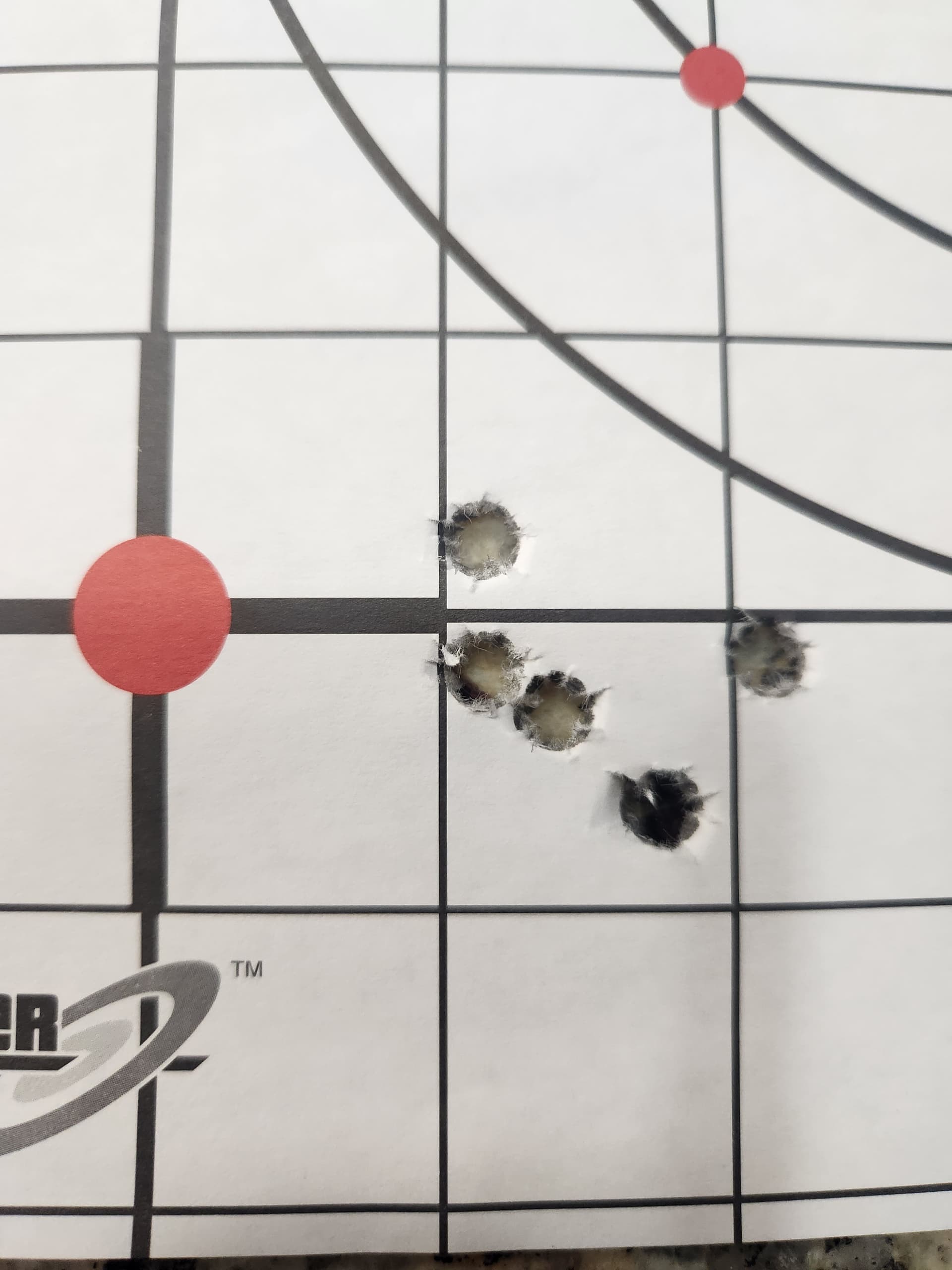

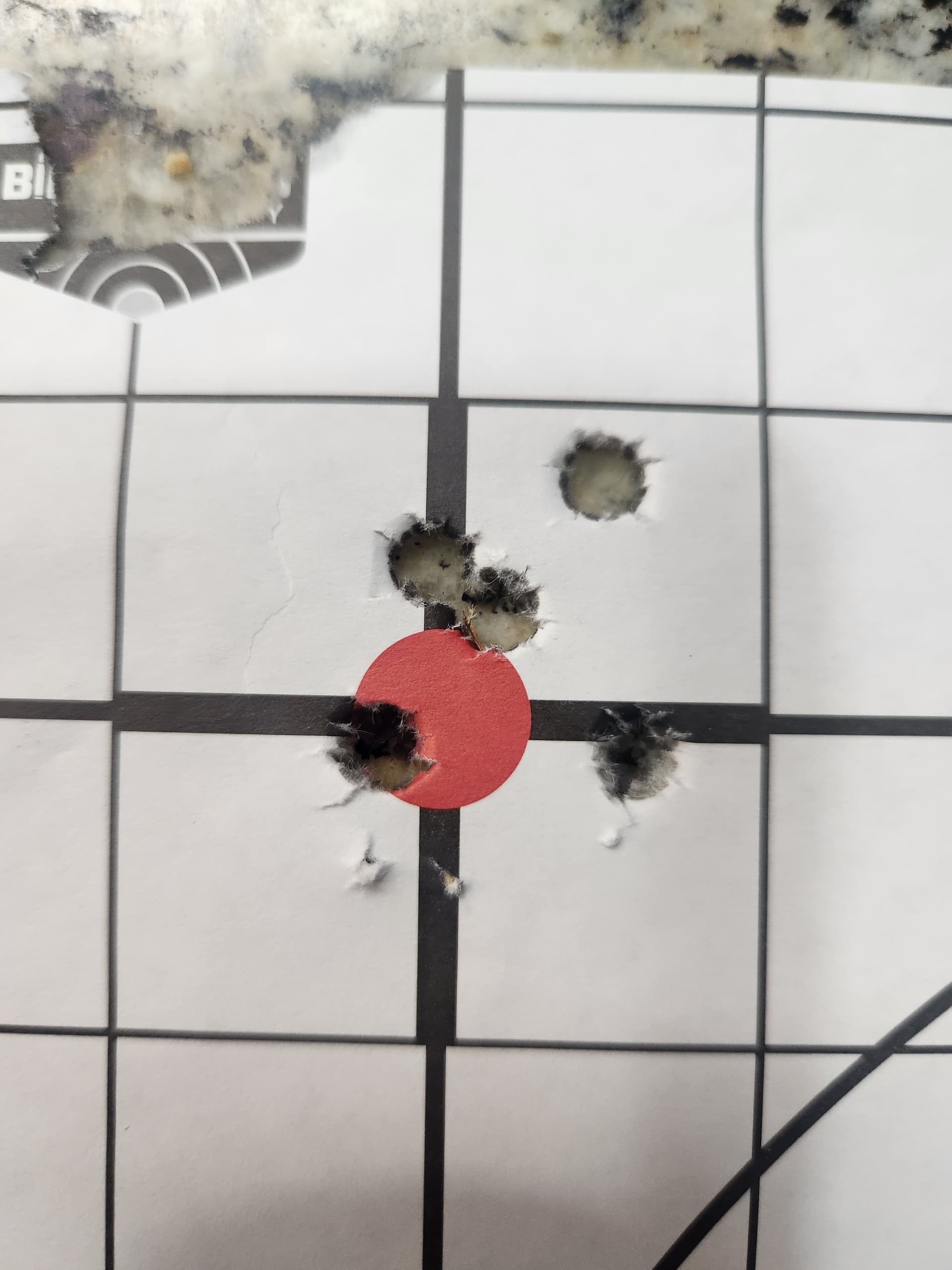

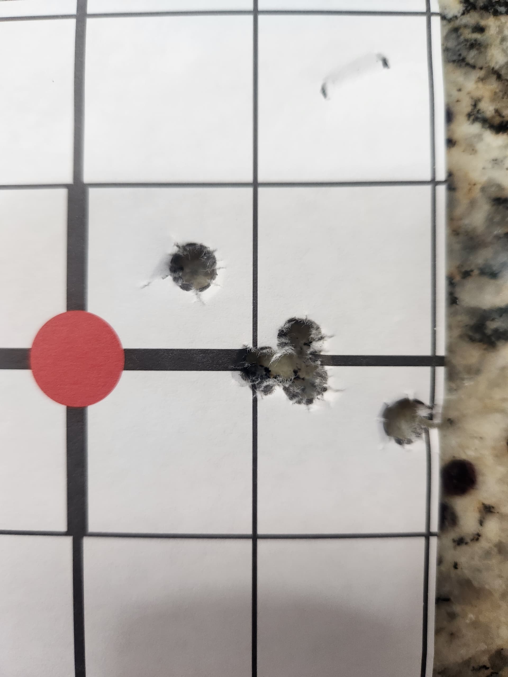

In fairness sakes, and for completeness, here are some less impressive five shot groups
I wasn’t working on load development. I was doing something based upon a recent post by Jim in the accuracy database thread. He mentioned how some triggers will pull you off of zero as you give them the squeeze. If I shoot this Tikka the way that feels the most natural to me, that happens and I can easily see the crosshairs going off roughly 1 in in any direction as the striker falls. Thus I was doing some variation with grip with my strong hand. The best groups were definitely done with them Absolute lightest grip I could come up with.
Going to have to do some more work with this. Not sure how that’s going to work from a hunting position not using sandbags with such a light grip.

Most of those still look like they are under 1”.
