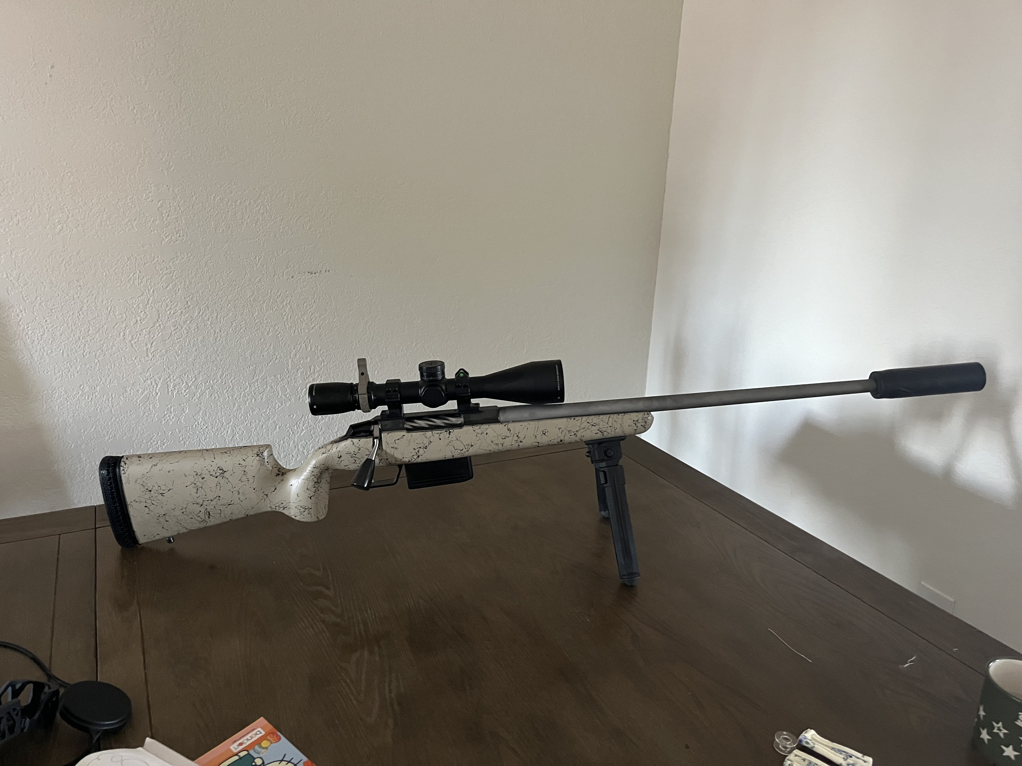

My tikka build…
Tikka stripped blued action from J&A (over priced actions+bolt)
Stock trigger from eBay
M*carbo trigger spring
McGowen 22” #4 profile 1-8 twist 7 saum
Ti magnum long action bolt stop OMR
OMR Ti recoil lug
OMR bottom metal
Mountain tactical magazine 2nd gen
Lumley mag release
Lumley Ti bolt handle with carbon fiber knob
High velocity hunting Australia Ti trigger bolt
High velocity hunting Australia Ti Action screws
Stocky stock vertical grip carbon hunter
Hawkins scope rings
Vortex Razor LHT 4.5-22x
MK machining throw lever (wish there were other options)
Banish back country can
Backfire recoil pad
Salmon river solutions arca+pic rail coming in the mail for bipod, etc.
Looking forward… action bedding
Is this too much? Maybe… but some may say it’s not enough. Does my wife understand? No, no she doesn’t. But it sure was fun to make and almost as fun to shoot.

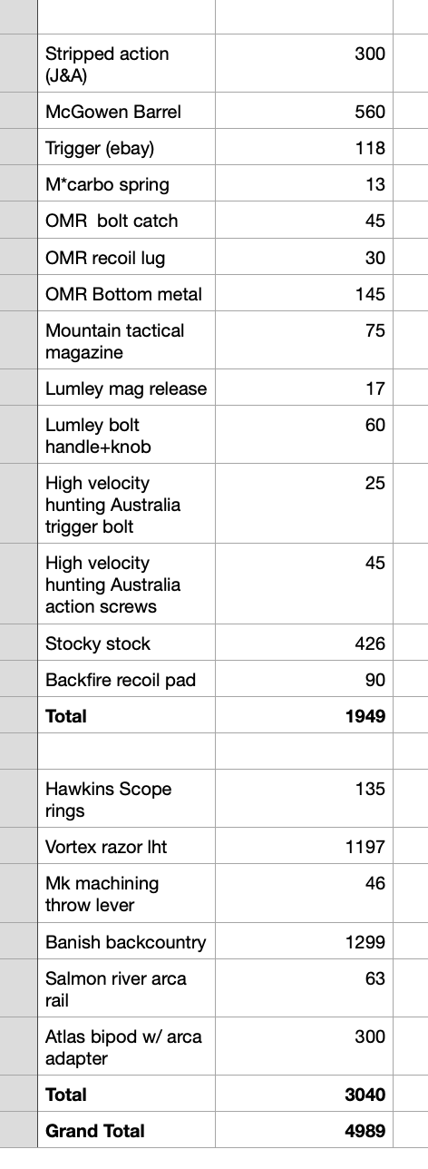

Nice, but how much did this set you back?
I can see creating something yourself has a certain self-satisfaction, but for the amount you spent on this, was there any alternatives off the shelf? Just curious to know.

I didn’t buy a bolt. I just share bolts with another tikka I have. I could have purchased a fierce rival in 7 saum for 2300. Otherwise, I would have had to go to a custom rifle maker which would probably be over 3500. If I didnt do all the upgrades, I could have got a tikka t3x off locked and loaded for 655 and then just rebarreled it. that would be 655 + 560 = 1215. Could’ve done a rem 700 build too for probably about the same, but I like tikka actions. I dont know. It was a fun project. And it is really fun to shoot. Down in Yuma where I go there is a fun silhouette range you can stretch out to 710 yards and a thousand yard range if you have your own targets. Hopefully I will get an AZ elk tag next year. Im 0/2 so far, lol.

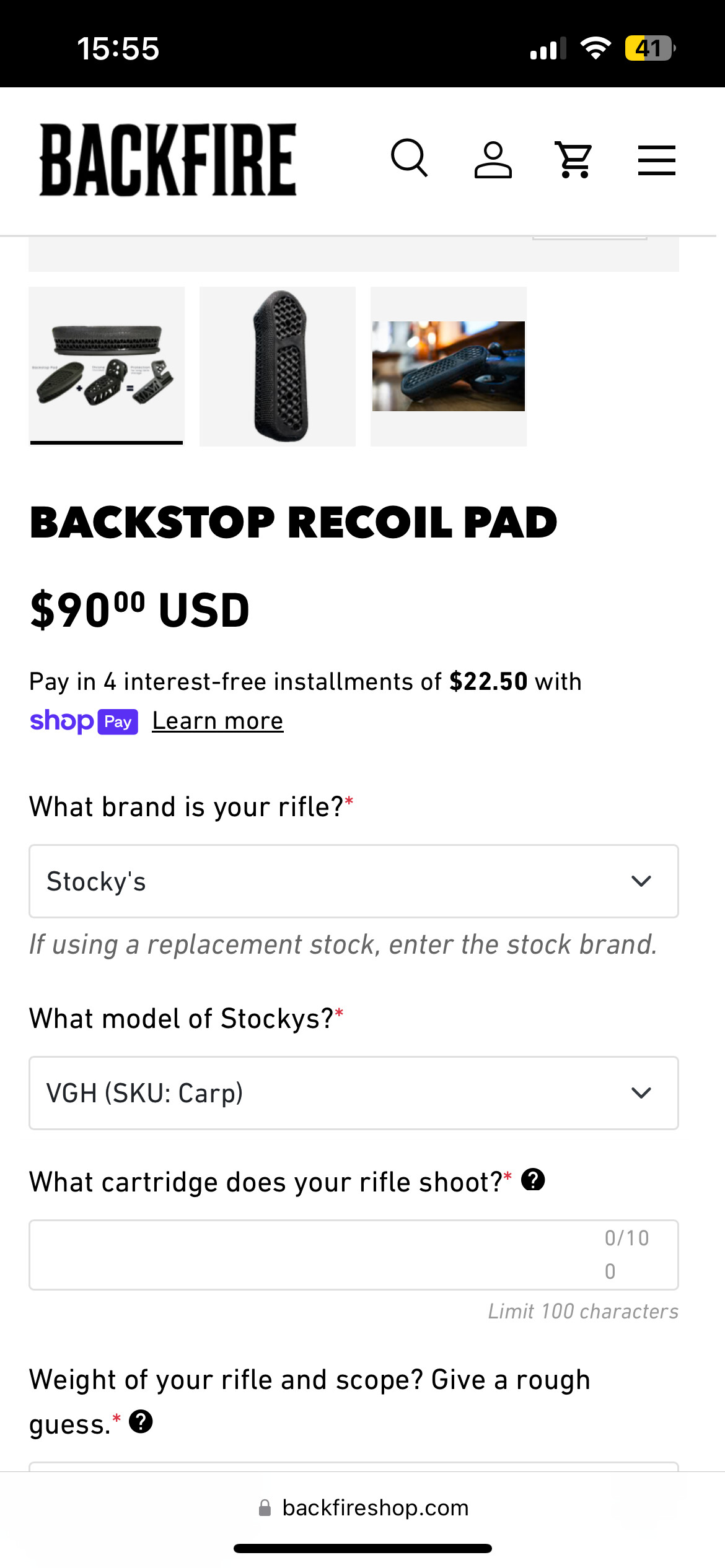

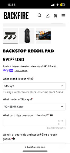

I also have a the vg carbon stock from stockys an want the backstop recoil pad what pattern fits it?
I wish I knew. At 10 bucks, it would be a fairly cheap mistake if you purchased it and it doesn’t work :wink:. You could also give them a call and see what they say. Good luck.
I don’t think we have that one. Is it glued on?
Have you tried gunbroker.com?
I believe these were my selections. It fits fine. Two screws from the thin limbsaver pad that comes with the stock worked with the backfire pad
