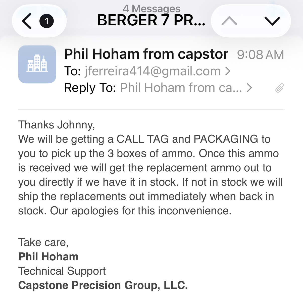

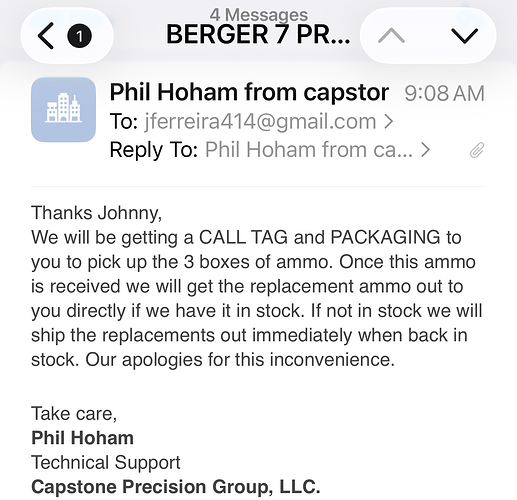

@backfire I emailed Berger and told them how slow their factory elite hunter was running. They agreed something was off, and here is their reply. Needless to say, excellent customer service.
That’s interesting. Glad to see they’re helping you out. For some reason I was thinking you were talking about a hand load with that bullet not Factory ammo.
