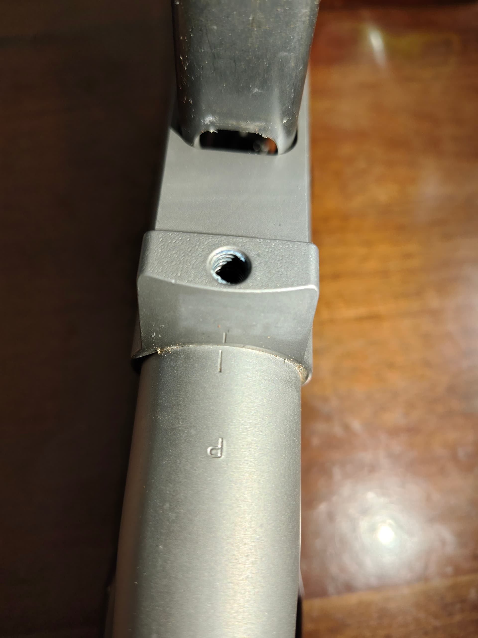

I noticed today that the barrel and action have markers on them to check if the barrel has come loose. These lines don’t line up perfectly, as in one edge of the line matches with the opposite edge of the other line, should they? I’ll get photos in the morning

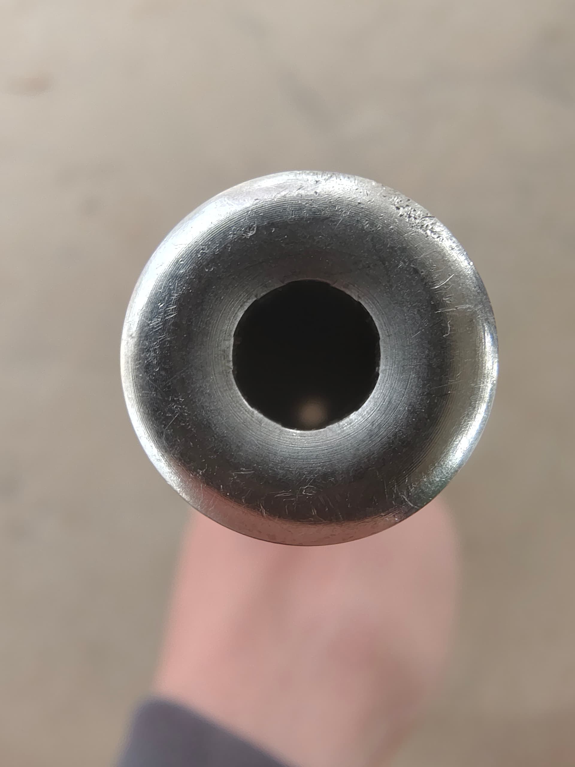

Curious to see if those line line up. Also could check the crown of the barrel for damage. Damage to the crown can have significant effects on accuracy. Maybe try a 100gr bullet since the 80s aren’t shooting well.
Righto, I’ll grab some 100 grainers sometime this week and give them a shot. I’ll send a photo of the crown and you can tell me what you think because I have no idea what to look for.
