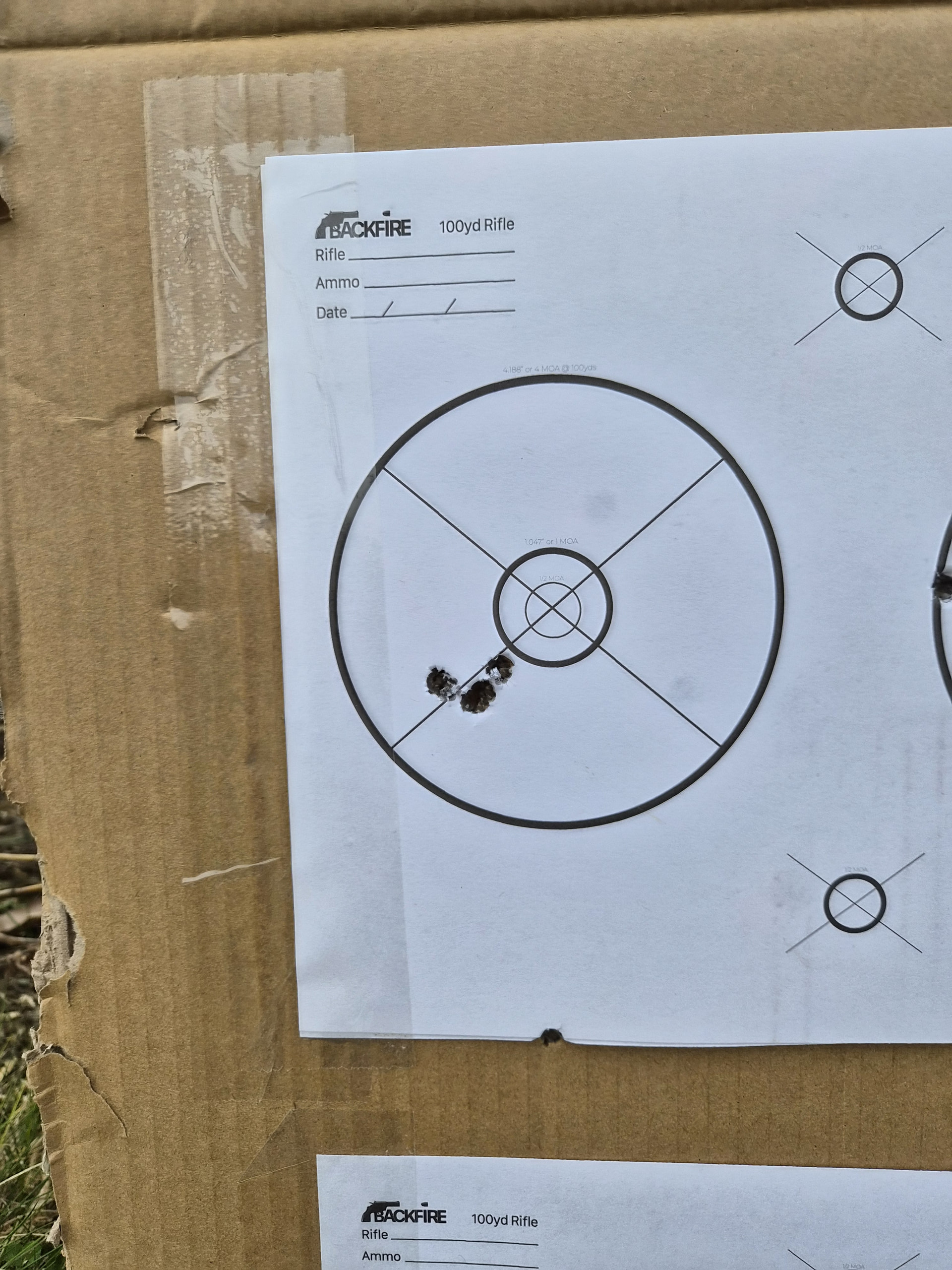

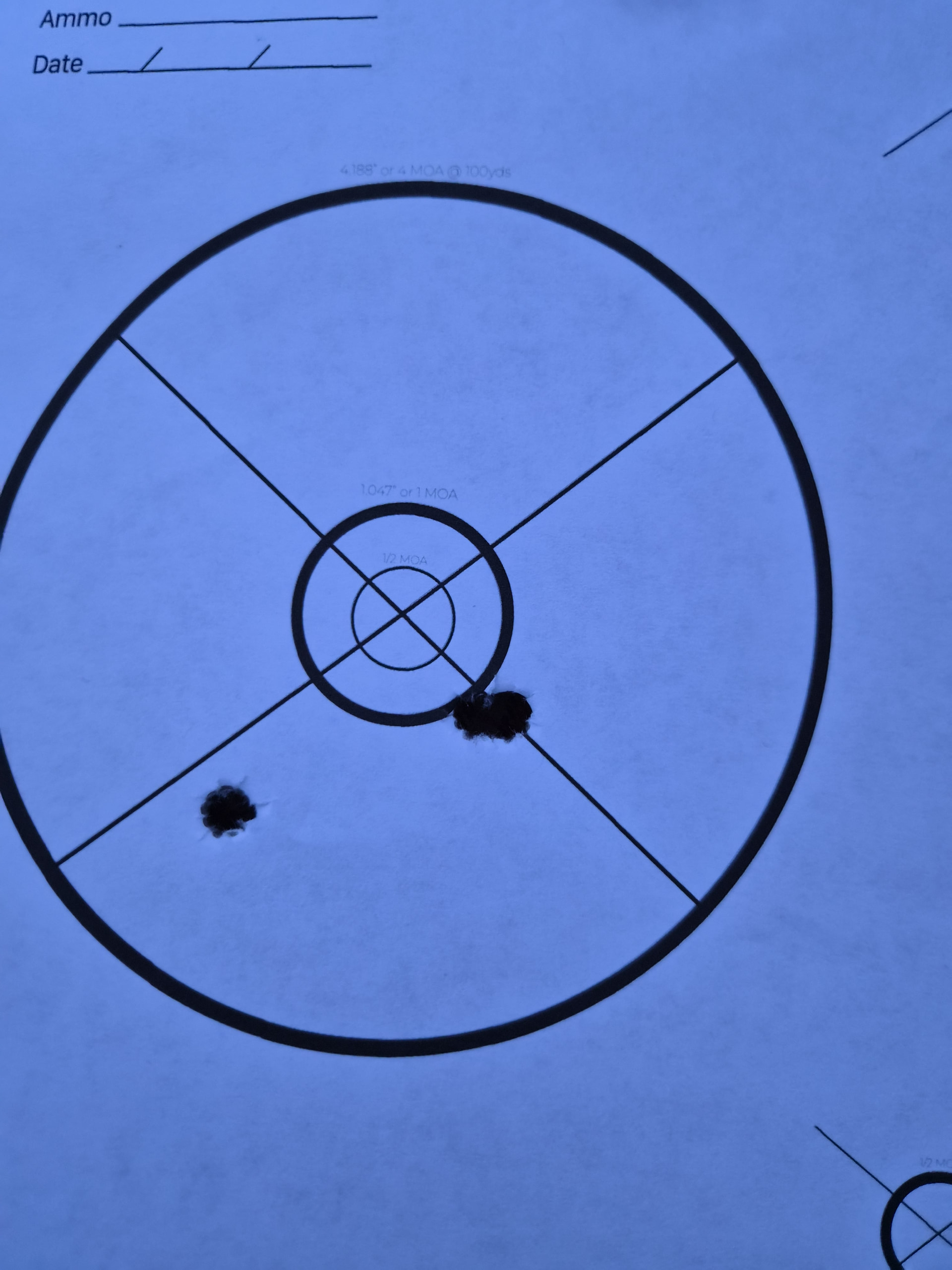

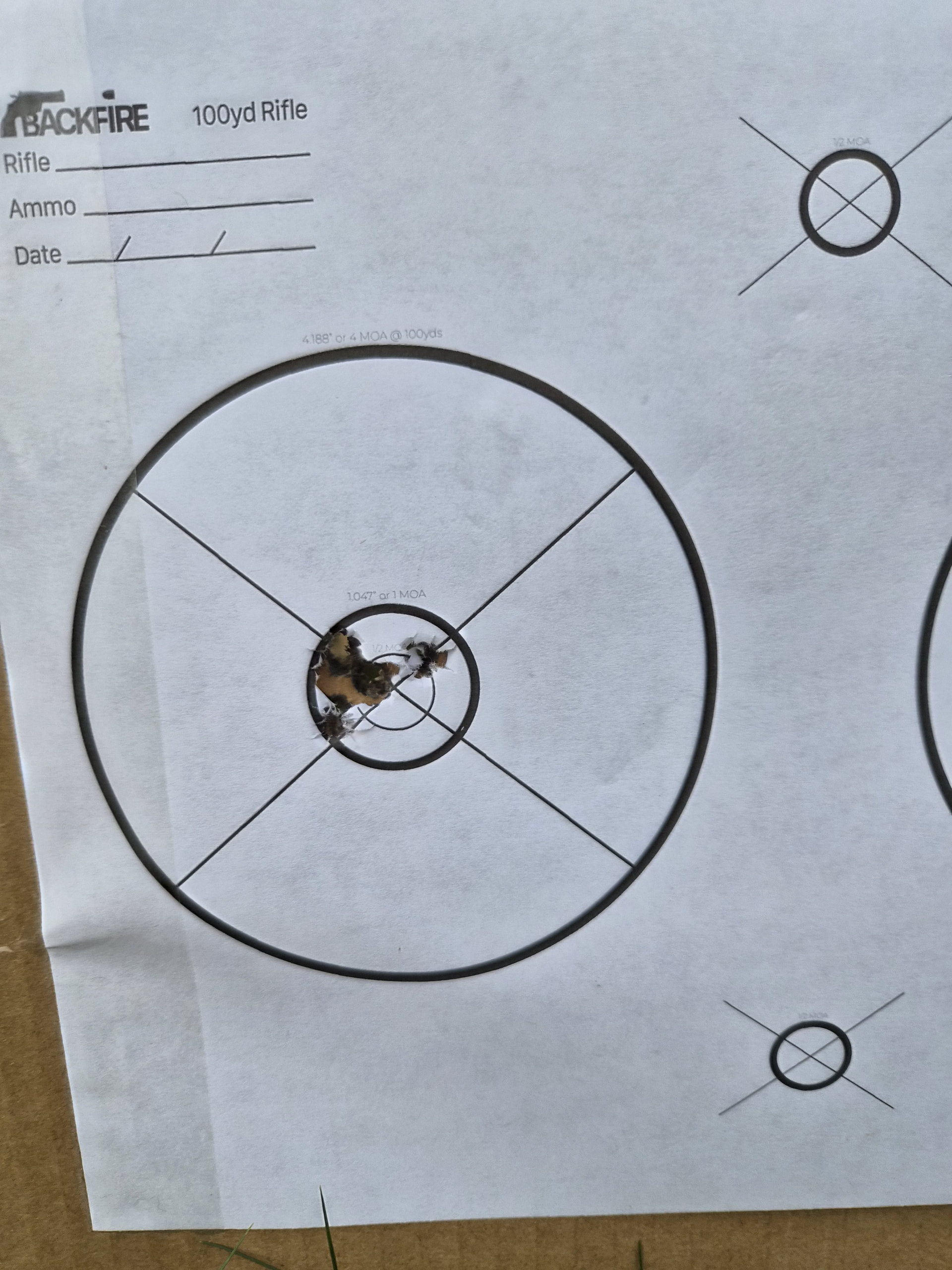

Just thought I would post the range results after the fix… Have to admit I’m starting to see why people rave about Tikka accuracy.! The first picture is my first 5 round group today. I adjusted the scope and sent another five after letting it cool, 2nd picture. Then I sent 3 at the 200 yard target (first two in the same hole).
