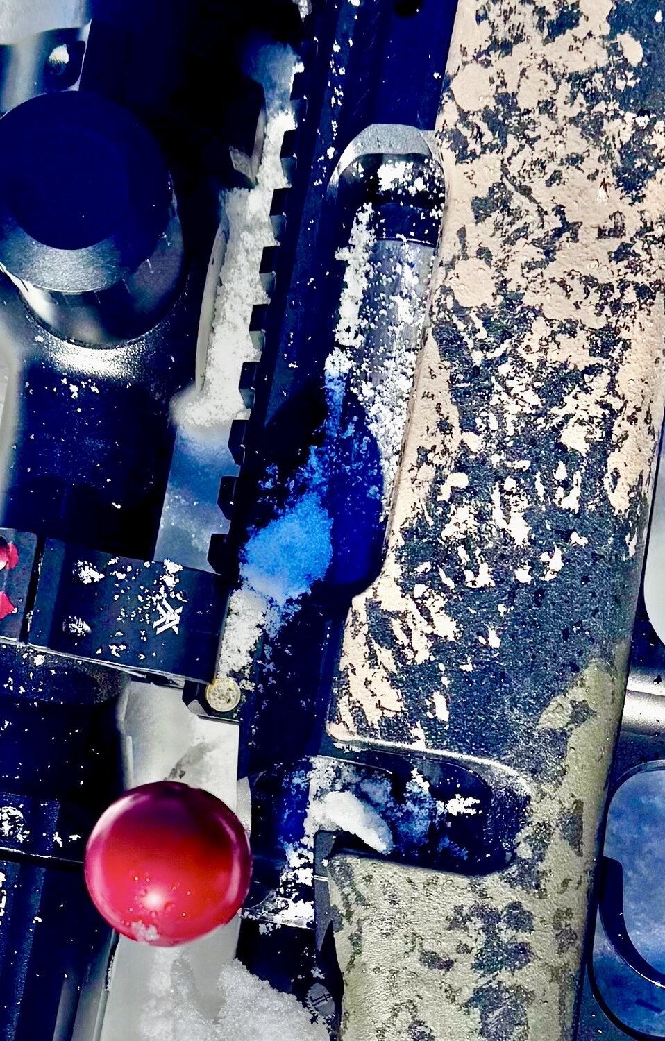

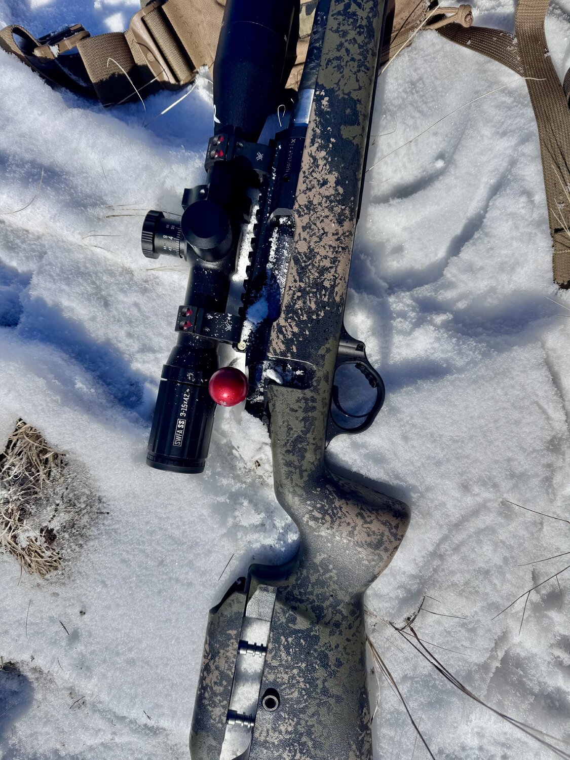

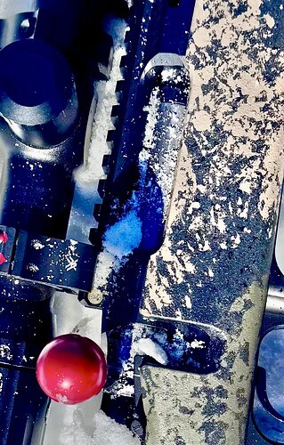

I know we have a lot of people here that really like Seekins, but I don’t know that I’d trust them after seeing them in snow. This is a sample size of 1, but I’d love to see if others have the same issue. This Seekins literally stopped functioning due to the amount of snow it got on it. That’s crazy.
What do you mean by stop functioning? Would it not fire? Did you leave it outside in the snow or did the issues come from just carrying it in the snow?
At some point I was planning on a seekins 6.5PRC, so definitely curious about your issues.
This was from a winter shooting class. Participants brought, “Mostly Tikka T3’s. 2x Remington based rifles/actions (1x Seekins PH3, 1x Defiance IIRC @WDO), 2x Tikka M595’s, 1x MRC Marshall, 1x Blaser R8 for a bit, and 3x UM/S2H Ravens”
“…The Seekins also got a bit of snow on it on for the first shot on the last day, and absolutely could not be chambered or fired. Cliff Grey dumped the tiny bit of snow off before shooting, and it still wouldn’t function.”
“…To put it in perspective the difference between the Seekins PH3 and other platforms, a Tikka T3, Raven, Sako TRG, and Blaser R8 were left outside all day and night covered in snow- and functioned with zero issues the next day.”
Again, sample size of 1, but I would be curious to know if others have had any issues. I want to be fair to the Manufacturer and also have transparency.

Were they shooting factory ammo or homemade rounds? I have read outfitter reports where a home grown version had too tight tolerances and when subjected to cold temps the difference in metals and contraction the home grown would not chamber so the client ended up using the outfitters ammunition.
Excellent point! I’ve been a reloader since my early teen years and only recently begun to understand the point of and value in bumping the shoulder .001-.002” for this very reason.
