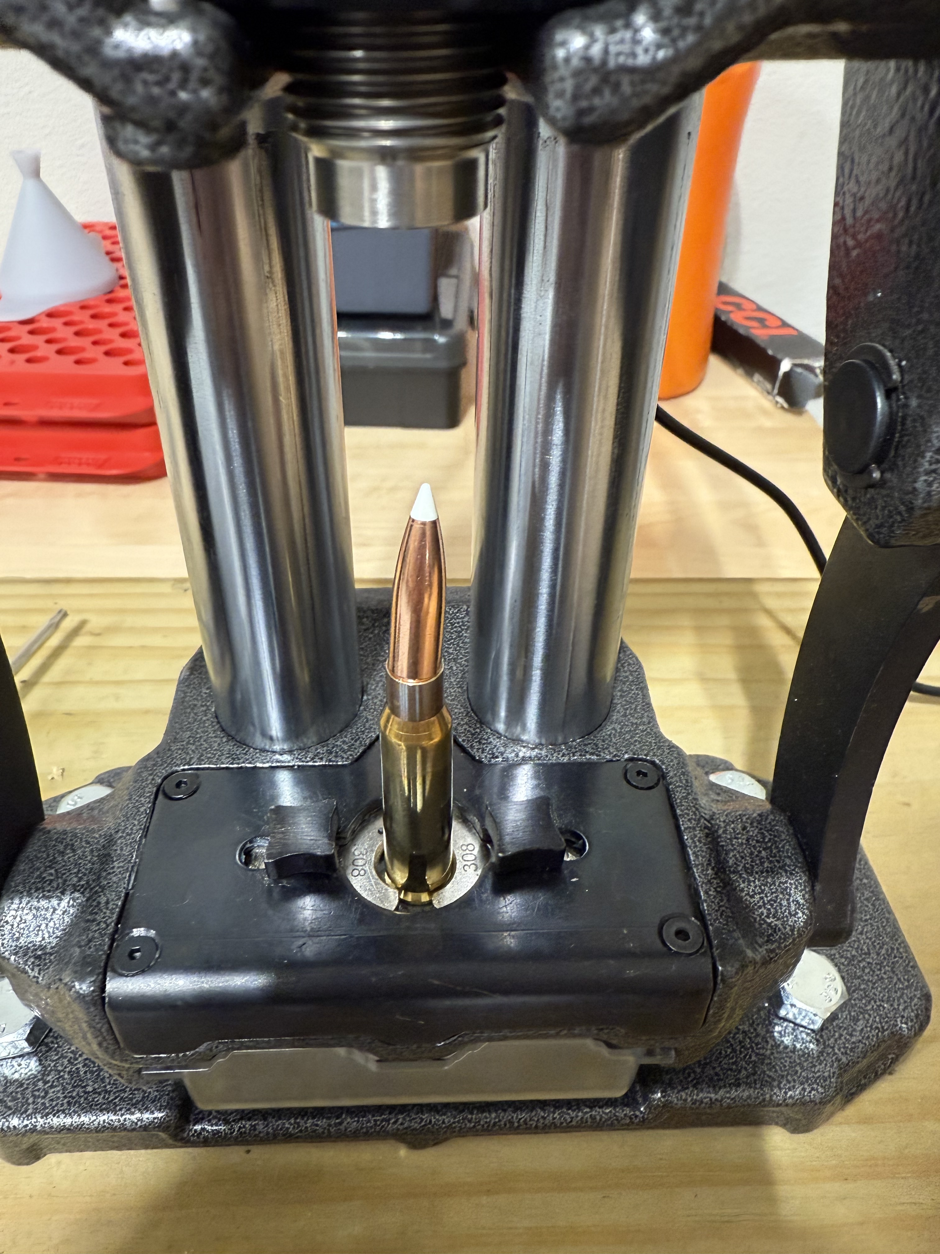

What do you mean by sit on top? This is new 308 Lapua brass. Can you not get the bullet to sit like this? It isn’t always perfectly straight, but you can guide it up and then let the seating die straighten it out.

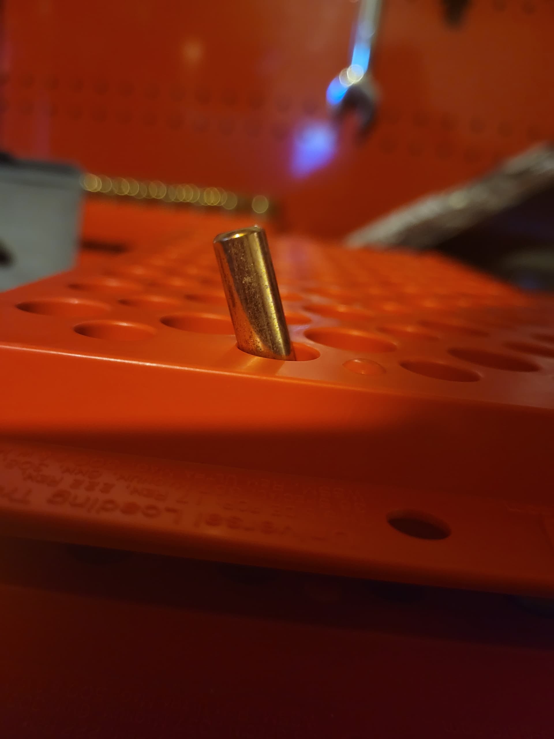

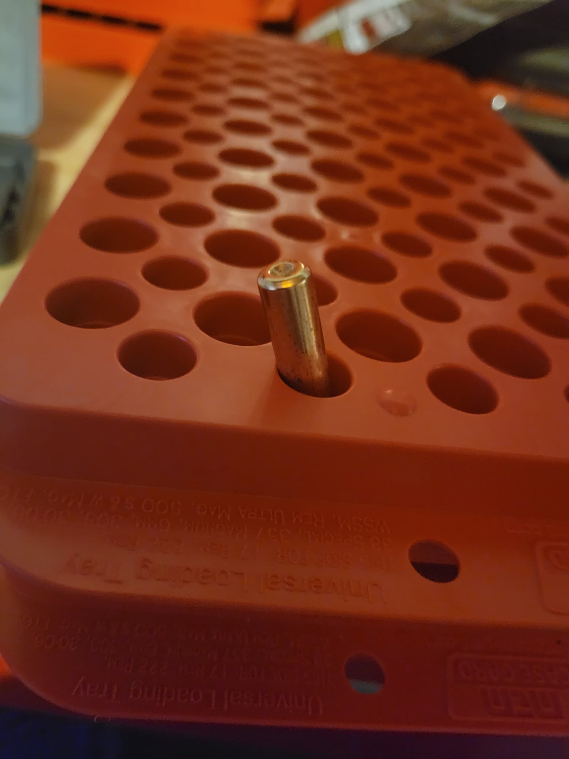

I mean that without me holding it on top of the brass, the bullet will fall completely off. And, no i can’t even get the bullet ti sit like in the picture.
This can happen if the bullet shape is flat on the back instead of a chamfered boat tail. When I encounter this type of bullet I usually hold the bullet on the neck of the case as I raise the ram up into the die. Once it’s in the die then it usually works out.

Interior diameter of the brass is 0.1 mm less than the outer diameter of the bullet
I always size my my brass and inside and outside chamfer them
Have you tried pressing a bullet onto the case, or does it just feel off? .1mm difference is .004 (or) 4 thousands. It’s a little tight but it should work. Your bullet has a slight chamfer on the back which should help guide it into the mouth of the case.
