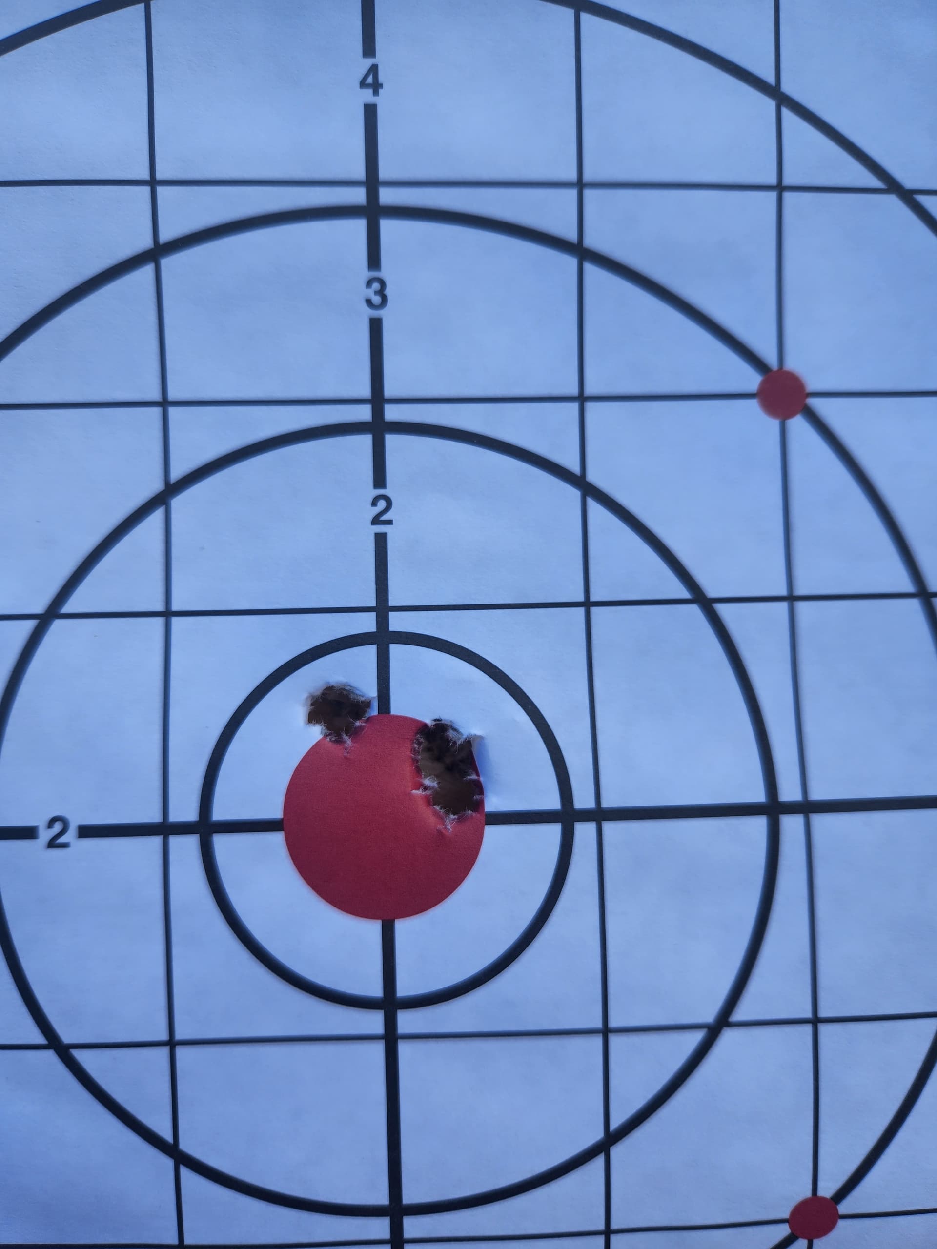

So yesterday I went to the range for some load development testing for my 28 Nos. Since that gun heats up so rapidly and takes a while to cool I decided to take a second gun to do some testing with during the cool down. Given all the recent talk of the 7 PRC I decided to take mine. It’s a Seekins Element, and the ammo I took was from Choice ammo with 168 lrx. (recent discussion of Choice on a thread here not too long ago)

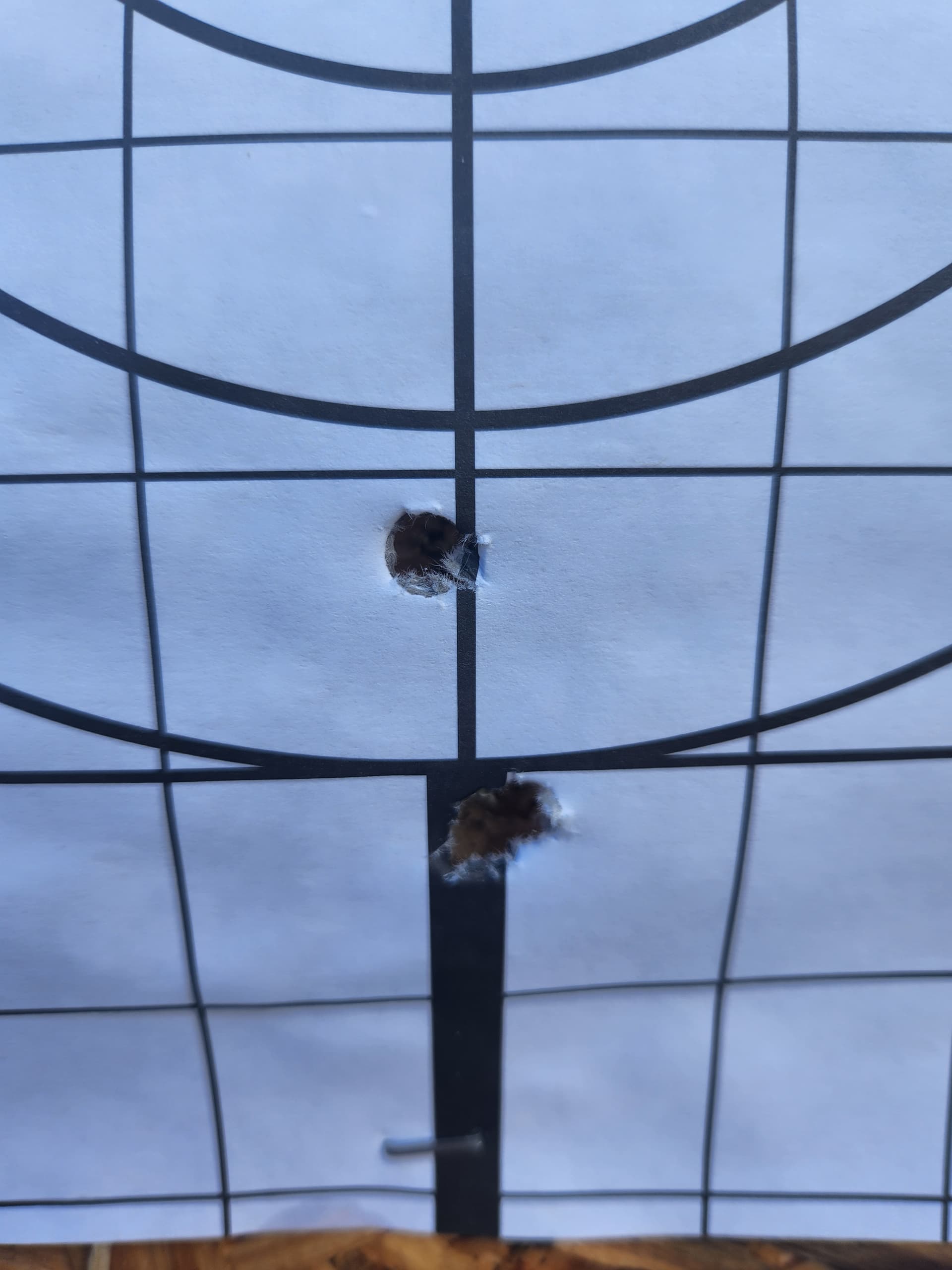

Here are two pictures of the groups I was getting. 3-shots each.

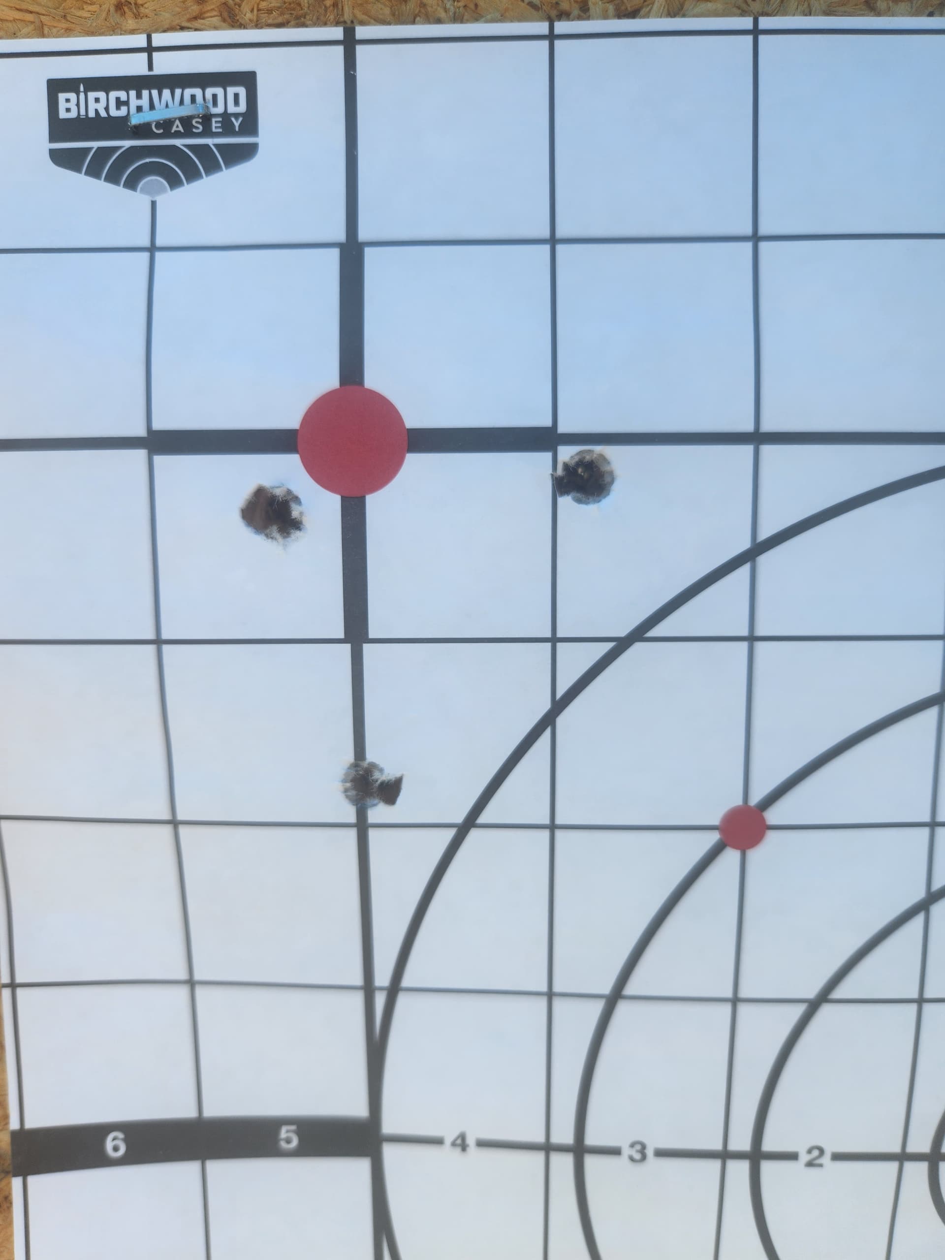

First three shots.
Wow, still fairly tight but obviously significantly off in elevation and windage. Let the gun cool completely and fired three more shots and got basically the same result.

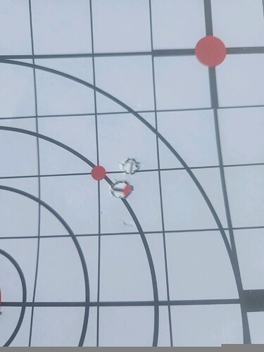

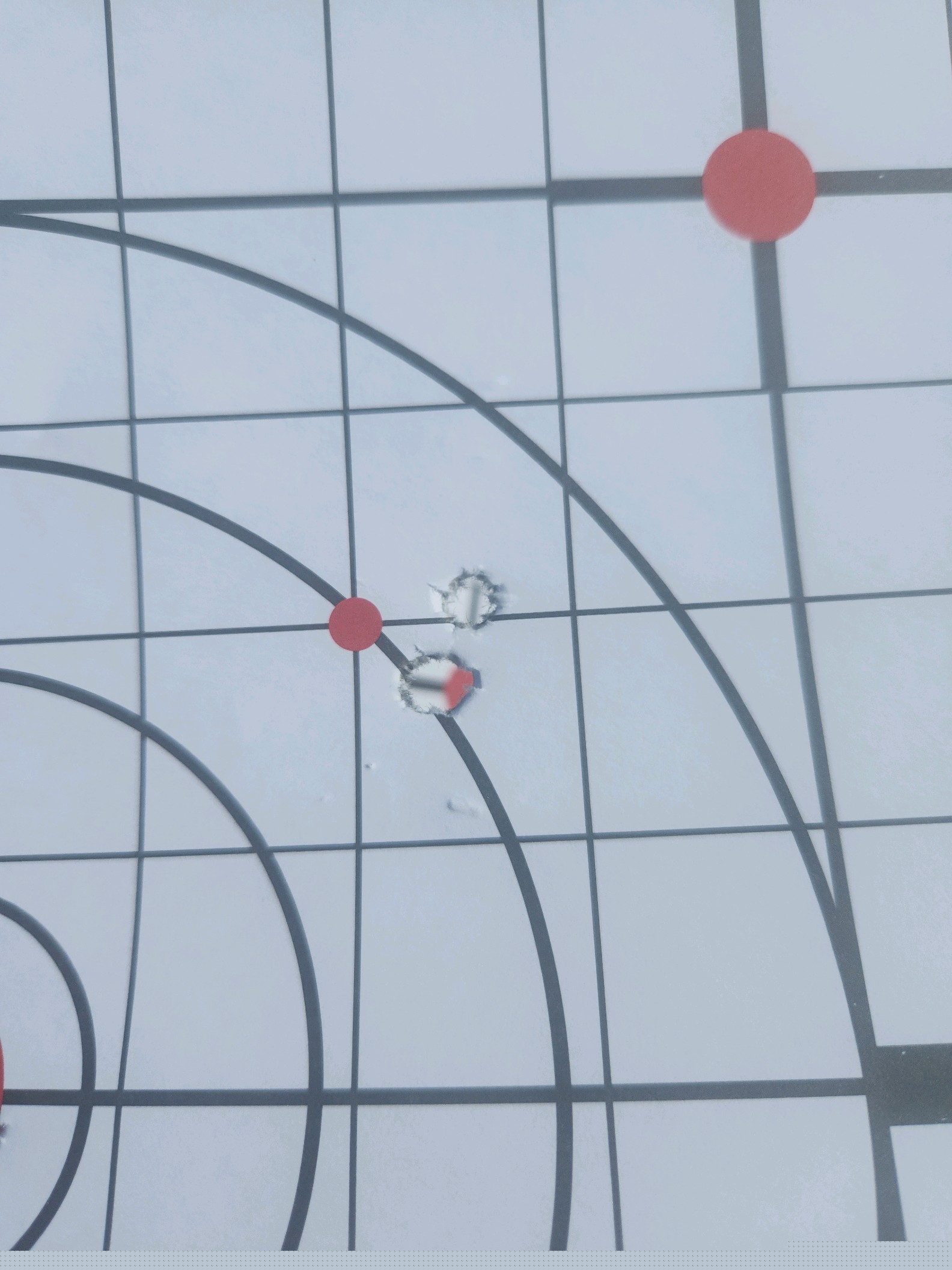

So make the adjustments on the turrets and then I get this after cooling again.

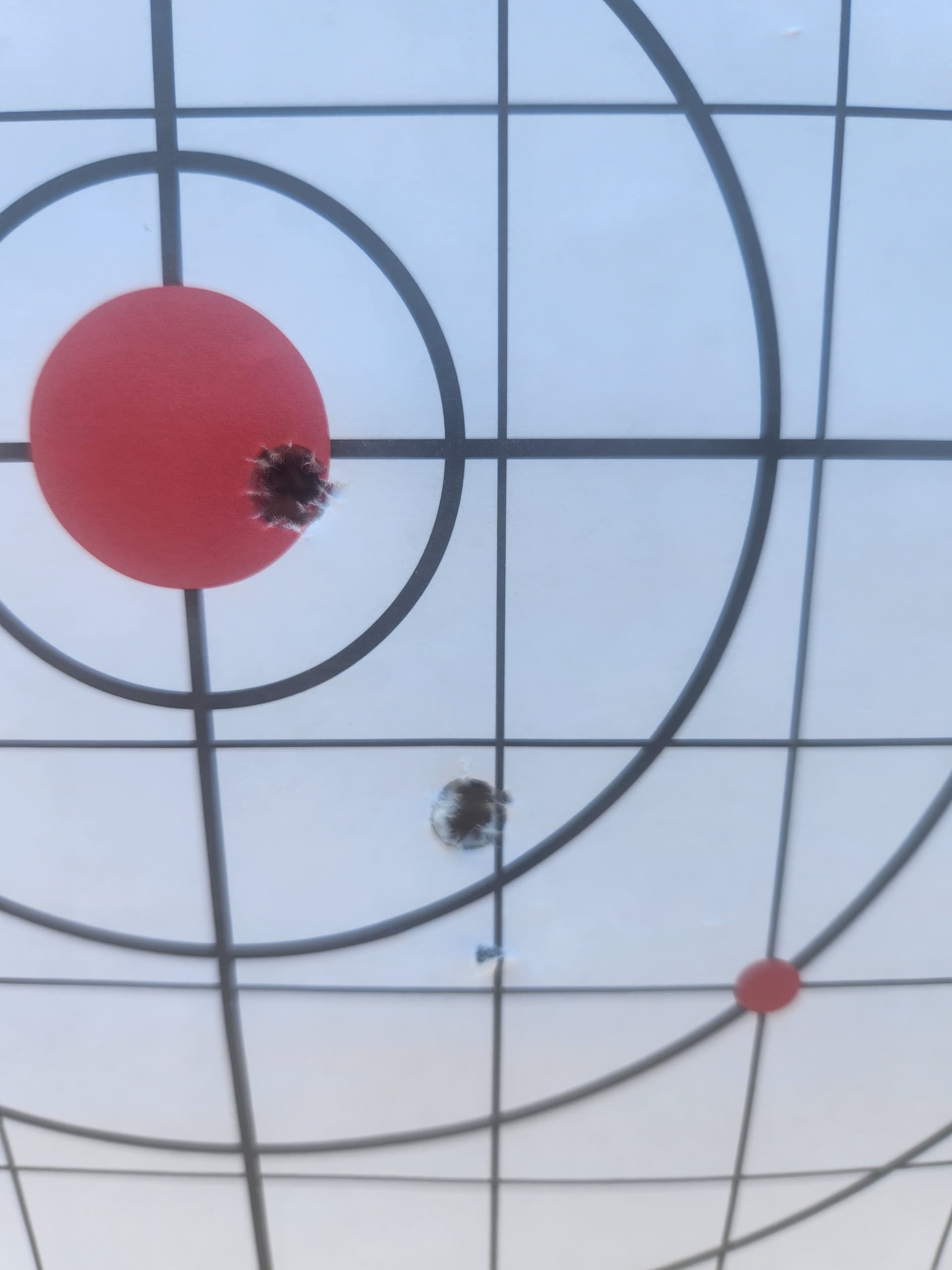

Let it cool completely again and try it again and got basically the same thing, don’t have a picture of that one. Fired my last two shots that I had and got this
Took the gone home. Base and ring screws were tight. Didn’t think about action screws until right this very minute.
I’m a little perplexed because I would have imagined that if I had done significant damage to the gun I would not have gotten two separate three shot groups which were fairly tight back to back immediately. Maybe something in the scope that was initially okay but then adjusting the turrets and or repeated recoil knocked it loose??
