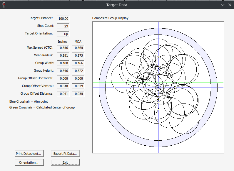

Use software like ontarget to overlay multiple 5 shot groups and determine true zero. I would still zero at 100 to avoid issues with wind.
The other thing they failed to address in the podcast is that your POI will wander as you shoot from different positions and there’s nothing you can really do about it. The effect only really starts to manifest when you’re already splitting hairs.
How long have you been using on target? I downloaded that many months ago, probably over a year now and it’s never worked on my PC at all
Few years; I got it running with wine under linux so afraid I can’t help you there :rofl: . I have a personal project to make an open source replacement but I need to find time to work on it more.
