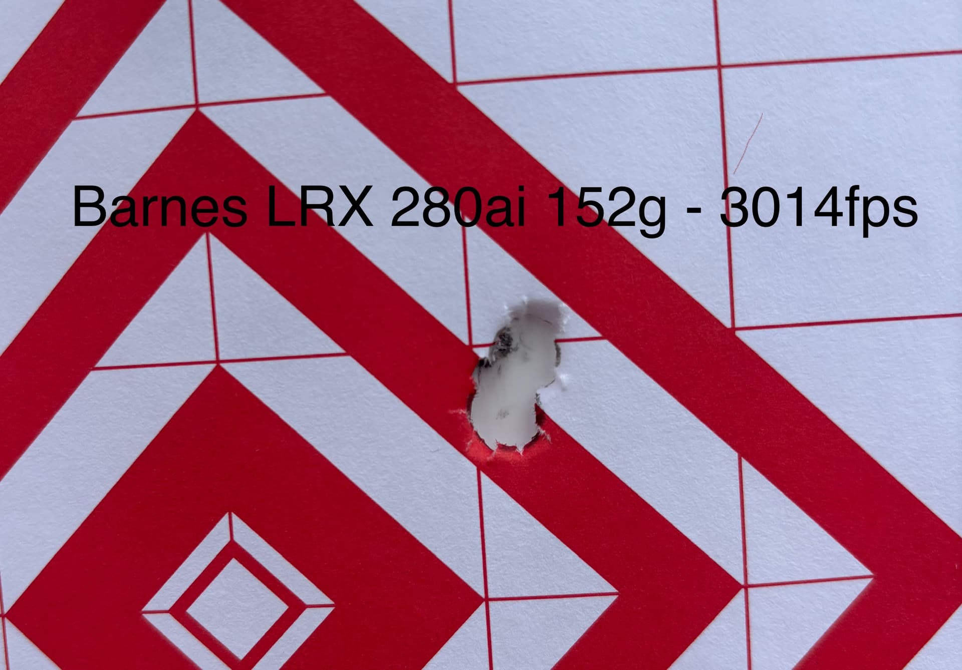

I have 5 fierce, one being a twisted Rival in 280ai. Phenomenal gun. I’ll post a pic of my group when I tested ammo. 2 of my fierce rifles had issue, sent both in to fierce and had both back within 2 weeks, one with a new barrel the other with a new bolt. Both were sent back with a target showing groups and ammo. There’s a reason I keep buying them.
Barnes LRX - only a 3 shot group, but about .25 moa
Factory Barnes LRX or handload?
Either way, impressive!
Here’s the info on that build 280 Ackley Improved Rifle Build – Backfire
Yes, factory LRX 152g
Thanks for sharing this. I just grabbed a tikka T3x on sale for $700 to use as my action for a 280ai build w your chassis.
You can buy the 152 as a component bullet now. But darn, if Factory ammo is shooting that good I don’t know that I’d bother.
I don’t reload, so pretty excited how well it shoots.
