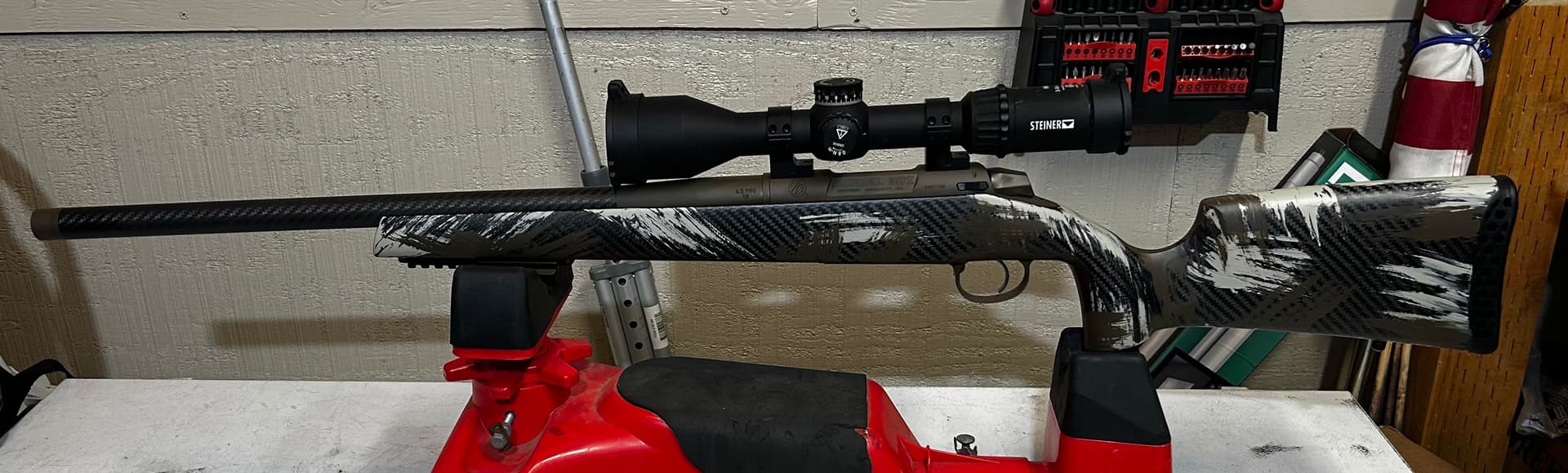

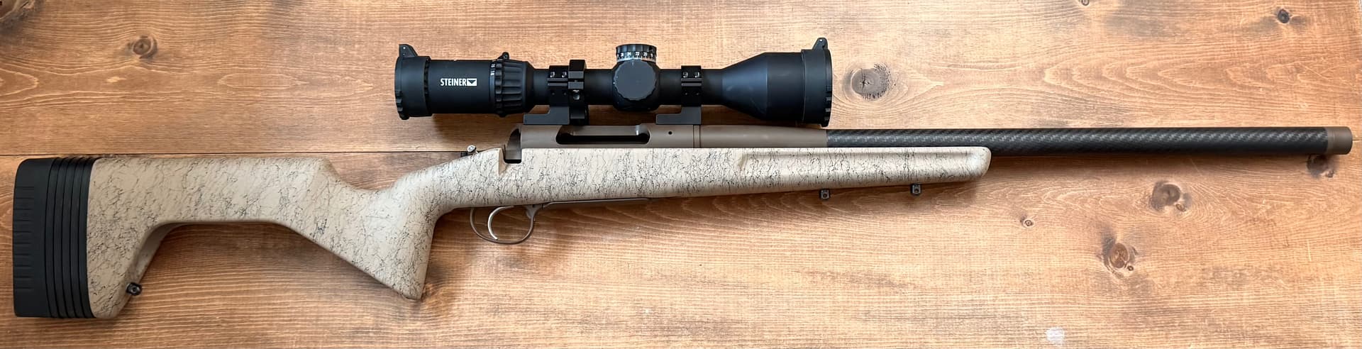

I have the Weatherby 307 Alpine CT, the BSF barrel is awesome! I have friends who also have the Springfield Waypoint with the same BSF Barrels and they too shot lights out…. I’ve easily have put together long strings at the range w/my CT with 0 barrel heat issues… BSF says there design on there barrels he’ll keep the barrel cool and I’ve never really felt like it’s ever overheated.
My bitch about the 307 and the CT…
90 deg bolt throw…. If you run a bigger Objective lens scope, you don’t have a lot of clearance, I originally had Med height rings and had to go to High height rings just so the bolt would clear the scope which it barely does.
2nd is with Peak 44 stocks, there comfortable but unless your built like Adam Weatherby 5’4” you don’t have much stock to work with as they are all fixed 13.25” length of pull and “0” options to extend it out.
My CT before
MY CT currently
Yeah, about the only complaint I’ve ever heard about that Peak stock is the LOP.
Does Jim make a recoil pad for it? Wonder if there’s any way we could convince him to make it specifically custom to not just be the recoil pad but add in some spacers in order to lengthen the stock.
Backfire does not make a recoil pad for it… I had many of emails w/Peak 44 on options and there really isn’t any except for a slip over type of stock boot…there recoil pad is glued on and if you look at there stocks there’s a slight 1/2 moon thing going on so that you can’t go aftermarket as nothing will fit flush on it. so I’m selling the stock and went with a Grayboe
