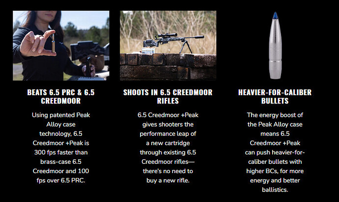

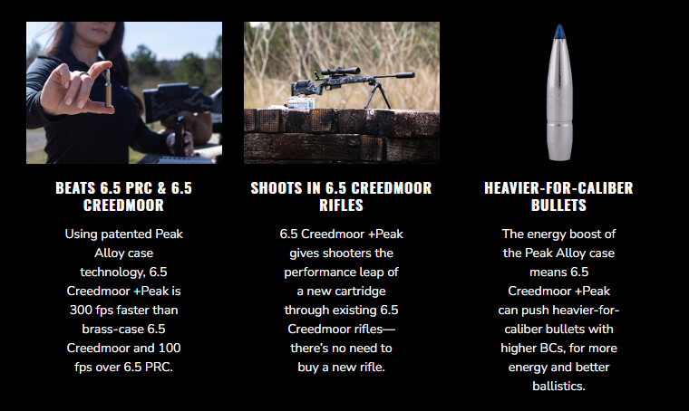

from the federal website:
And it reloadable :slight_smile:
Should be good for the sig cross 18” barrel if it will group.
Haven’t watched any of the videos or information yet, but I’m really surprised they didn’t stick with the Backcountry naming convention.
Just read Ben’s post from Federal. You can shoot it in your normal 6.5 CM rifle?? Wild.

I’m going to be Mr negative. The 6.5 Creedmoor +Peak’s main “point” is velocity: same external 6.5 CM dimensions, but Federal loads it to 80,000 psi using Peak Alloy cases, claiming up to ~300 fps faster than standard 6.5 CM.
That makes sense if someone wants more reach/energy from an existing 6.5 CM rifle without moving to 6.5 PRC. But the tradeoff is likely throat/barrel wear, because pressure and velocity are way up. This has yet to be discussed. Maybe this where a PROOF’s PXT barrels become relevant: PXT is marketed as reducing rifling lead angle/engraving force and improving barrel life/consistency under higher-pressure loads.
300 fps by itself doesn’t magically make a 6.5 mm bullet behave like a larger-caliber elk bullet. For bigger animals, I’d still rather step to 6.5 PRC / 7 PRC / 7mm Mag, 300 win mag etc. than a Creedmoor that appears to have some of the same issues as a 7PRC. Unless I specifically wanted to keep the same rifle. I will concede it extends the effective range envelope of the same bullet while keeping the same rifle and magazine. Also agree that someone is going to be stupid. Kind of surprised that this got past the attorneys. Just my opinion.
From the GunsAmerica video, he claims that Federal said that the Peak ammo will not increase the wear on the barrel, but we’ll see. That was my first though too, that barrel wear would increase. Ultimately for me, this is non issue.
