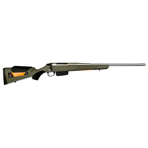

I don’t know of any coming imminently. Big holdouts are Bergara and Tikka and they don’t seem to be in a rush.
Tikka still doesn’t make a 300 PRC.
They probably aren’t in a hurry
Tikka may not ever make a 300prc because it doesn’t fit in their action.
Isn’t it the same length as a 300 Win mag?
Max COAL for 300 prc is longer than 300 win mag.

I thought Tikka does make factory 7 PRCs, we can get them here, and usually we are the last to get anything like that. Unless I’m missing something.
