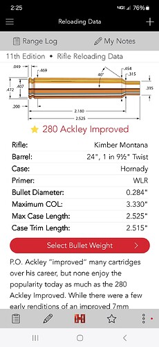

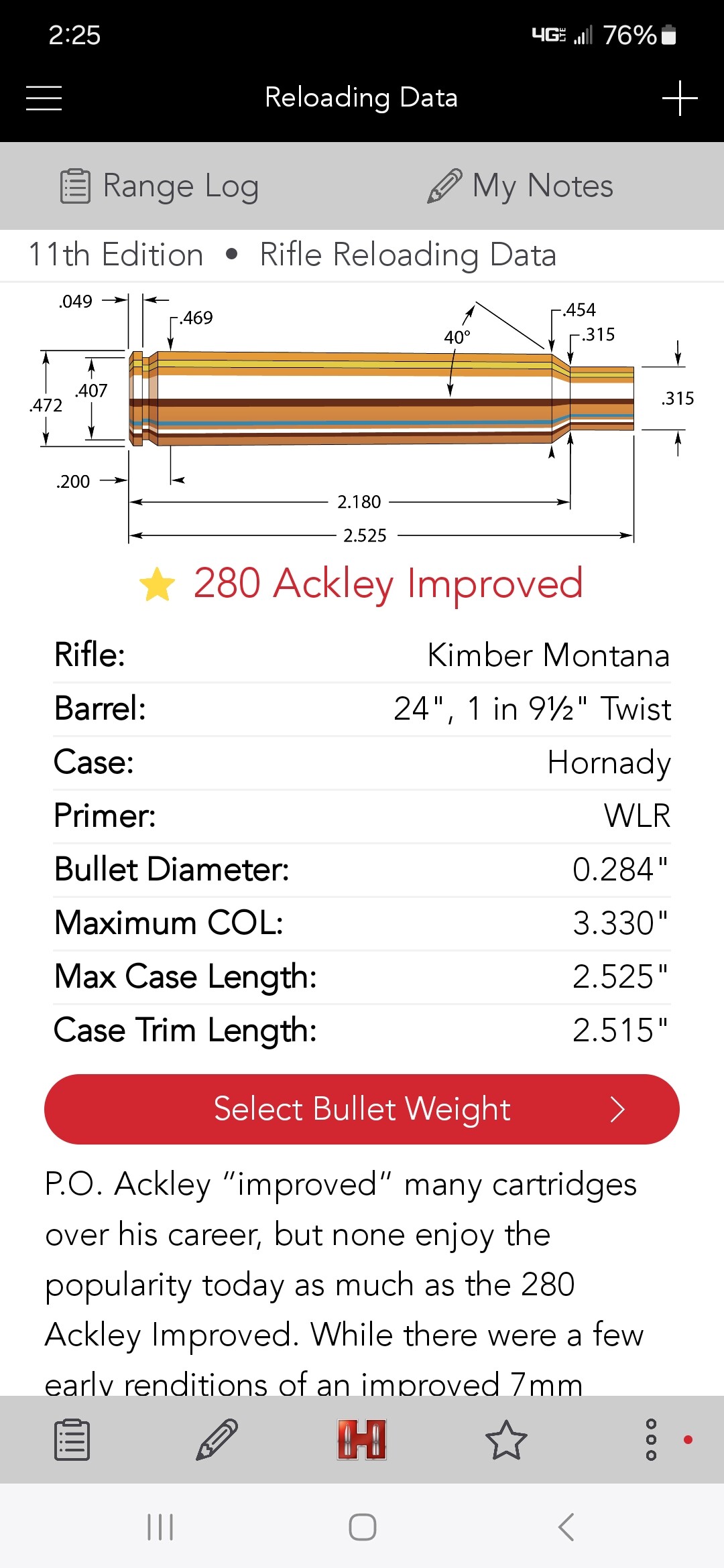

Does brass need to be all trimmed to the exact same length? Or do they just need to be under max trim length? How do you determine how far under max trim length to trim to?
Many reloading manuals will have a “trim to length”, or case trim length.
Just trim to the trim to length. As long as it’s below that length, I don’t trim at all.
Depending on the shoulder angle, it’ll likely be like your 3rd firing when you have to trim.
Mine has a trim to length but not a max trim length. Its for barnes bullets
