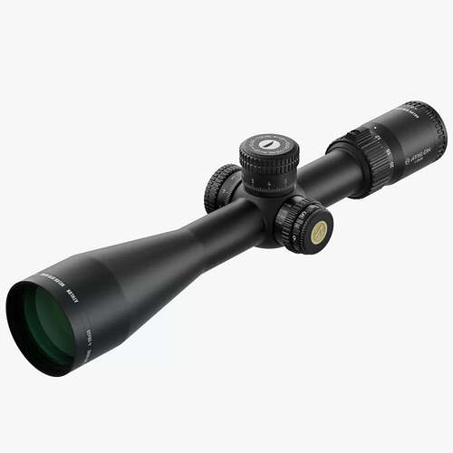

I’m going to be ordering my first scope with a turret dial but not sure which unit to use. The scope I’ve chosen is the Arken EPL-4 6-24X50 FFP Illuminated VHR - Zero Stop - 30mm Tube. I know nothing about MIL and barely anything about MOA but I’m willing to learn either. So which one is better for hunting?

have 3 Arken scopes and you might consider going with the “J” glass. It is Japanese glass and I really like it. SH-4J 6-24X50 FFP Illuminated VHR/VPR - Zero Stop - 34mm Tube

For about the same price, you can get the Athlon 4-20. Its form factor and zoom range is suited much better to hunting, and the glass is a big step up. Everyone has their own preferences, but I own both those scopes and I’d pick the Athlon every day of the week.

Are you saying the Athlon has better glass than the Arken? Kinda qurious?
