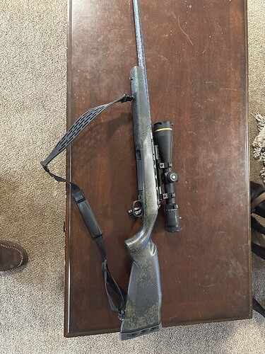

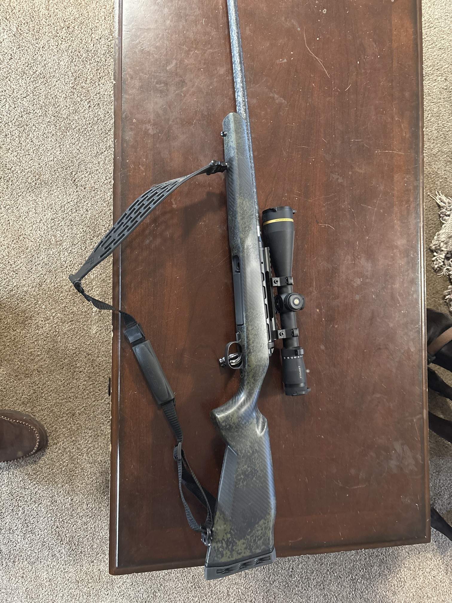

I just added a CF stock to my 110 UL 7PRC. The stock stock is pretty light. My CF stock is certainly more substantial and stiffer. Have not shot it yet but I like how it feels. The question is what do you get for $2K ish compare to that cost of upgrading the stock on the Savage. I have had the rifle for a couple years. I have $2K plus optics and mounting. The optics mount was $200 or so. Have to use a pic rail. I tried rings direct by not enough distance in receiver to set a scope properly- I put a VX6 3-18x50 on it. I upgraded the bolt knob as well.
So if you can find a rifle with CF stock and CF barrel at the $2K mark and it has a better action then go that way. I am happy with mine so far though.
Looks sharp. What stock is that?

The stock is the VG2 CF from Stocky’s. Christmas sale was less that $500 shipped. Otherwise $600 now. I got the carbon olive color. It fits great. I think the only problem would be it uses factory mags if that is even a problem . Spare factory mags are hard to get and an aics type would be nice. But for hunting it is flush fit. So it is ok.

I was wrong about stock type. I got the M50 type.
