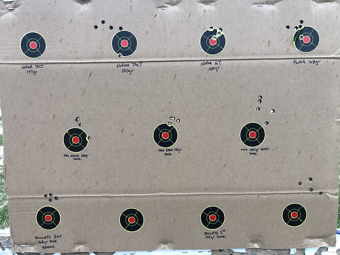

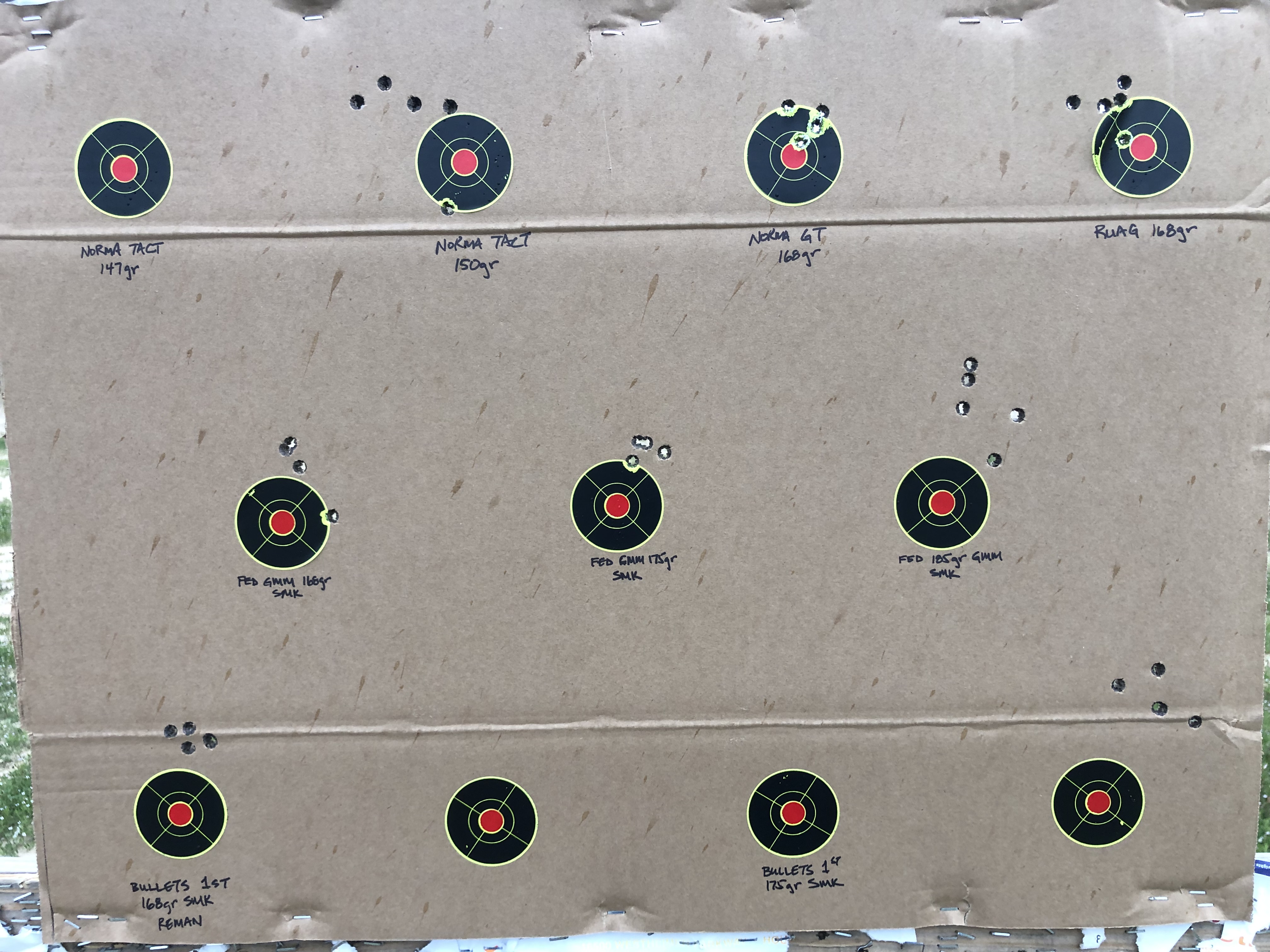

Here are my results with my Sig Cross 308 and various factory ammo. This was before I put an EC tuner brake on it which tightened up the groups:

The group pictures help.
Well, looking at the photo.
  1. If you take the paster (1 inch?) and extend its boundaries up from the middle of the red center, it looks to me like…
  2. 168 grain bullets grouped 14 of 15 pretty close to 1.0, with 1 flyer at the 3 oclock but that probably only adds about 1/8 to the overall spread.
  3. Add the 175 GMM and you are at 19 of 20 in that group size…
  4. If my estimate of the paster dimension is accurate, then I would say that the weapon is shooting fine for a factory rifle.
  5. From here, if you can reload, then tune something in a 165-168 btip / amax / eldx / barnes ttsx, and a 178 Eldx. It would surprise me if you cant get a good hunting load out of one of those combinations.
  6. Remember some of Jim’s reviews earlier where he spoke about how companies measure group performance; a three or even five shot group once does not really give a shooter what he wants; having a weapon repeat those groups to the same POI is what we need to get at consistency, accuracy, repeatability for hunting.
