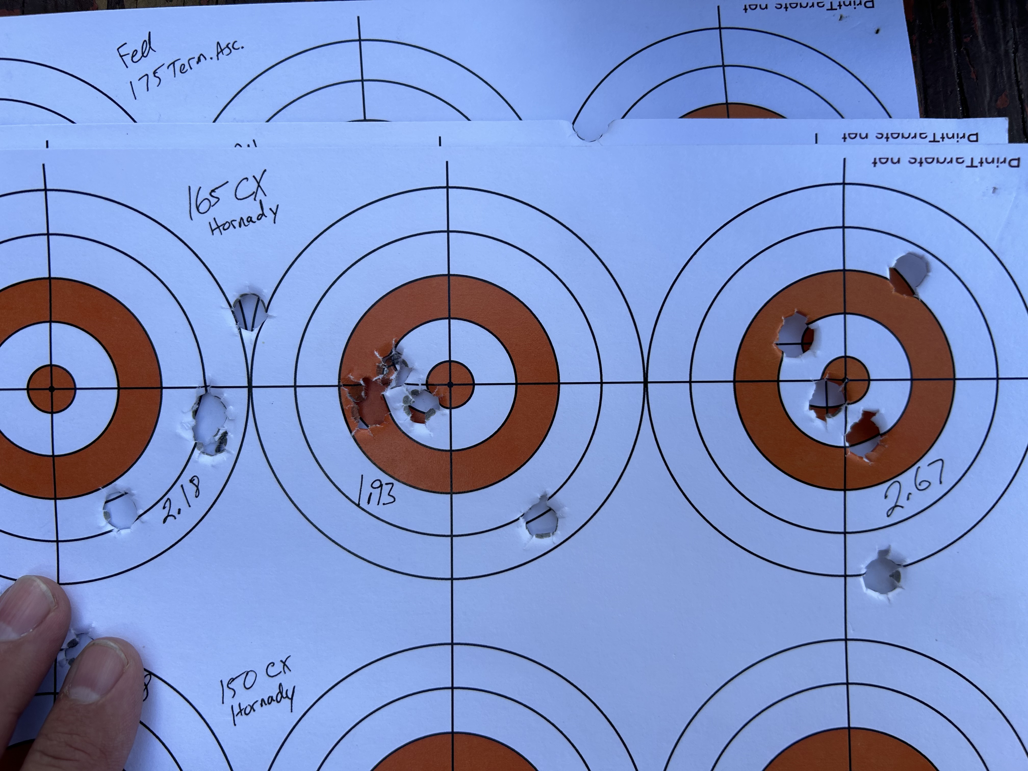

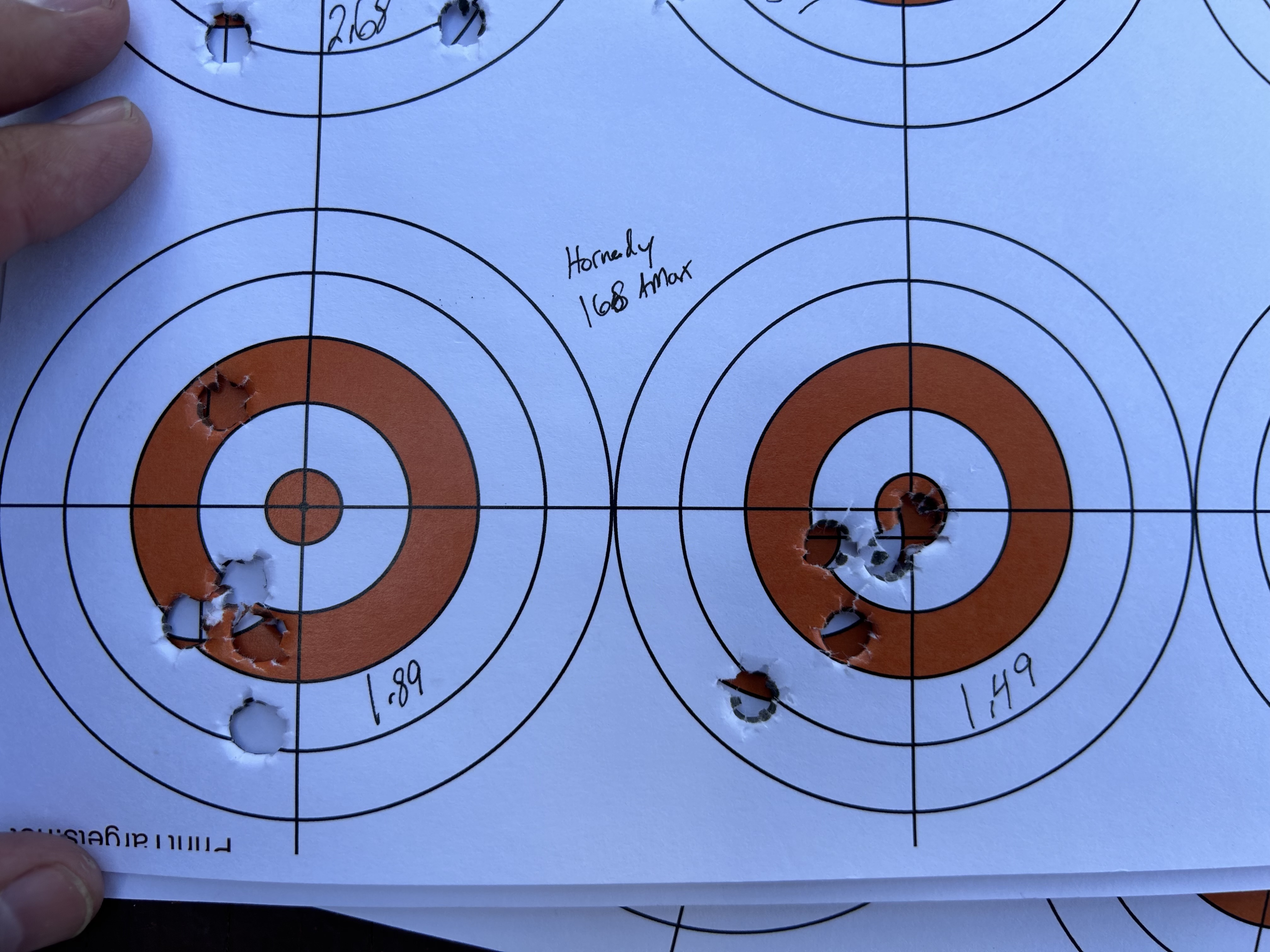

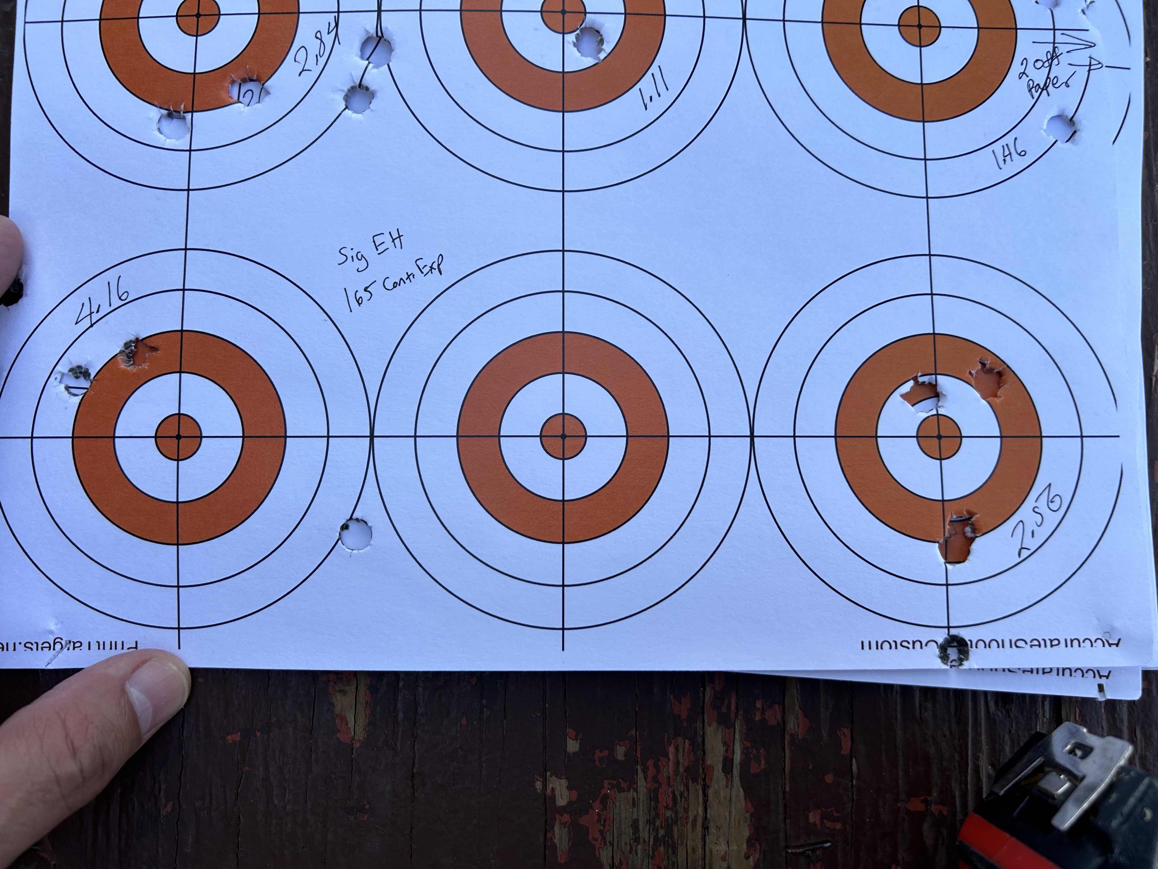

Finally made another trip to the range and took my paper this time. I give up!
Sending it in?
I am. Im 200 rounds deep and shot one group under a minute.
I was thinking about just putting a prefit barrel on it but don’t want to risk something being wrong with the barrel sleeve.
Yep, send that one back.
good luck
Besides the post listed above about Weatherby, this is the first I have heard of any fee occurring for sending a firearm back for warranty. It’s not like you are sending it in and it’s a wear and tear or abuse type of thing. Both myself and other people I know have sent in firearms for issues and they were checked, sometimes fixed, and sent back with no fee occurring. Most of the time they covered shipping as well. Some of these companies are Ruger, Savage, Browning, CZ, & Taurus. People saying this kinda makes me want to stay away from Sig & Weatherby.

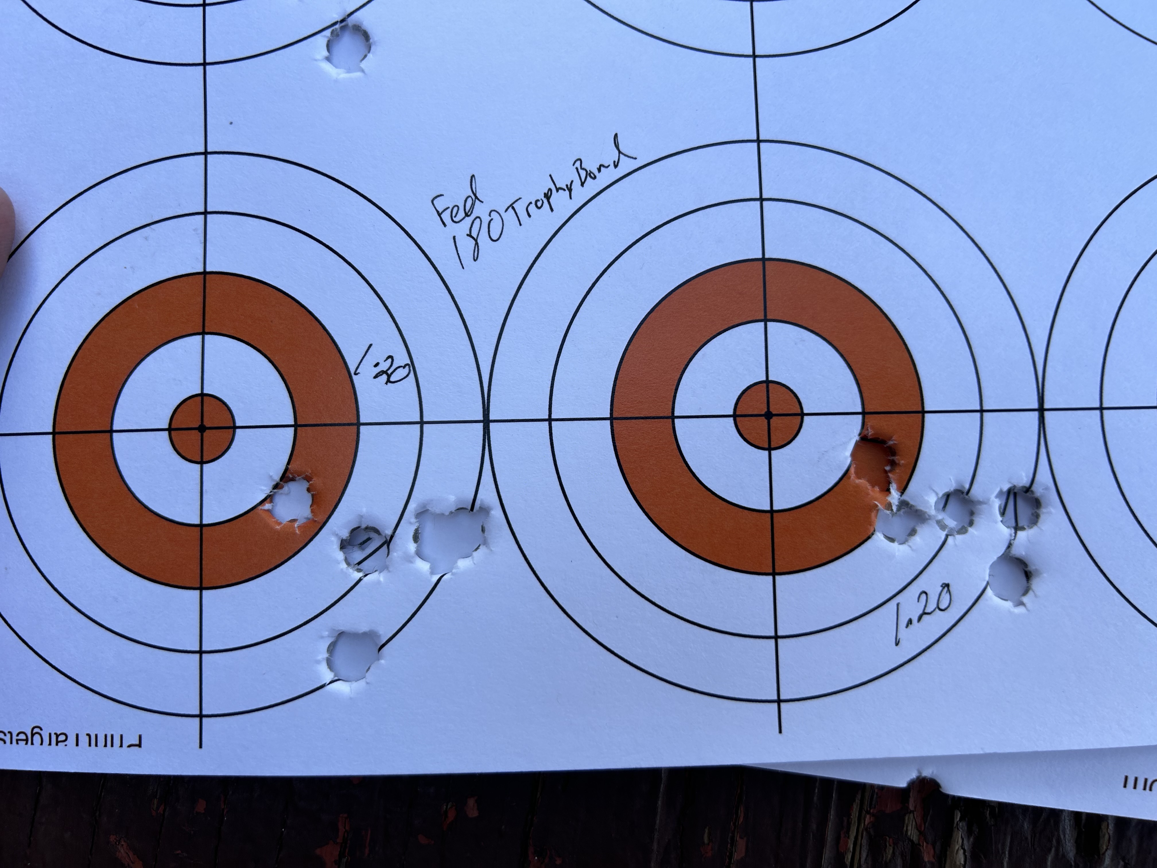

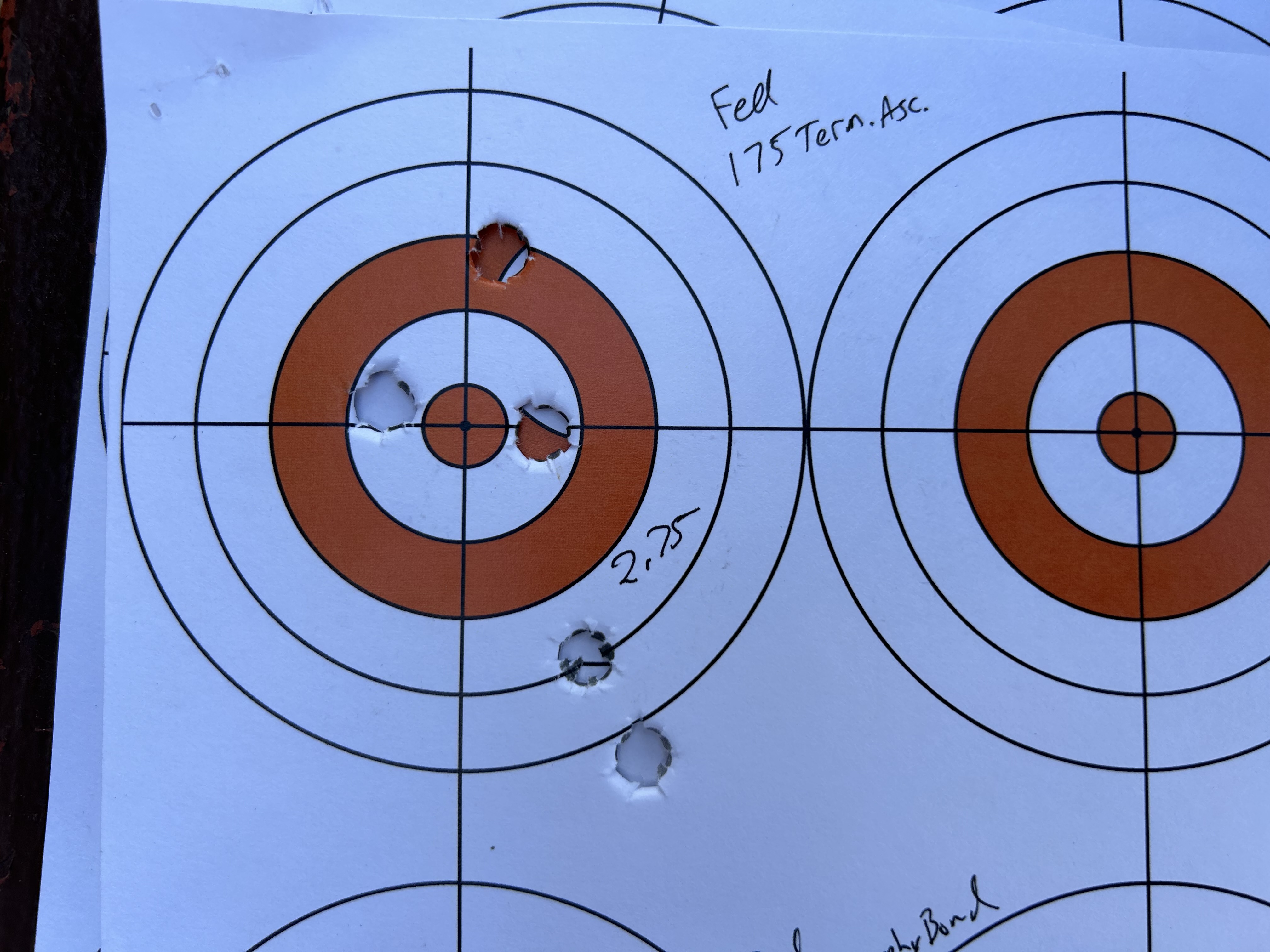

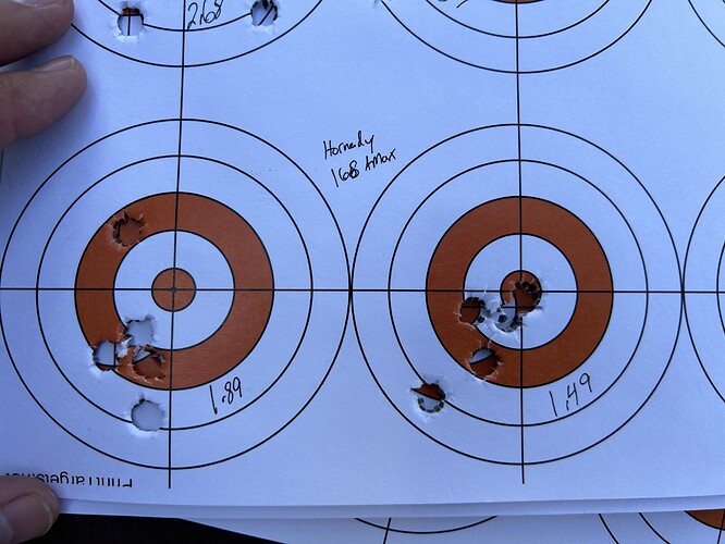

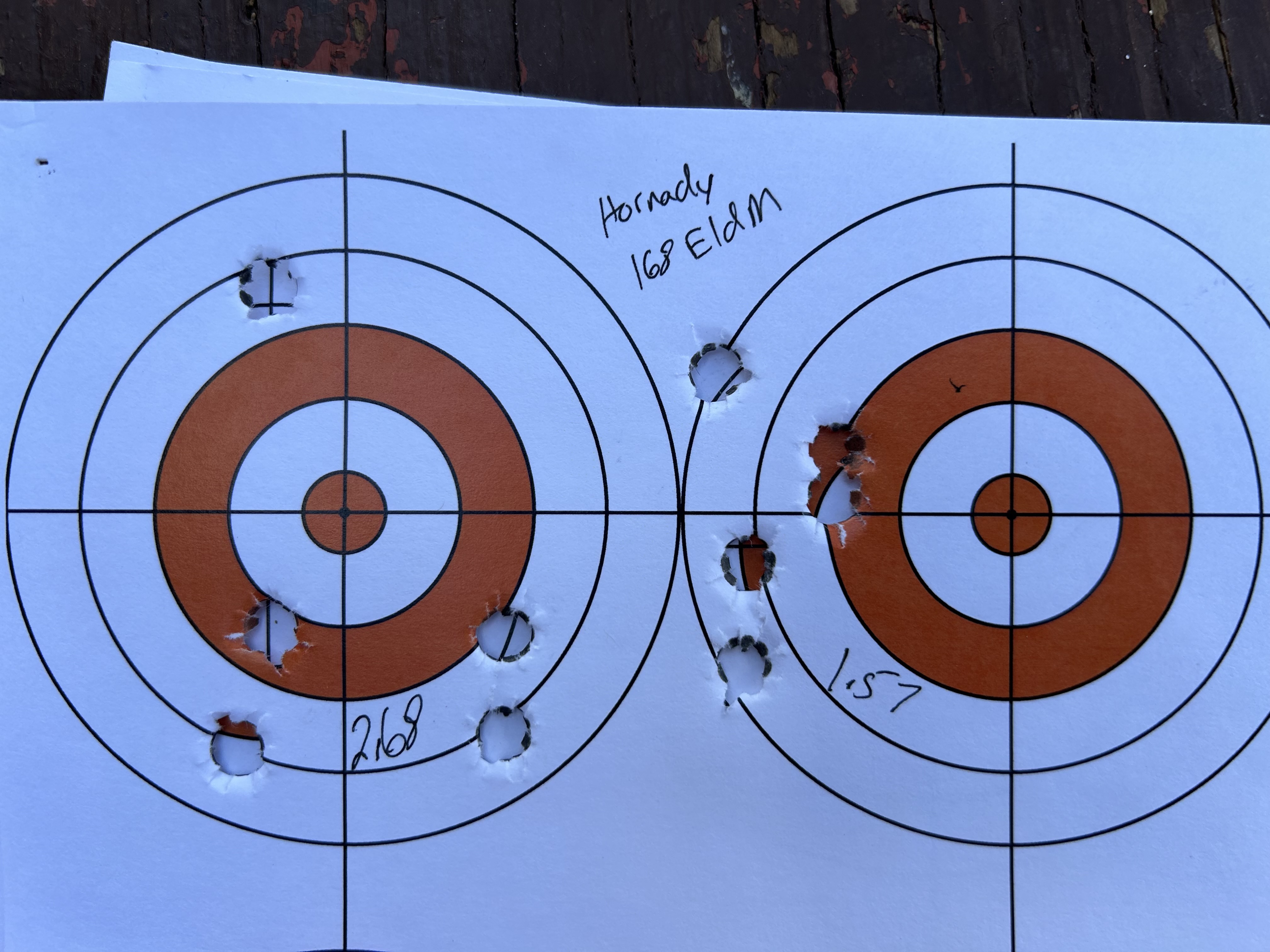

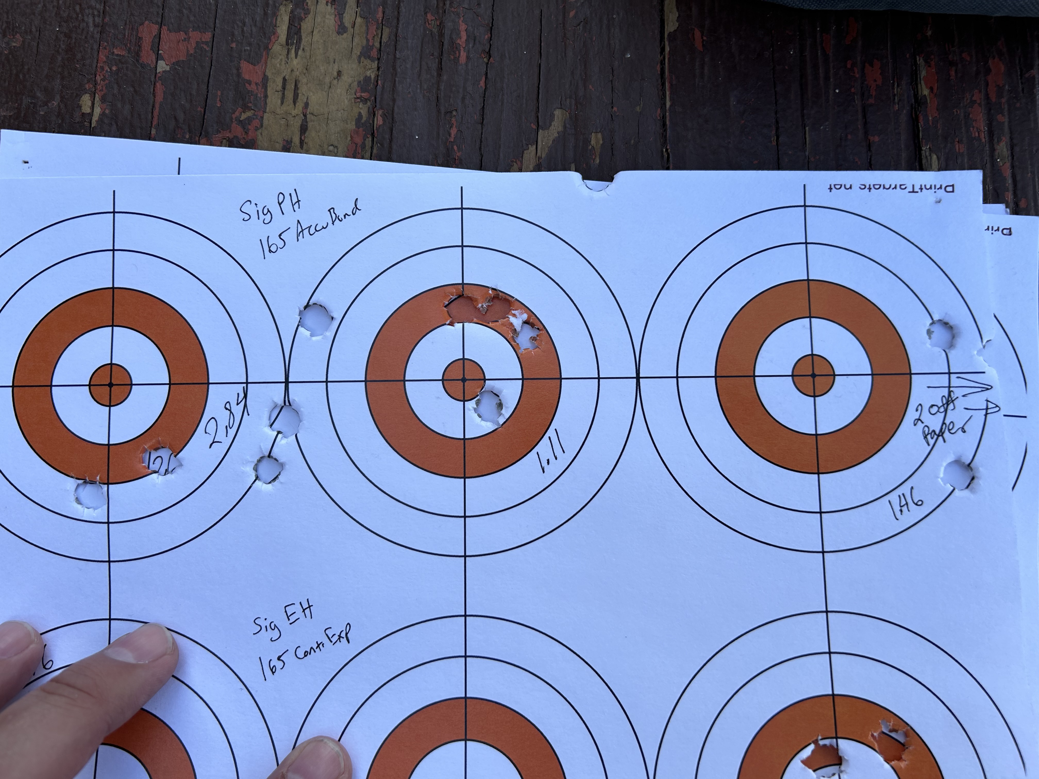

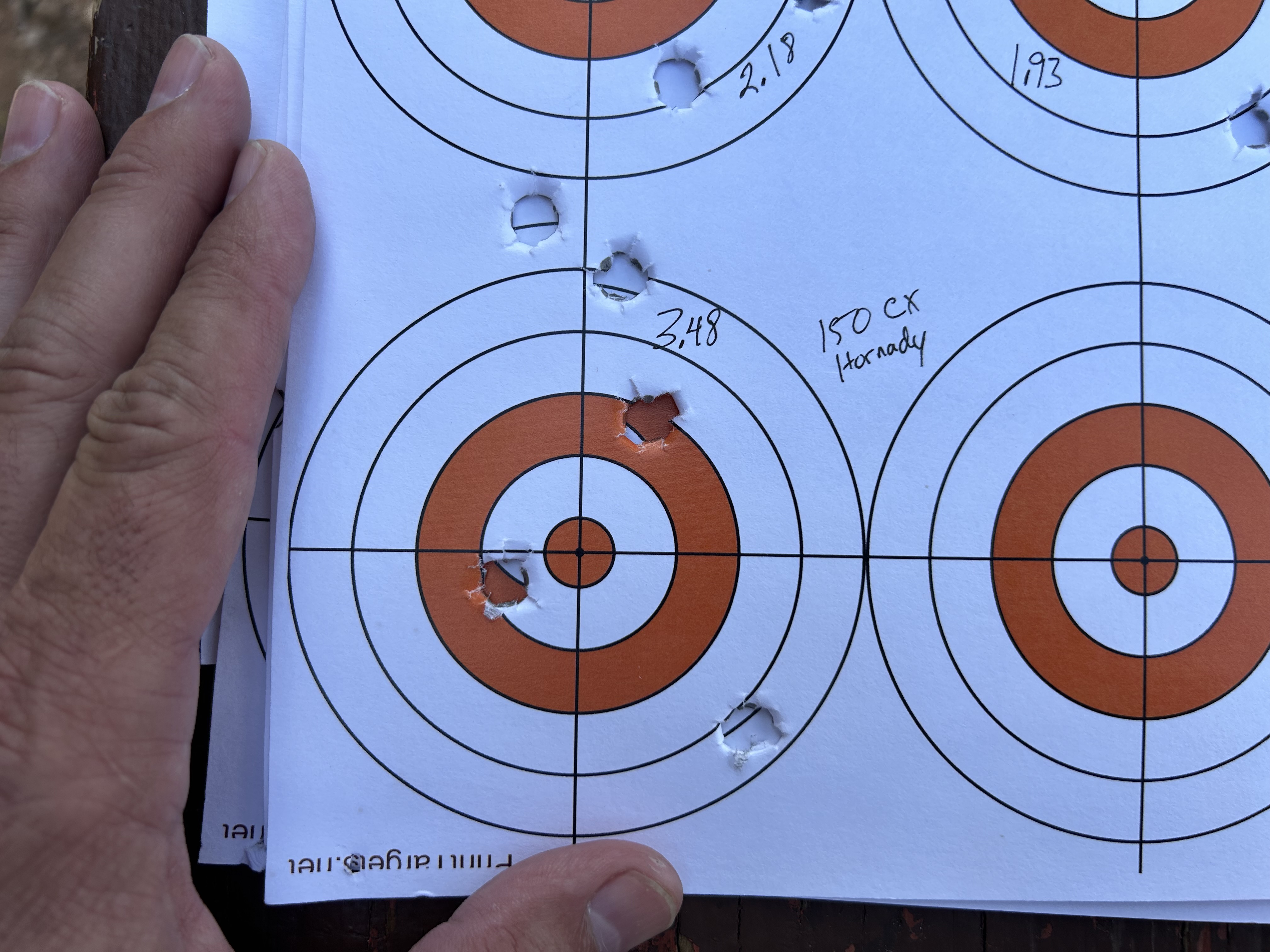

I’m not happy about it but I’m certain there is something wrong so I won’t be charged. Nothing shot better that 1.15. A couple loads were close to 4”. And I know it’s not me because I shot a .26 group right before switching guns.
Now if they try to tell me it’s within spec we are gonna get sideways!
