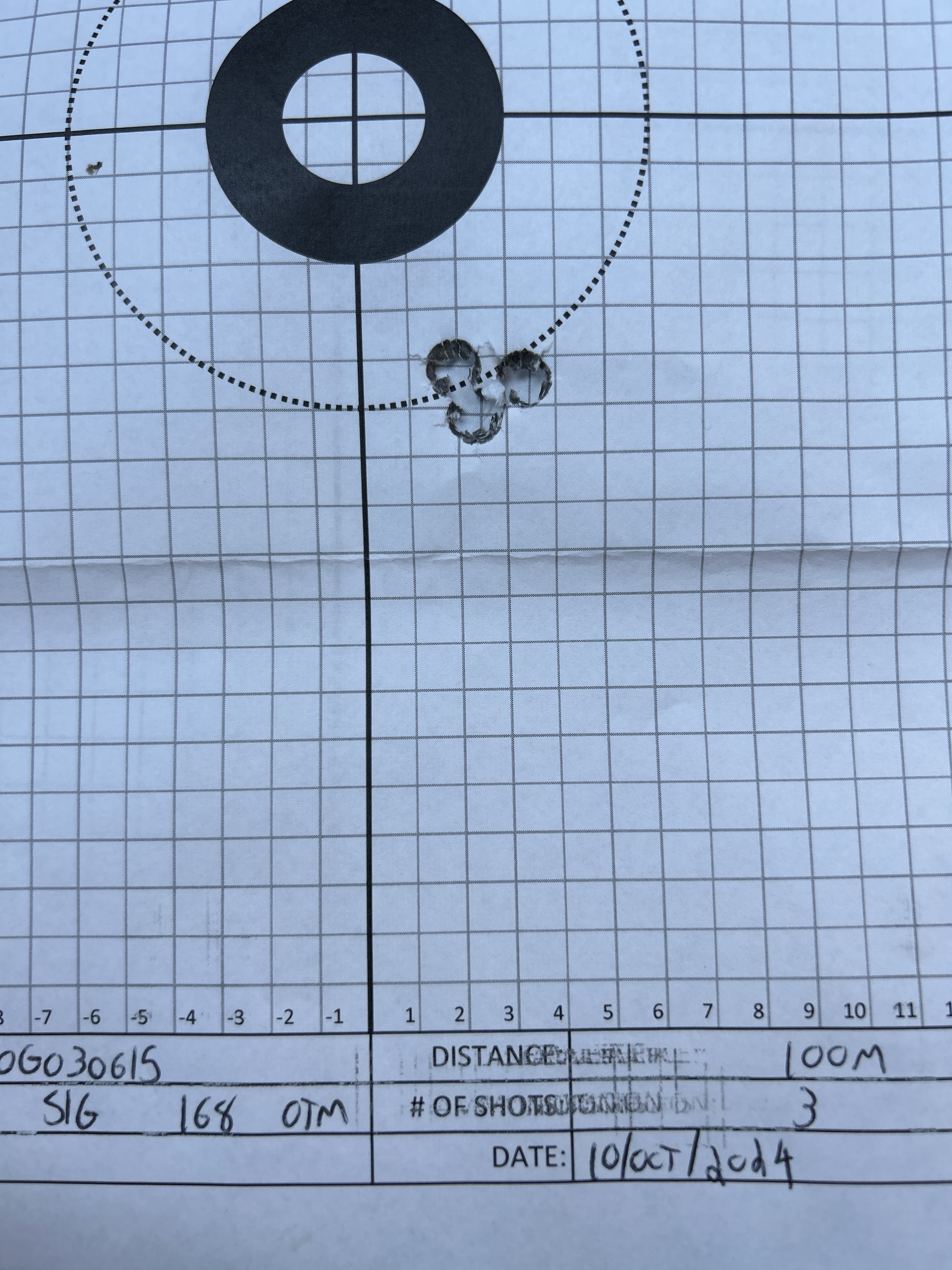

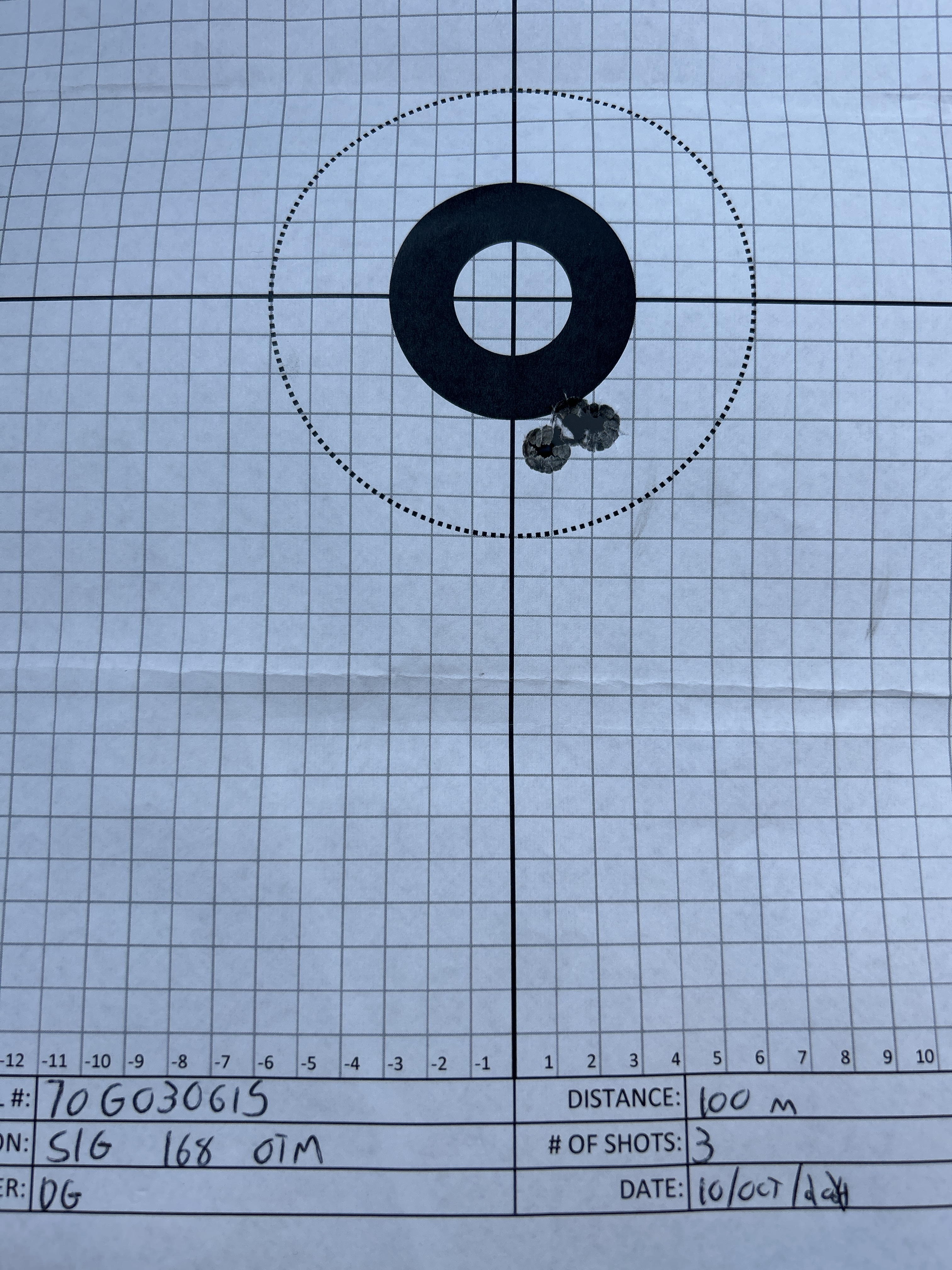

UPDATE:
I got her back today. Here is what I received from Sig.
Firearm Inspection: Complete. Firearm received with excess play in stock hinge.
Work performed:
  • Replaced stock hinge
  • Confirmed accuracy (pass)
    Tested: Firearm passed testing and fired without malfunctions
    Ammo fired: SIG 168 gr OTM
I find it hard to believe that a butt hinge was the cause of my accuracy issues but they included targets and the ammo used. At least I’ll have a way to duplicate their test.
